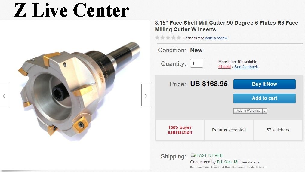

October 7, 20197 yr comment_204258 I'm now building my second router sled. My first sled fits on my band saw mill. It uses the track and the head of the saw for power movement. The one I'm building now will be 12 ft. long and 8 ft. wide. The first picture is the bit for my smaller sled. Second picture is what I'll using for my second sled. Report
October 12, 20197 yr Author comment_204811 I'm thinking the second one(what brand is it?) won't be in my less than $100 price point. Would love to see a picture of your sled setup. Thanks for your input. Report

October 13, 20197 yr comment_205109 4 hours ago, Pat Meeuwissen said: Thanks Kevin, who makes the second bit? It's a Z Live Center. Report
