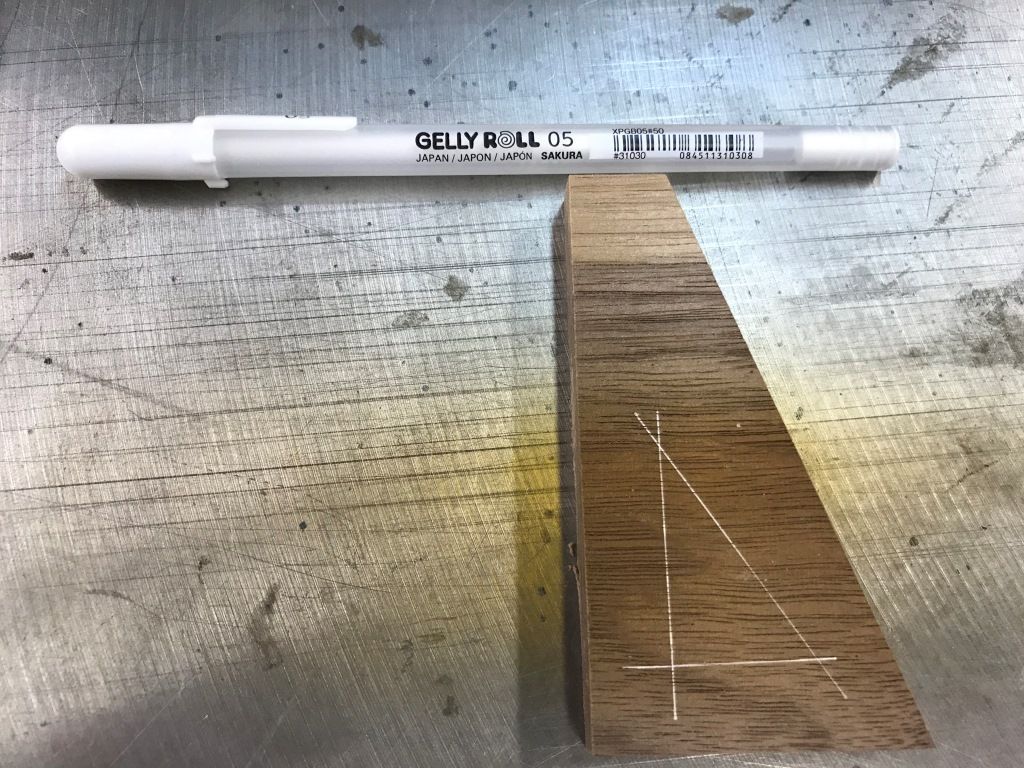

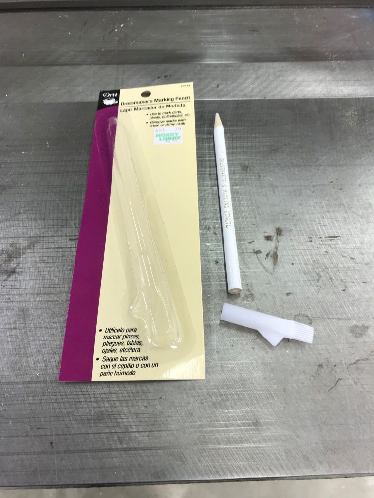

I went to Hobby Lobby and purchased the pencil shown below.  I did not like the results.  The line produced was wide, required a lot of pressure to apply, and was hard to see.
Then I went to Michael's and purchased the pen shown.  You have to move the pen at a slower rate when what you do with a lead pencil, but it gives a visible 0.5 mil line.  to remove the line does take move effort than what the white dressmaker pencil requires.  I think the Gelly Roll pen will be what I will be using.  Thanks for your input.   Danl

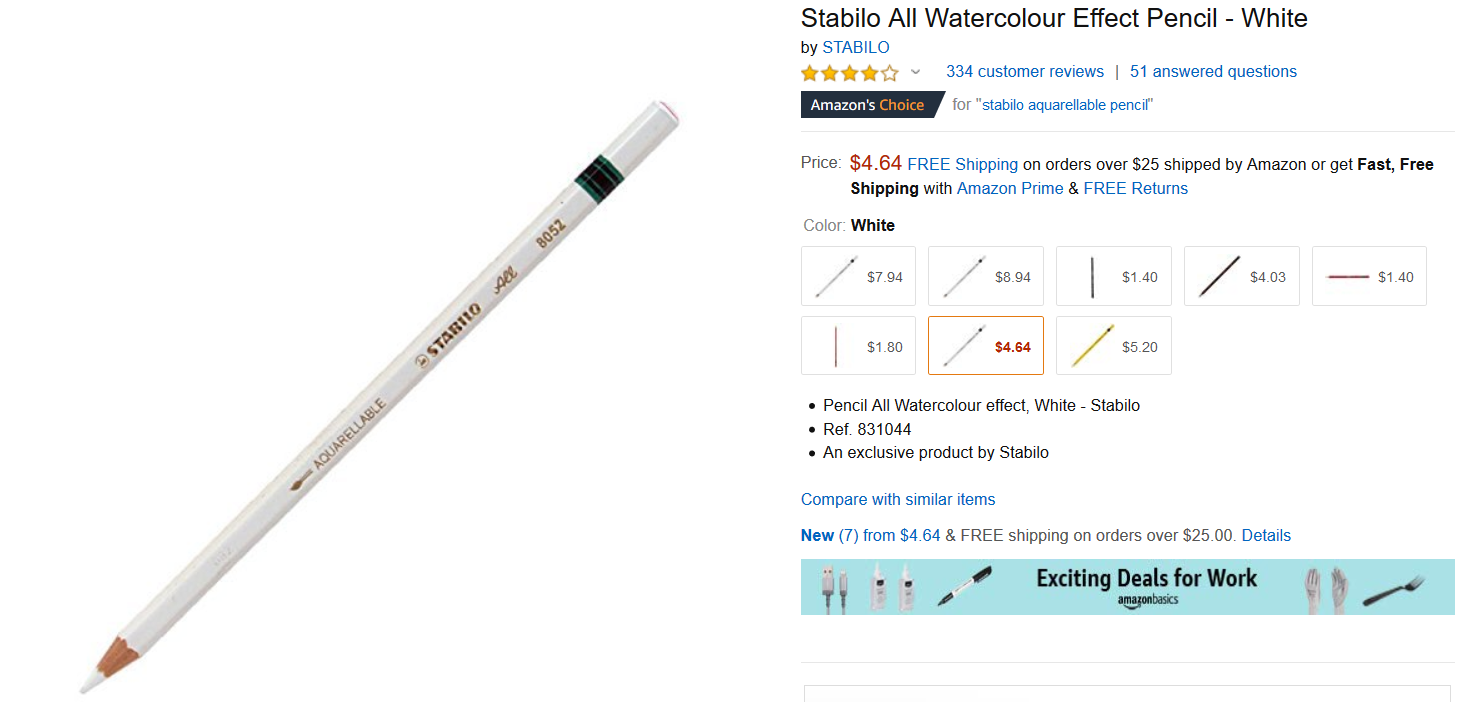

The following pencil was recommended by Woodmagazine in a back issue.  Danl
