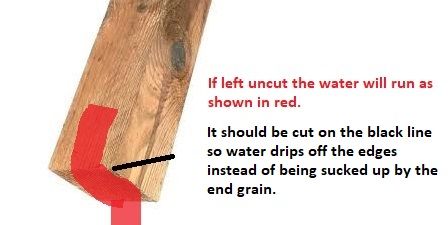

I have to agree with Cal.  I don't have a good visual from the description and a picture would do wonders.  If the post is not cut to form the pyramid the water will run down the post and across the end grain and then sucked up into the post causing the rot.

Thanks for these thoughts so far.  I gravitate toward condensation myself, though end grain on the bottom sucking up water make a whole lot of sense.
