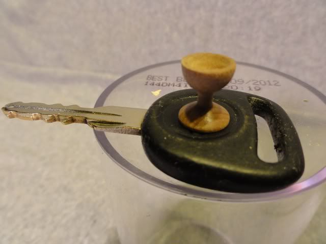

There are different sizes of jaws that can get you to a pretty small bowl in expansion mode.  I have turned some things that no chuck could be used in either fashion to hold them.
