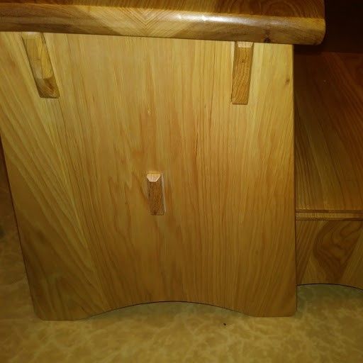

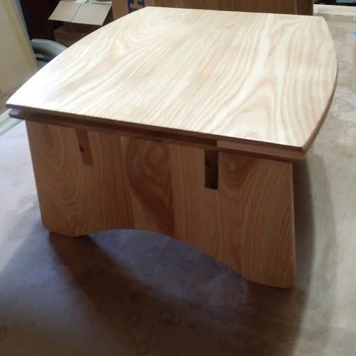

July 21, 20197 yr Author Popular Post comment_196593 As promised, I finally finished the hickory stool I was working on, and here are some pictures. Obviously has a slide out step, here opened and closed. My phone changed the lighting on the above pictures. The one on the left is more accurate for color. The stool has a stop system to prevent the lower step from pushing in too far or pulling out too far. Here are the pegs that catch those stops. And the front stops. This is the groove in the back of the bottom step that holds the rear stop. The stop has not been installed at this point. This is the stop, laying on top of the step, ready to be installed. No glue, just a couple of screws in case I need to partially disassemble the stool for some reason. Here, the bottom step has been slid into the dadoes in the sides of the base, and the back step installed. The stool is upside down in this photo. The stool is finished with 5 coats of wipe-on poly, except for the tops of the steps. There, I stopped at 3 coats, and applied two coats of brush on full strength poly. Now, time to clean house. Report
July 21, 20197 yr comment_196594 7 minutes ago, PostalTom said: in case I need to partially disassemble the stool for some reason I use same method, because ya never know..... Looks great, the attention to details like a stop both in and out is excellent. A well thought through quality build. NICE!!! Report

July 22, 20197 yr Author comment_196694 19 hours ago, Gerald said: Tom that is a really nice job . I like that design . Did you draw it up? No Gerald, sad to say, I am not that talented. The plans came from Woodsmith magazine #111, June 1997. The only change I made to the plans shows in the picture below. The tenons on the lower step had to be trimmed flush with the sides because there wasn't much room between the outer side of the lower step and the inner side of the base, or upper step. The upper step sides plans called for the same treatment, trimming flush, but I decided to leave them proud of the sides and chamfer the edges, just for visual effect. Well, the whole picture didn't show, but you get the idea. Report
