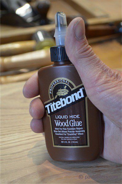

I also found a nice article by Paul Sellers on Titebond Hide Glue.
DSC_0555.jpg?fit=398%2C600&ssl=1
PAULSELLERS.COM
When I visited Highland Hardware last month I picked up several things I wanted to test out and one of them was a bottle of the...
