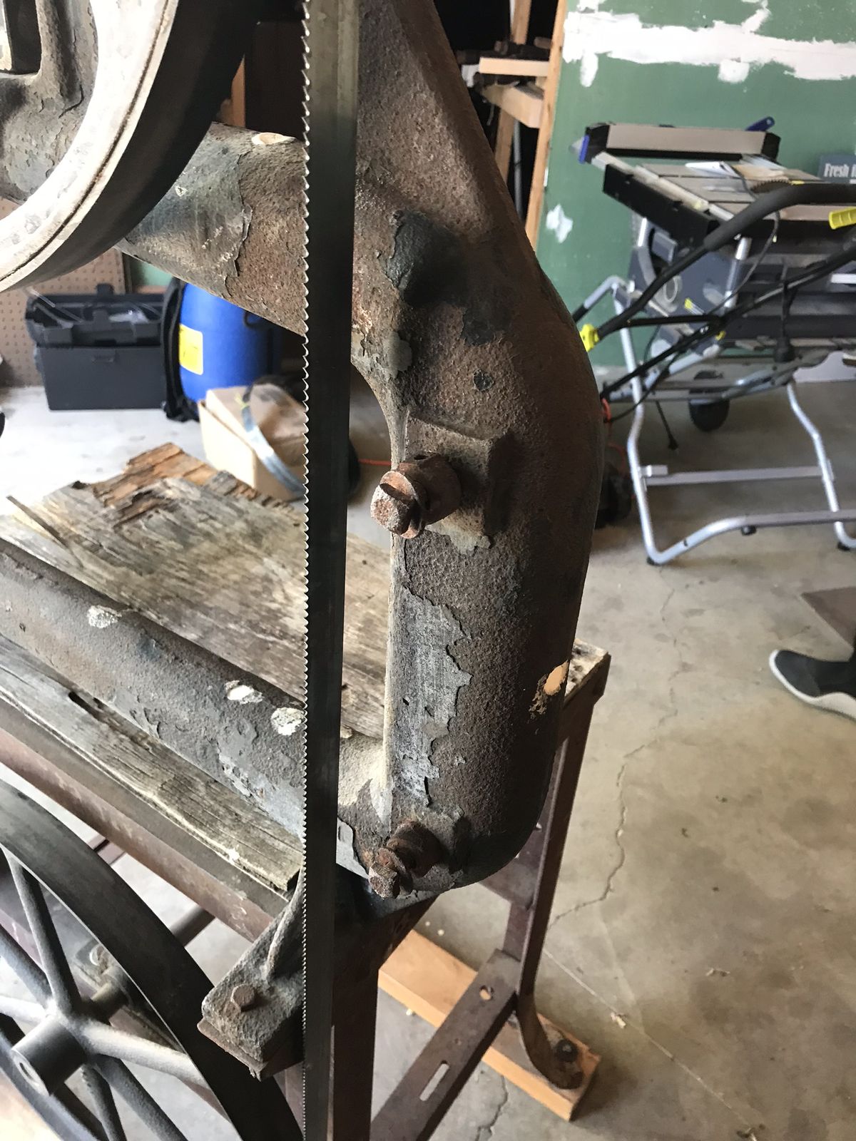

June 3, 20197 yr Author comment_192378 Does anyone know what these bolts were used for? Original? Report
June 3, 20197 yr Author comment_192379 Also, is it ok to sandblast the cast iron? Will it weaken it? Report
June 14, 20197 yr comment_193477 Hi Chris, Sorry for the late reply, sandblasting is ok but there is another way that will also clean the insides, loosen bolts etc. Report
July 2, 20197 yr comment_194939 Thats a left hander. Should finish up nicely as it appears to be all there. Those bolts may have been for some kind of guard for the blade. Not many things concern me about the safety of old equipment but an ungaurded band saw blade is one of them Report
July 3, 20197 yr comment_194980 All that, and only $75... reading the description made me realize how little bandsaw technology has changed, it could be describing my Grizzly. You might have a later model machine (than 1927); your frame is different and has the bolts for a blade guard (we think). Report
July 3, 20197 yr comment_194990 Those bolts look to be a bit hefty for a blade guard. Nevertheless, it's a good idea to use them for that. Report
July 4, 20197 yr comment_195050 23 hours ago, Gene Howe said: Those bolts look to be a bit hefty for a blade guard. Nevertheless, it's a good idea to use them for that. Considering the age of the machine, I would not say hefty for a blade guard at all. The guard would not have been thin tin or plastic like today's machines - it would have been overbuilt to do the task for which it was designed. Compare a 1930's car with anything built today. Edit, looked over the catalog that Larry linked to and found this page offering the blade guards. Edited July 4, 20197 yr by Cal Report
July 4, 20197 yr comment_195088 You're right Cal. A steel, upper and lower guard like those you posted, would need hefty attatchments. Report

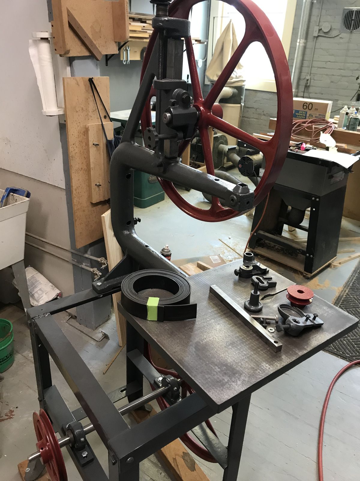

September 1, 20197 yr Author comment_200409 Hi guys. I have to let go of the bandsaw. I sandblasted and primed and painted it. Cleaned up parts and the table. Also comes with a 5 hp single phase motor. I will accept a fair, honest offer. I live in Holland, Michigan. Chris. Report
