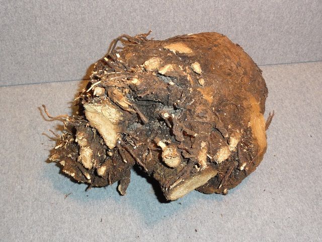

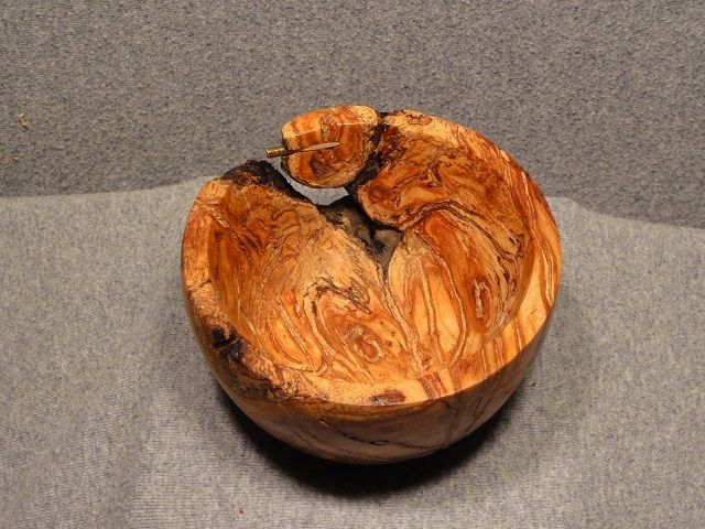

HandyDan Posted May 21, 2019 Report Posted May 21, 2019 I gave it a shot a few years ago. Be prepared for lots of tool sharpening. I went through a few design changes and had to get creative too. The bowl ended up a lot smaller than I had envisioned. It is definitely an adventure. Cal, Gerald and FlGatorwood 3 Quote
Bob Hodge Posted May 21, 2019 Author Report Posted May 21, 2019 Dan, thanks for the photos. Only a true woodworker could see a bowl in that root ball that you started with. What kind of wood is it? I once did something with the root ball of a yew bush. I had read about yew, but didn't know at the time that are yew trees, not just yew bushes. I dried it out with the polyglycol that displaces water. That worked well, except it was then full of water based wax which would not take a finish. I did find a dark purple streak through it that was unique. So, I am presently working on my walnut stump - two feet above ground and two feet of root. Both are very wet. The root wood is wetter and seems to be much darker brown. So far, I have roughed out three bowls and one vessel, and have two 30 gallon bags full of shavings. Oh, and I had to learn how to get walnut stains off my blackened hands (lemon juice and salt, just so you know). And, I will go see my friendly chain saw sharpening friend tomorrow. Cal, HandyDan and FlGatorwood 3 Quote
HandyDan Posted May 21, 2019 Report Posted May 21, 2019 The root ball was from a Weeping Cherry ornamental tree. It sat under roof on my back patio for a couple years and was quite dry when I turned it. I had some Moss False Cypress bushes in my back yard when I bought the house. They were left to grow wild and some were over 8" tall. They have the short prickly needles and I hated to mow by them. I cut them down and burned most of them. Saved a couple pieces and turned this box and found some nice color in it. Now I wish I had saved more. Amazing what is inside some of these trees. Cal, lew, FlGatorwood and 1 other 4 Quote
