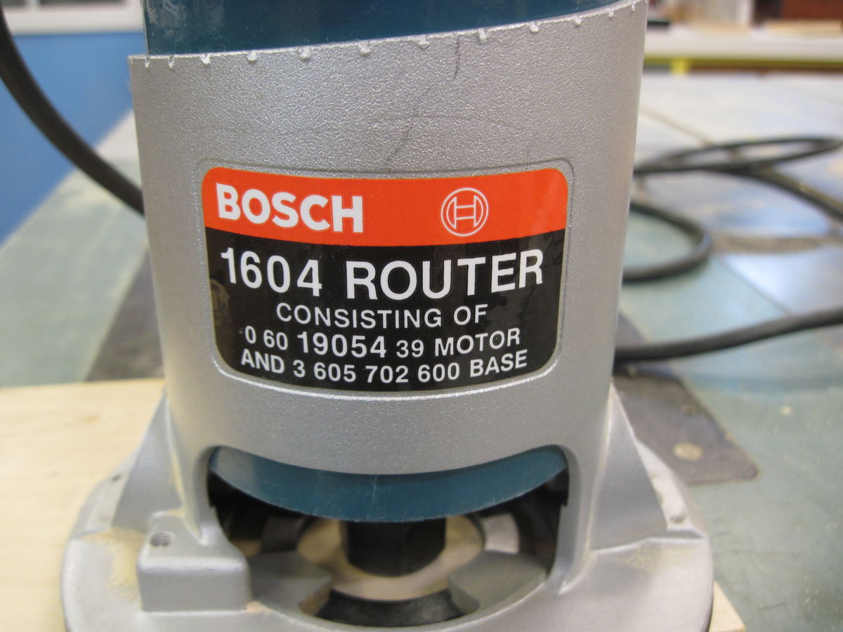

HARO50 Posted April 23, 2019 Report Posted April 23, 2019 About a week ago I was building a set of stairs for my son's new place, when the old Craftsman router started to shake badly. I drove home and got the Triton from my router table, which fortunately is equipped with the same Lee Valley base, so it would work in the jig. It ALSO vibrated, so I exchanged the 1/4" shank bit for a 1/2" one. WHAT A DIFFERENCE! Later that night I dismantled the Craftsman and found that a wood chip had been sucked up into the fan, bending it badly and breaking off two of the blades. The vibration resulted in a crack across the 1/4" bit shaft, creating the problem with the Triton. The Craftsman has served me well... I've had it for well over 40 years! However, after hearing of many problems with the newer ones, I won't be buying another one. A small Bosch may be in my future. Not the clearest picture, but can you make out the two bottom lines? THOSE WERE THE DAYS! John Dadio, Artie, Gunny and 1 other 4 Quote
