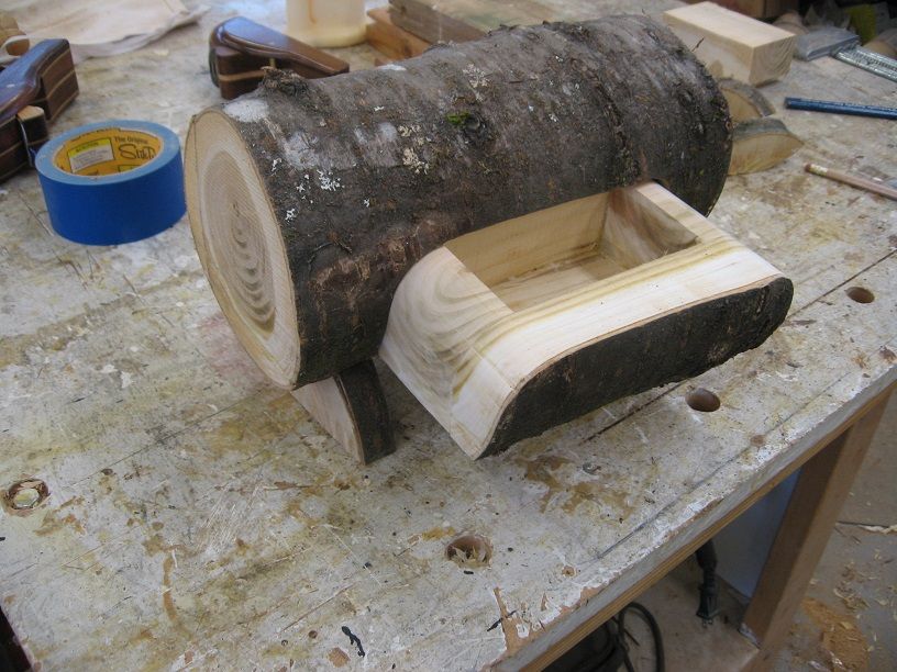

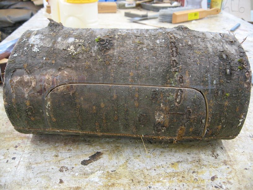

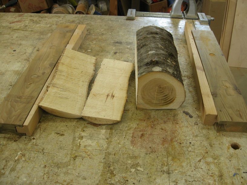

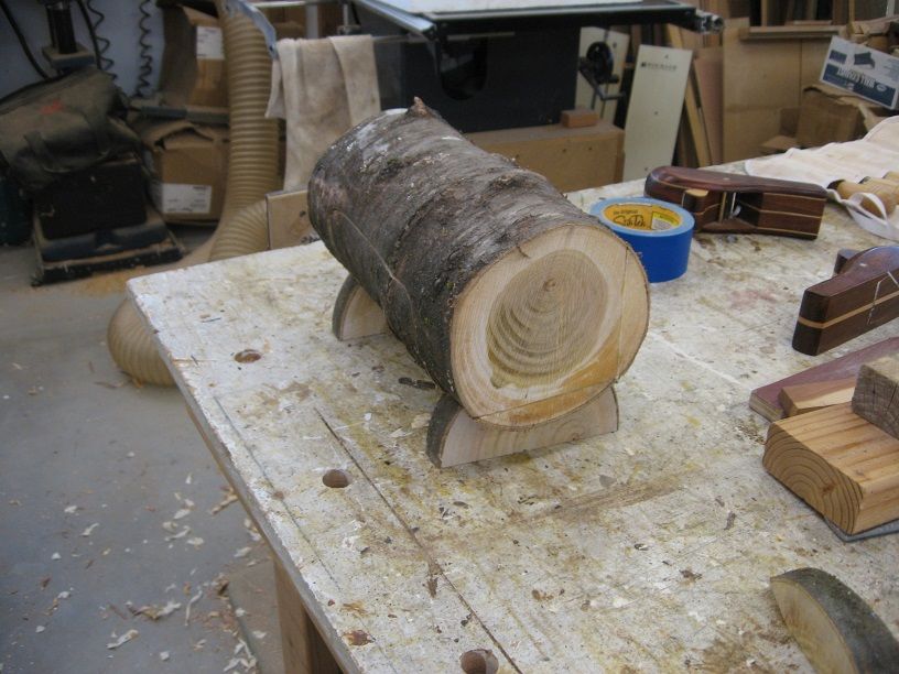

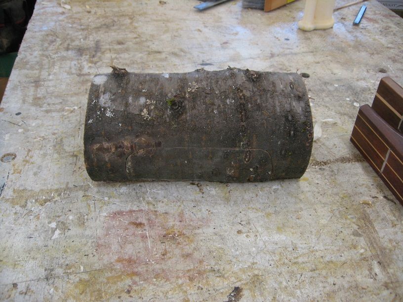

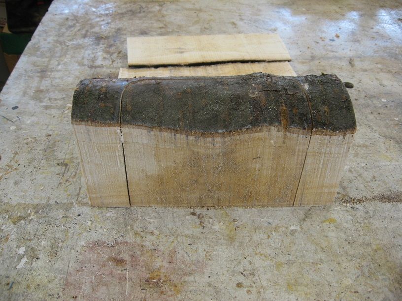

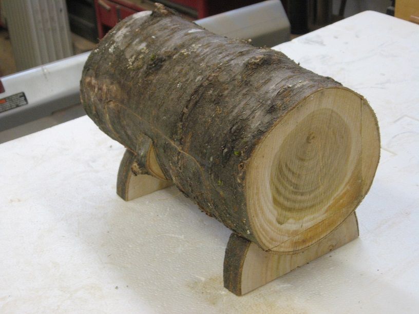

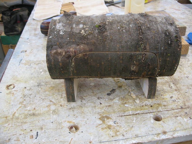

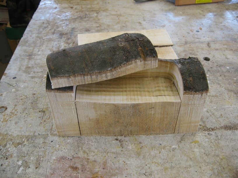

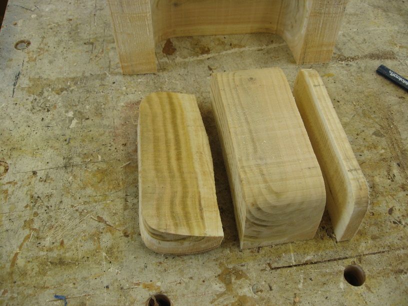

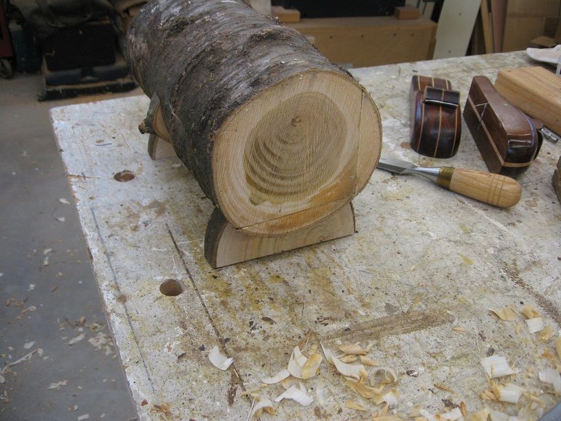

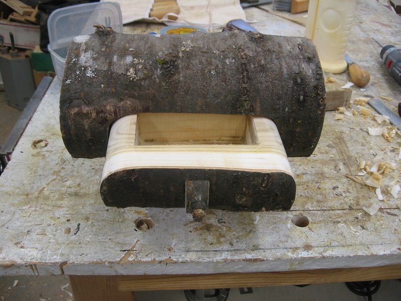

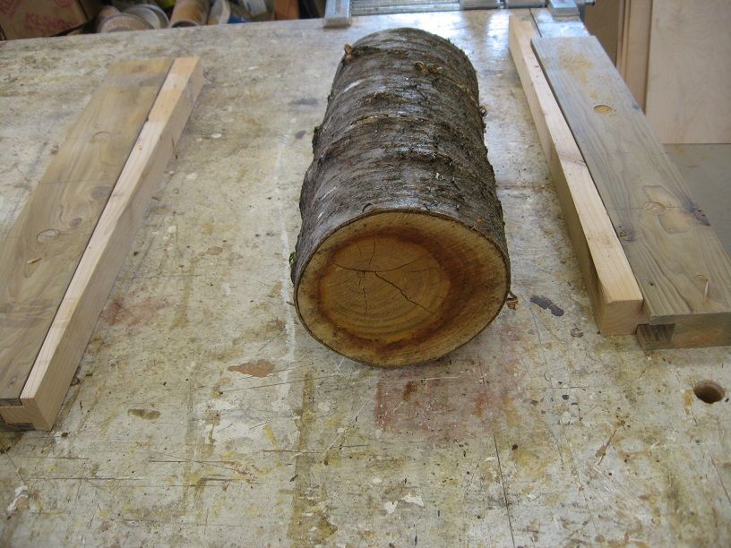

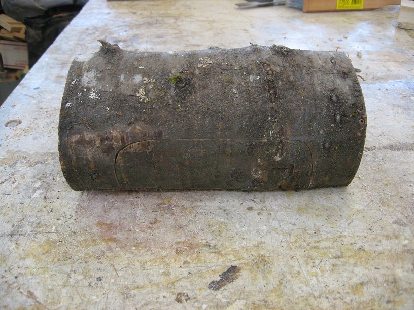

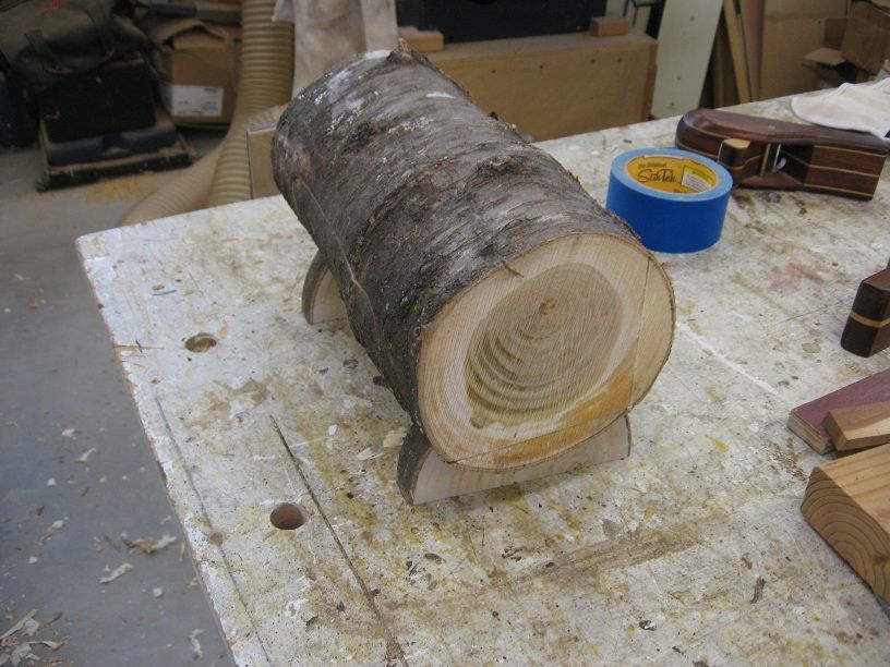

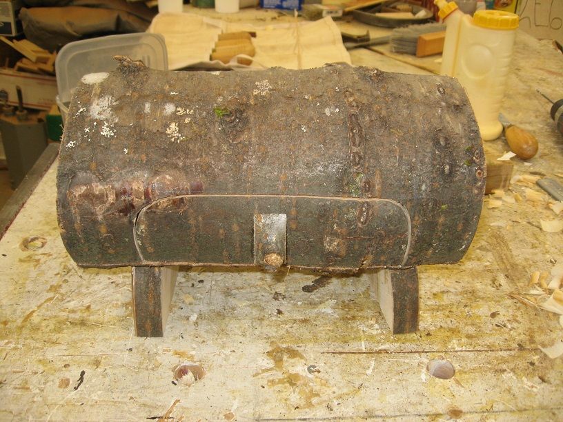

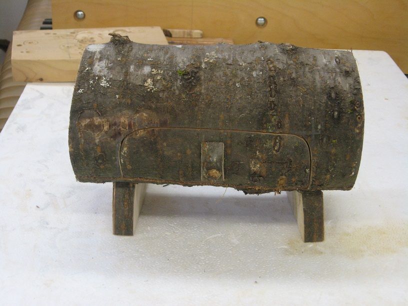

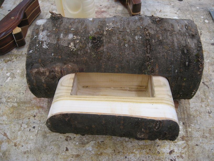

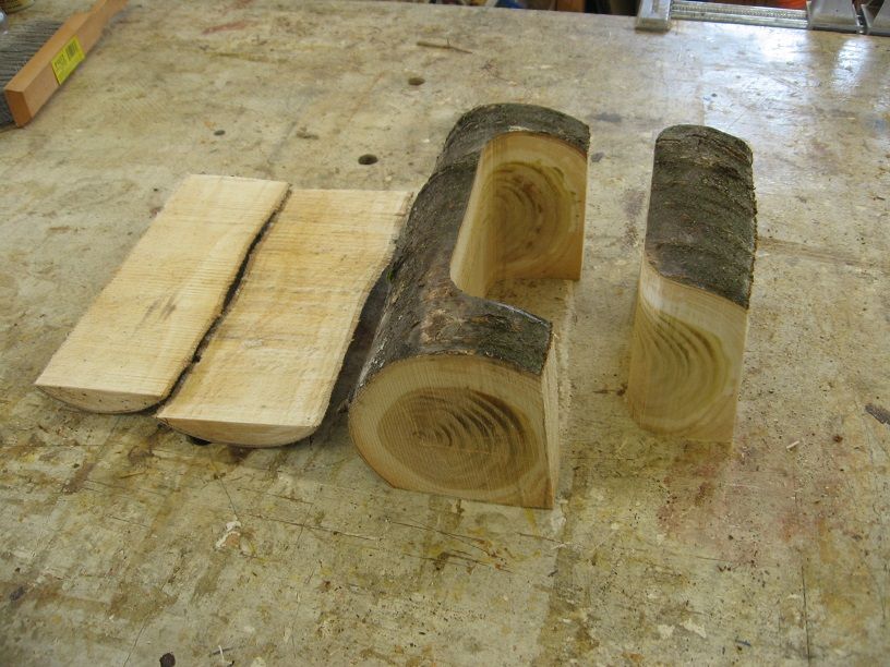

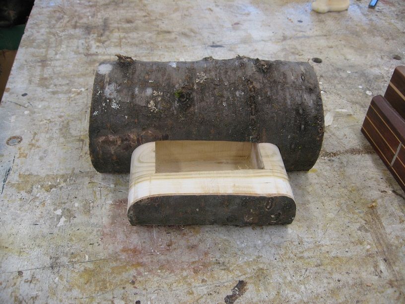

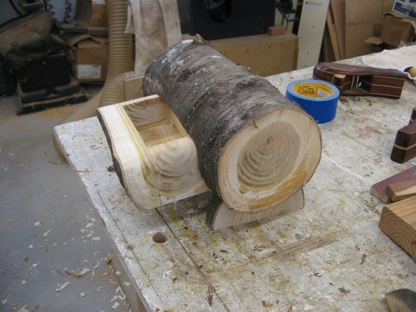

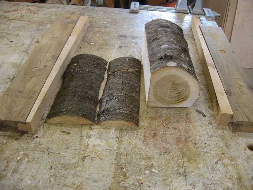

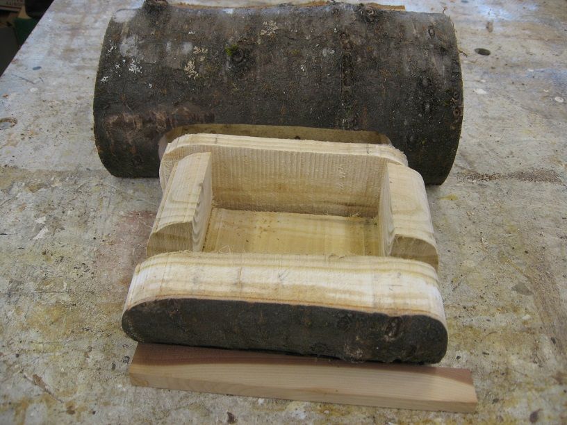

April 23, 20197 yr Popular Post comment_188573 Today I made a band saw box out of a piece of domestic cherry fire wood. Herb Report
April 23, 20197 yr Popular Post comment_188575 Herb that is a great tutorial . Now I have a question from my turning experience I know the log was not dry, so as the wood and especially the drawer dry . How does that affect the integrity of the piece ? Report
April 23, 20197 yr Author comment_188586 55 minutes ago, Gerald said: Herb that is a great tutorial . Now I have a question from my turning experience I know the log was not dry, so as the wood and especially the drawer dry . How does that affect the integrity of the piece ? HAHAHAHA, I just knew you were going to ask that, Gerald. You are right, I don't know. This was an experiment to see what will happen as it drys out. I soaked it inside and out with shellac to slow down the drying, I have some more blocks waiting, I will paint the ends tomorrow and set them aside. I want to see if the bark comes loose too. Herb Report
April 23, 20197 yr Popular Post comment_188590 44 minutes ago, Dadio said: This was an experiment to see what will happen as it drys out. I soaked it inside and out with shellac to slow down the drying Nice Herb. I like the just dive in and see what happens. I have used the Shellac sealed on wet wood with great success. I hope it works for you too. My project was with thinner log pieces. Report
April 23, 20197 yr Author comment_188591 2 minutes ago, HandyDan said: Nice Herb. I like the just dive in and see what happens. I have used the Shellac sealed on wet wood with great success. I hope it works for you too. My project was with thinner log pieces. That is good to know, thanks for commenting on it. Herb Report
