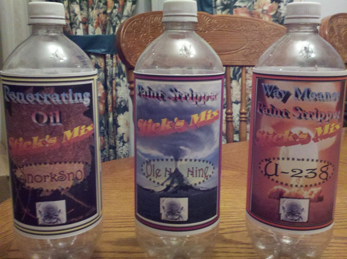

this is all I have on plan ''B''...
Effective Alternatives to - for MEC.pdf
this was plan ''A''...
