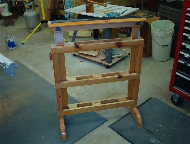

On 4/7/2019 at 6:52 PM, Gerald said:
I made a paddle switch so I can kick it, bump it or otherwise touch in has a finger hole to start.
Gerald, I really like the supports that you built to the left of the TS, are the top darkened areas leather?
HDPE I think these are from Wood plans. The HDPE has the ends slopped and is placed in a groove.
