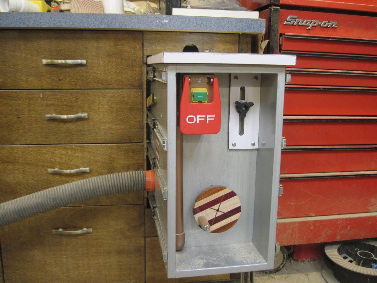

53 minutes ago, Dadio said:
and I was trying to reach the disconnect to shut it down and hold the board from kicking back.
I moved my factory switch from where it was to a location I had used my hip to shut the saw off.  Used large paddle switch for replacement of factory switch.
Liked this feature so much I used this switch on all equipment.
IMG_0624.JPG.c369c6fc661dcc2052642e7b2aaffdb4.JPG   IMG_0786.JPG.3e1c47c1d99f298baa44829ab2a32b25.JPG
I did the same on the TS. Put a paddle switch on it.
Herb
Herb
here too...
hip operated switch...
