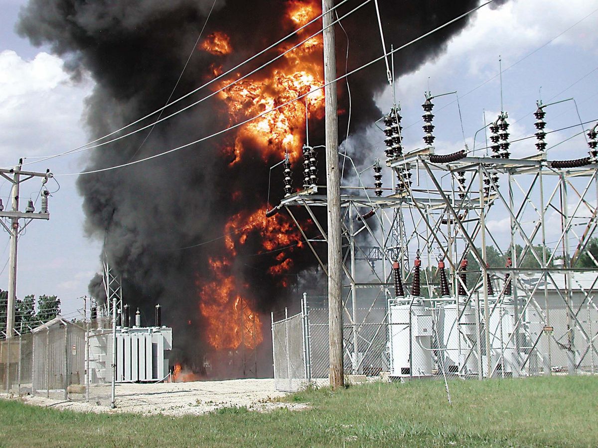

March 23, 20197 yr comment_183663 This was about our biggest electrical fire. Basically a bad connection started a chain of events 138 kv Roly (picture from a local newspaper) Edited March 23, 20197 yr by Roly Report

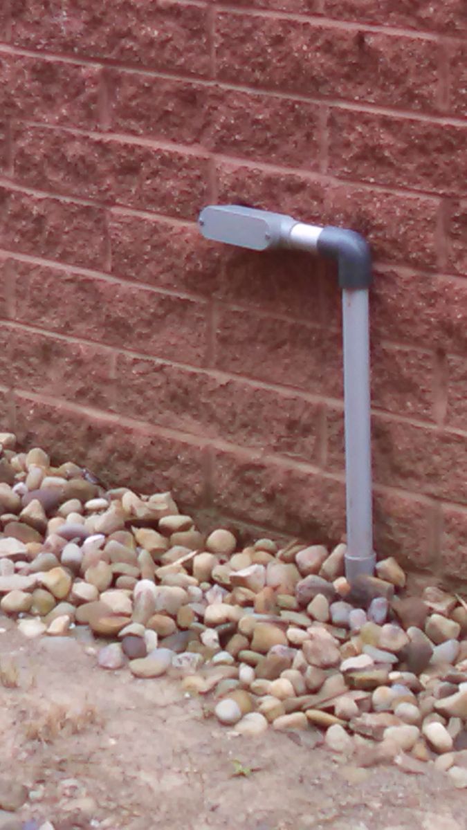

March 24, 20197 yr comment_183805 23 hours ago, smitty10101 said: how much heat & how quickly will a blue plastic box take before it melts? Also the various other colored boxes for low current--- iirc they are almond in color. The is where the word "UL Listed" on the package come into play. You can search a part and find what it is listed or rated for. Plumping couplings will fit PVC conduit but it isn't listed for its use. Edited March 24, 20197 yr by DuckSoup Report
March 24, 20197 yr comment_183886 8 hours ago, DuckSoup said: The is where the word "UL Listed" on the package come into play. You can search a part and find what it is listed or rated for. Plumping couplings will fit PVC conduit but it isn't listed for its use. Ya gotta buy the matching paint and paint those elbows or the inspector is gonna notice fer shur. Report
March 24, 20197 yr comment_183897 1 hour ago, Artie said: Ya gotta buy the matching paint and paint those elbows or the inspector is gonna notice fer shur. Just paint it all same color, match taken care of. Report
