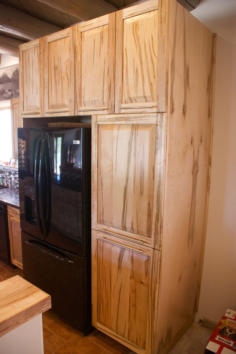

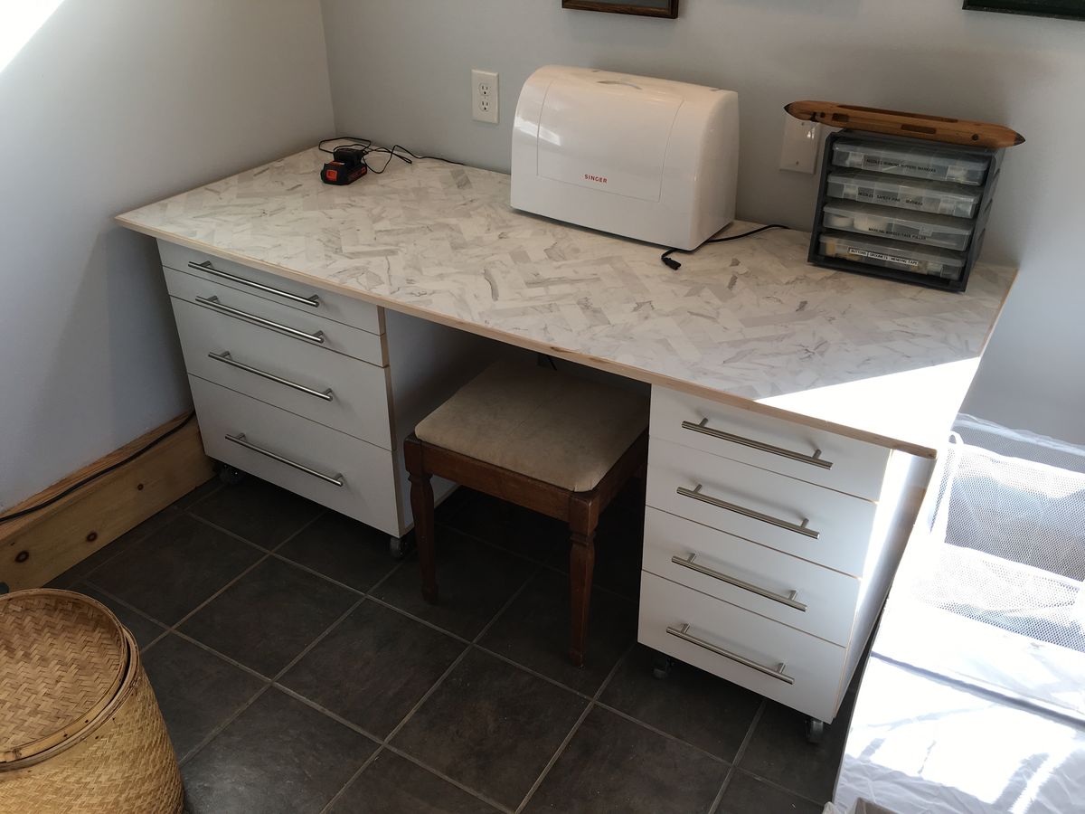

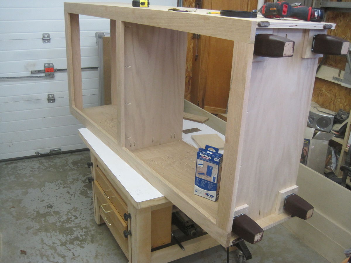

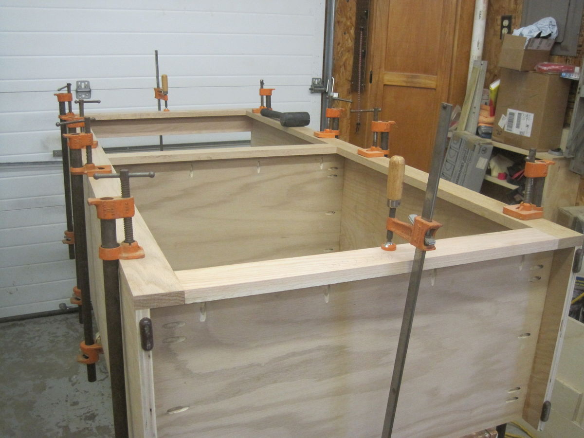

VOE here, think about how much this cabinet is going to weigh once you get it assembled and are trying to move it around while you do all the finishing operations. This one is 36" W x 18"D x 72"H and has been a problem for me trying to pick it up onto the bench, lift it off and then stand it up. Maybe in the old days when I was working in a shop with someone else (or even 20 years younger), but I would make it in two pieces if I had to do it again. While you can probably horse it around to some extent, it gets tricky once you're at the finish sanding stage and need to set it up on the bench for more work.
tall cabinet?
build it in place.
long cabinet, break it into pieces you can join together later.
sewing cabinet, put it on wheels.
these are all 3/4" plywood with pocket screw joinery.

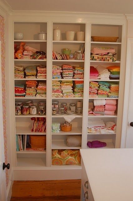

The inside will be cubicles.
along these lines???
69c598d38a6ac7cd38e718ff984f1e68.jpg&f=1
Yes but with solid doors.
