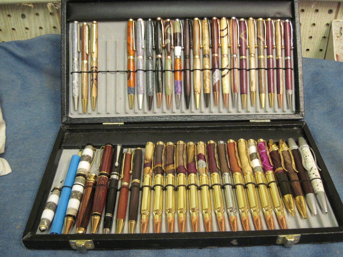

Don't give up on turning with the stuff.  I have tons of Corian sample squares and wasted a few just learning to spin them down without chipping them to death or breaking.  I found it is best to not turn them down to small diameters.  Common use has been white Corian on the ends of fan pulls.  Taught my kids white is light to help them remember the white ended ones were to turn on the fan light.
I know others recommended some great ideas for tooling and that will help.  All the pens in the box I made with a HSS gouge and skew tool.  They do dull quickly messing with this stuff so the carbide tips should be a big help in this regard.
