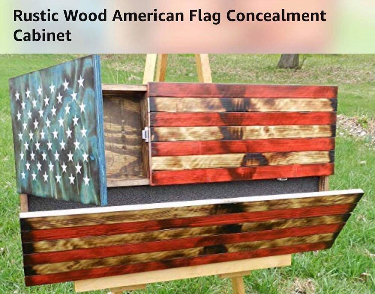

January 5, 20197 yr Author Popular Post comment_172810 I'm wanting to make a concealed flag cabinet. Basically a small shelf where the Union opens, the upper stripes open like cabinets, and the lower stripes drop down like a small shelf. So you can hide valuables and/or weapons, etc. Report

January 12, 20197 yr Popular Post comment_173781 Well, pocket screws would work fine. I’m pretty sure this is what he is wanting to build. Frame could be pocket screwed and the striped sections edge jointed or just taped and painted. The field is just cut from plywood and painted. A nice project. Report
