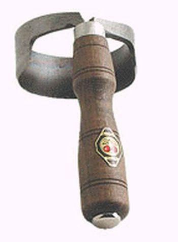

a true scorp (old world)...

Studying the Windsor craft and reading up on it, the specific one I need and want is the Barr scorp as pictured above, hollow ground and dimensioned for tighter forms and specifically for the style of seat I am going to work on. I know it's a little pricey, but it's the go too for chair makers. https://barrtools.com/product/mike-dunbar-style-scorp-516-x-1-14-x-4/
The scorp I have is a general use shave, great at hogging anything out of everything, but lacking in chair seat shaping, when I first tried it on my sculpted rockers, I got frustrated, after reading up on them, I realized it wasn't me, it was the wrong tool for the job.
Since I am new at Windsors Stick, I'd be a little hesitant veering off the beaten path with tools not recommended by other chair makers, once I get a good feel for the art of Windsors, I'll be able to branch out and customize for my own needs in tools and I can fiddle around, and I may purchase one of those you linked me too. But for now, this rookie Windsor guy needs to stay with tried and proven, I don't need more frustrations! :lol:

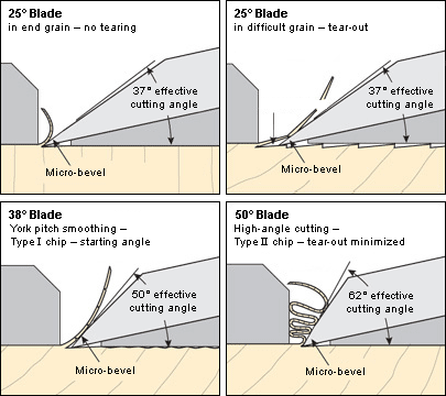

when you are shaping, relate the bevel of the inshave to scrapers, plane angle geometry in bevel or bevel down, chisels and how they cut/shave...
they do come in a myriad of bevel angles, BU, BD and radii..
