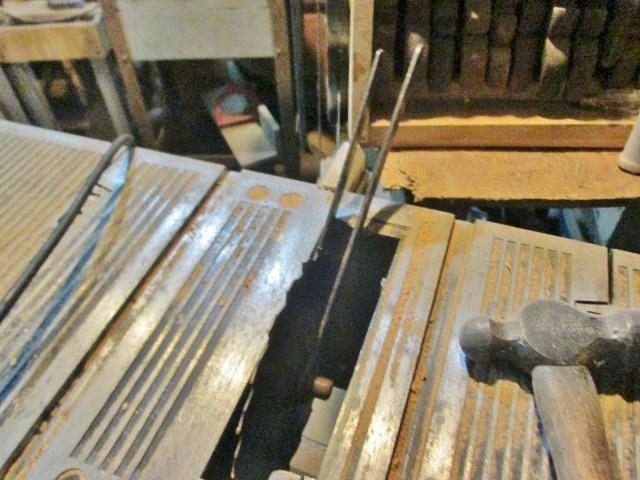

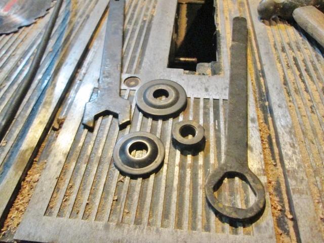

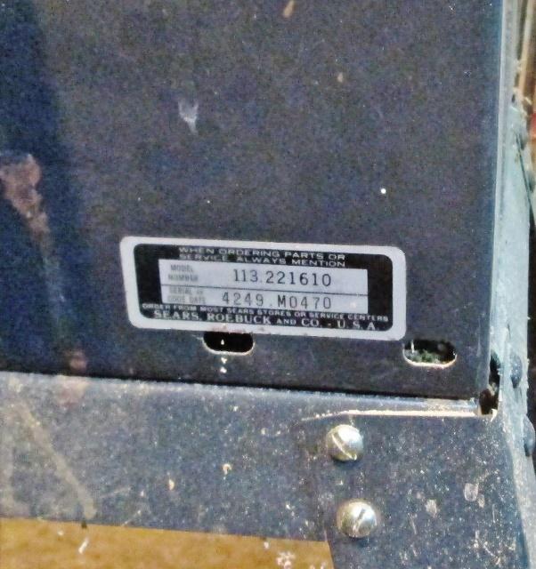

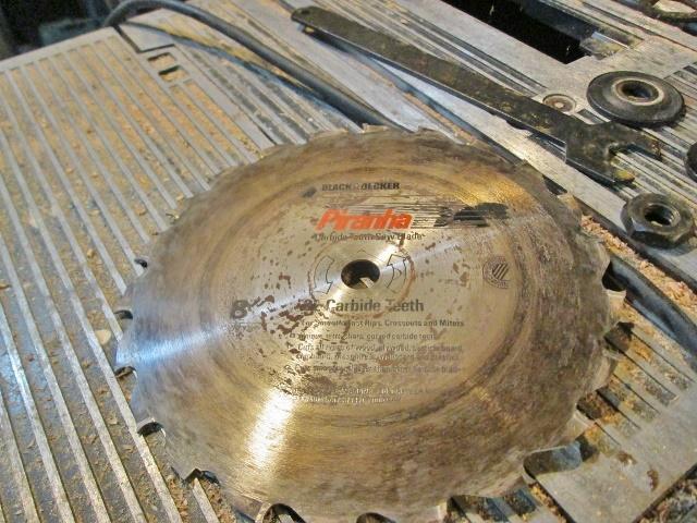

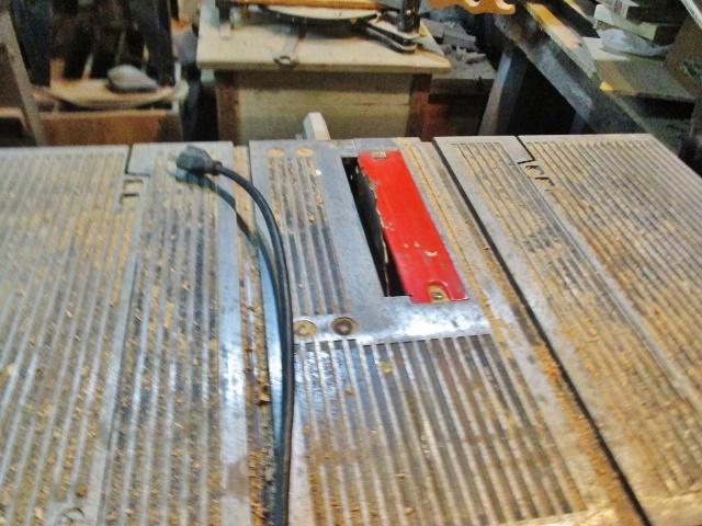

November 6, 20188 yr Author comment_165413 Ok...made me go and tear the saw down....found the data plate..clear around back.. Might help a bit...unplugged the saw.. Need to change out the plug, sometime....Dad removed the ground plug. Phillips screw to remove the red plate... Takes 2 wrenches...was a bit rusty....hammer to loosen things up...then a pry bar between the two to break things free.. There be a washer on both faces of the blade...flatter one is towards the motor side...1" wrench fits the nut,. There is a stop inside, to keep the one wrench from moving too far....box end is for the hex nut. .....5/8" ID nut. Saw blade? 22 tooth, carbide, Piranha....5/8" bore. So...no special bushings needed, might get a DeWalt 8" and call it good...methinks this blade is past it's "prime"? Goo-b-gone on the threads...oil later. Might be able to make some use out of it....fence and the splitter...suck. May be able to build a fence for it...about like my saw guide? Dedicated a couple small c clamps? Zero Clearance Insert? doubtful. How old IS the saw blade? Report
