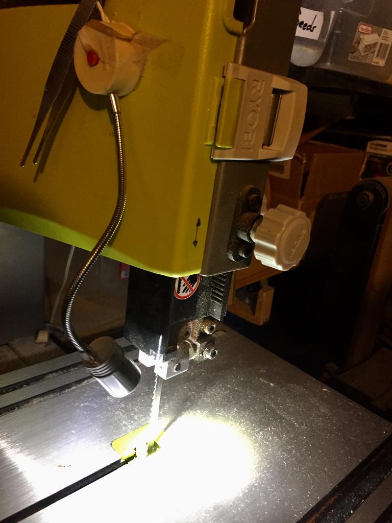

September 20, 20188 yr Popular Post comment_160378 I have two battery powered LED lamps with clamping and magnets for mounting. After a couple of years, they just quit. yesterday I disassembled one and in doing so I destroyed the lamp housing. When I disassembled it, I discovered that the neg side of each LED made pressure contact only and that handling/usage causes these contacts to dislodge. I soldered a good copper wire to each and fashioned a lamp case on the lathe. I soldered the wires and gooped the end for a tight fit. Works just fine now. Report

September 21, 20188 yr Author comment_160499 My wife got this LED lamp several years ago for her sewing machine. When she didn't want it anymore, I put it on my bandsaw and it is perfect for that job. Report
