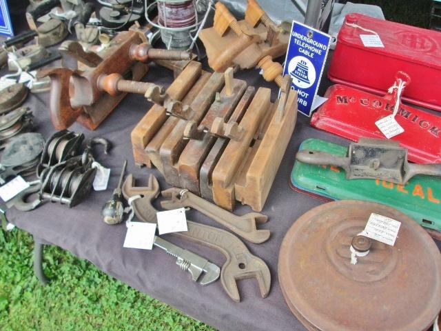

The word here was...OUCH!   The one big plough plane?   $80....The Stanley #80?   $20...
Didn't need any of these...things...nor..
Any of these...I even turned down a Stanley Handyman #4....moving along...

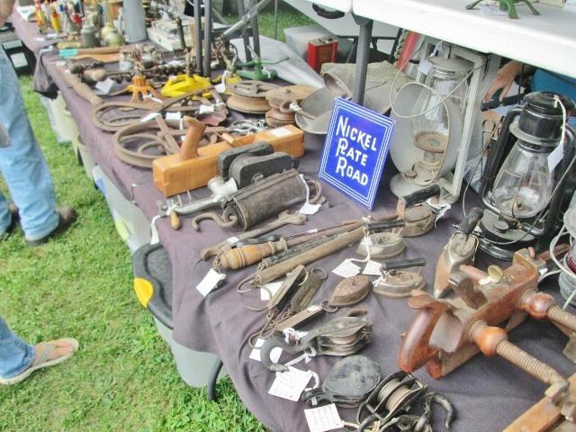

I did find one item in this pile...but not much else...
Not much here, to look at..tool-wise..

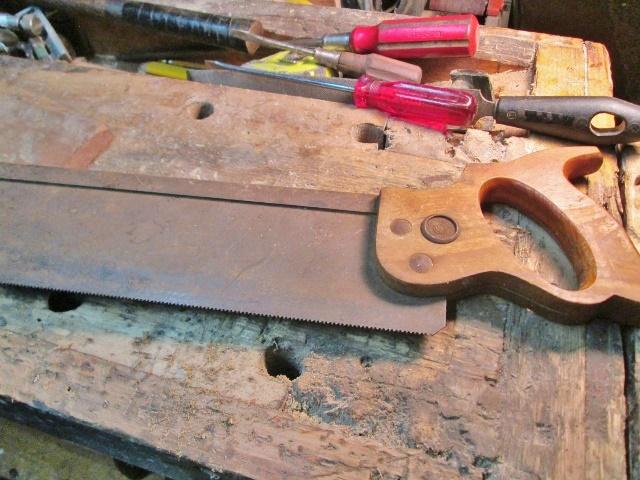

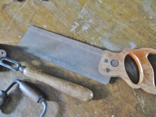

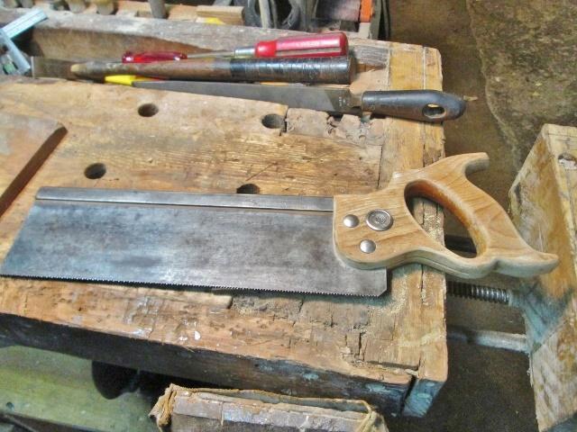

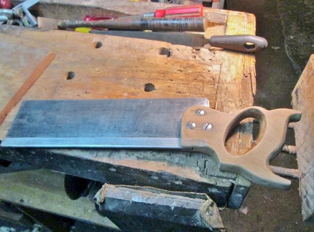

$3 saw.    And, for a $1 donation, a big glass of ice water...Long, humid day...."dogs" are barking, right now...

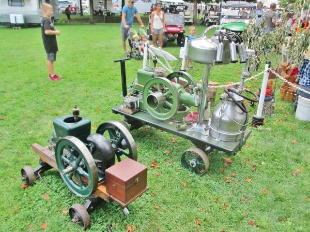

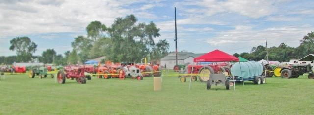

Lot of "hit-n-miss" engines there. I'm going to guess that 3500 lb gvw trailer in the first picture was nearly maxed out?
Good mix of tractors in the picture...maybe an F-12 McCormick, some old Cases, a couple of Cockshutts, possible a 40 or 50 wide front Deere ("Johnny Popper")...love old tractors, now:P

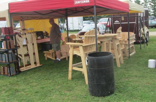

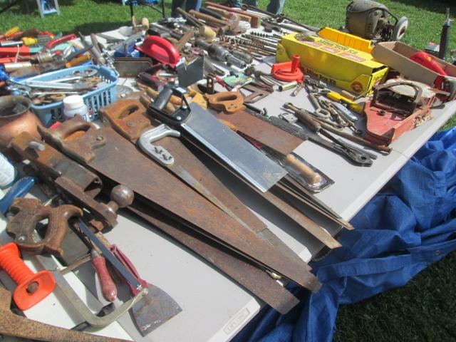

Quite a mix of vendors it appears...Pretty good variety of tools too...like most festivals or open air flea markets, most tools are priced priced above true market value...sometimes a bargain or two to be had.

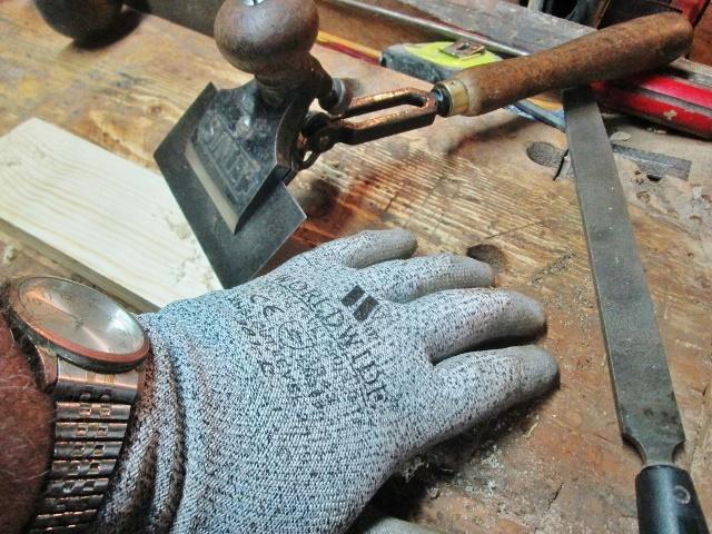

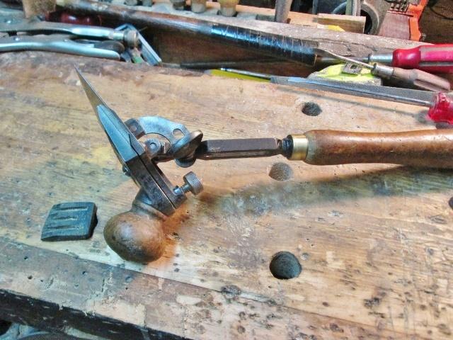

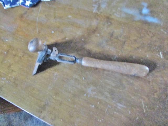

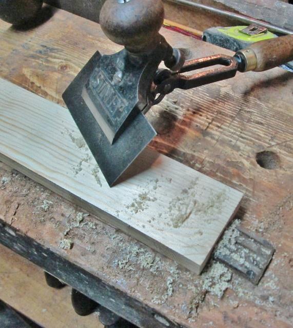

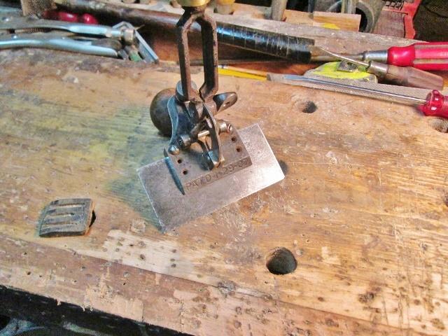

The Stanley No. 82 has been cleaned up....blade is a "Work-in-Progress" as I am rather new to sharpening such items....and there are a couple "dings" along the edge.
Will post a few photos..when the other two "things" are cleaned up, and presentable to Polite Company....

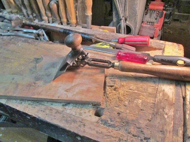

Steve, how, and for what is that 82 used? How sharp does it need to be? It wouldn't need a burr turned, would it?
About the same things as a card scraper, or a Stanley No. 80.    Bevel the edge to a single 45 degree....then turn a hook over from the bevel...
IF I ever get it sharpened.....I can use it instead of sandpaper on flat areas....
Far be it from me to give a master like you advice so, consider this a VOE (from one who has far less E than you).
It's really easy to get a burr if you flatten the edge pretty flat. On thin scrapers, I use a file. On thicker ones, a grinder. In fact, on the thick scrapers, I dont even bother with turning the edge. The grinder alone produces a decent burr. A heavy grind on an undamaged edge isn't necessary. I use a light touch.
Ok, will try that.
Because I am thinking this one will need a whole new edge....cleaned up well, though..
That knurled bolt has a lot of writing on it....for Stanley Rule & Level Co.   of New Britain   CONN  USA
PAT. No. 1-29-07.....Jan. 29, 1907

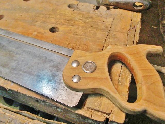

This thing...
Has a Keystone in the medallion...and is a Warranted Superior....the "Before"
Need to add a finish to the handle..
Even "clocked" the slots..

Steve, that's a lot thinner than I thought. Maybe the traditional file and burnish will be the way to go. To get a straight, flat edge, I put the file in the bench vise, it has 1" thick wood faces, and run the scraper against the file with the scraper face flat on the edge of the wood face.
Jaws on mine are a bit thicker

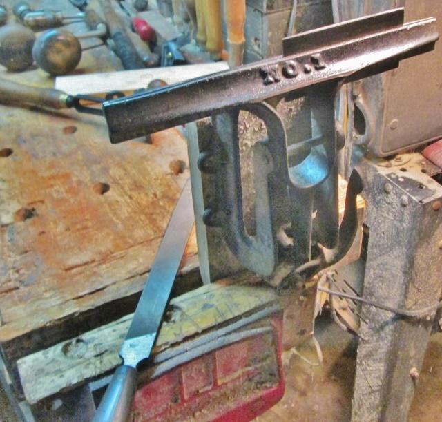

May drag out the Wentworth No. 1....and set it up....and use the saw vise to hold the blade.     First, I need to get rid of a few "dings" along the edge....almost like they had scraped over a nail....

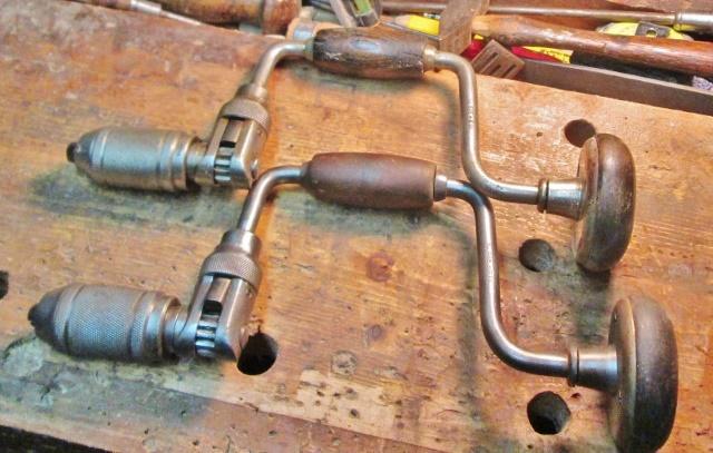

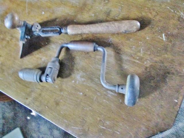

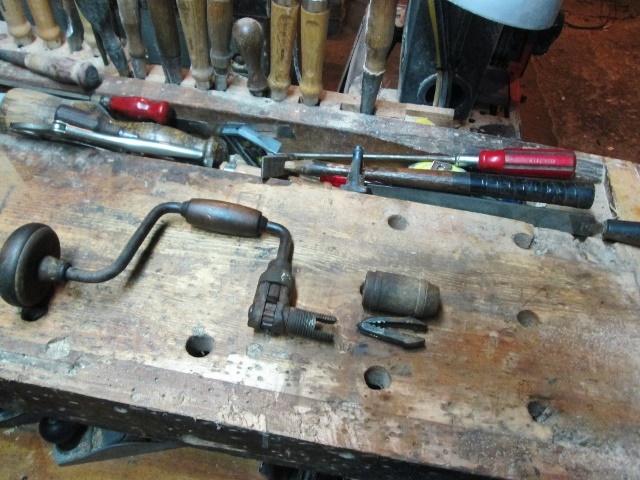

May after supper, get the brace cleaned up....and see about re-doing the edge.    Basically, it is just a shorter version of the one a Stanley #80 uses.
Supper was late....had a "visitor" in the shop...

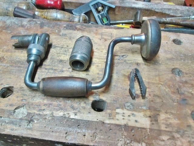

Usually, it moves a little faster...tonight...wasn't quite fast enough.   hauled the brace to the shop..

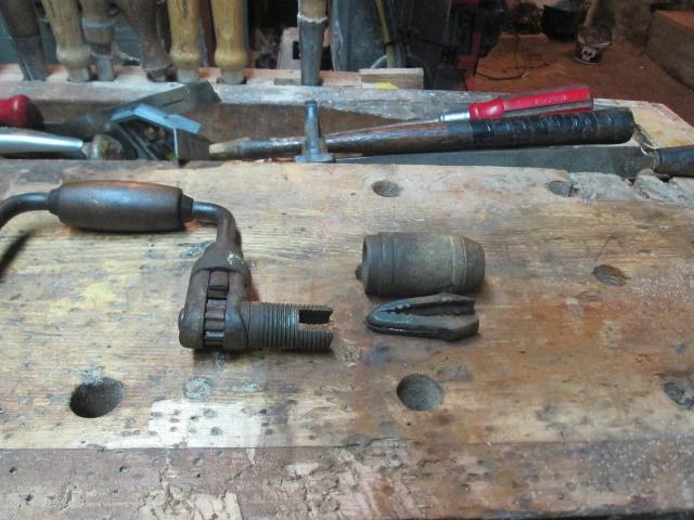

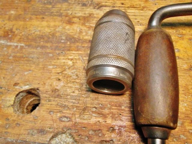

Took apart what I could....found something I don't usually see...
These jaws still had their spring.   Wire wheels of all sorts...
Look any better?   Got to looking over at the drill til....
Yep, now have "twins" in the shop...
At least I can tell what they are...
They wanted you to know who made these... even says so on the chuck..
Made [ STANLEY] in USA....and then I got out this toy...
Wentworth No. 1  ( wonder it he knew J.G.?)  Used the file to joint a new edge, and remove the dings....Then file at a 45, then a big round screwdriver shaft to turn the burr...600 grit oil stone to smooth things down a bit...test drive?
getting there...may try again....I did have on the "cut-proofs"
As I don't need any more cuts.   I think that will do for one day?
