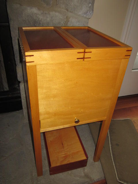

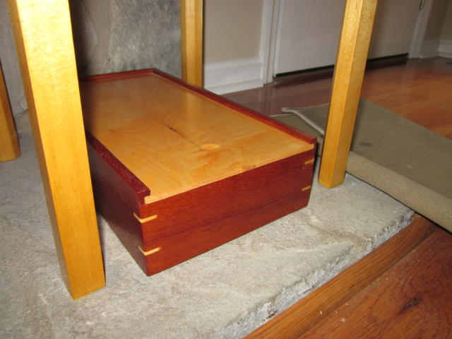

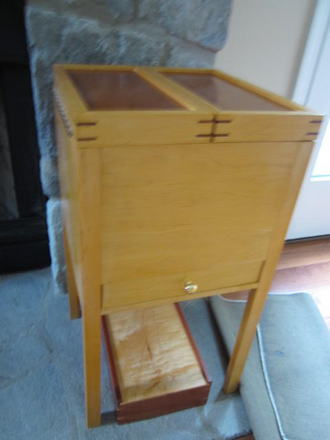

  • Color in the finish.  I have a sewing cabinet I made from maple and it's finished with a lemon shellac.   Has a nice, soft yellow appearance.  Orange shellac also does good things to black walnut.

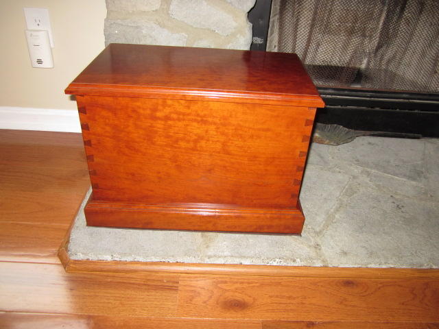

  • An air-dried cherry piece -  I applied a coat of BLO (Boiled linseed oil) and sat it on the patio for a week of afternoons.   They applied a shellac.  It developed 10 years worth of patina and aged redness in that week.  I've had similar results on cherry with a Danish Oil, that's often a large percent BLO but it takes a few more years.
  • On a small box that holds my wife's crochet needles.   A coat of shellac brought out a lot of color and luster in the mahogany it was made from.  The lid is curly maple and the shellac brought out the chatoyance* in that, too.
