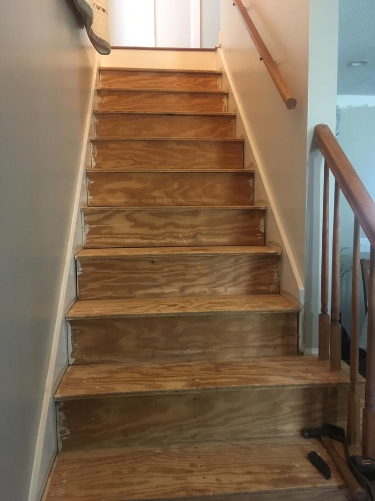

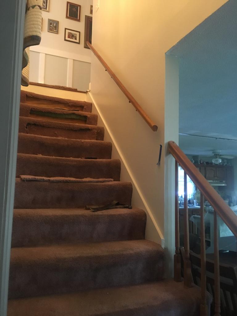

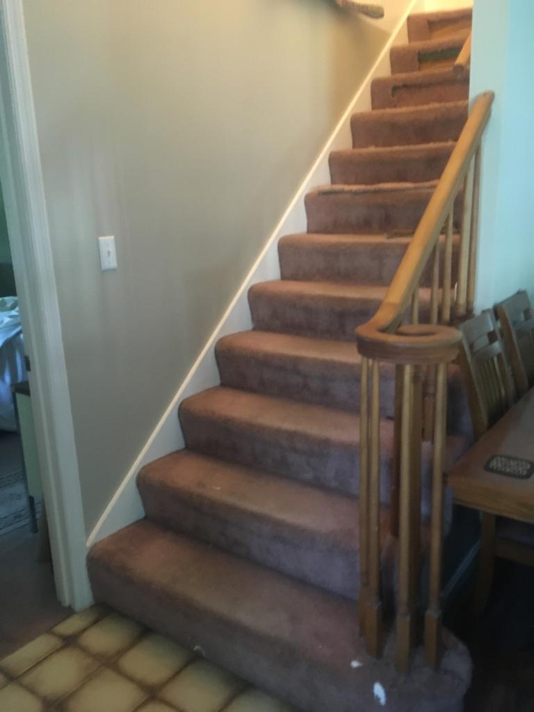

June 19, 20188 yr Author comment_152063 Ok, made it back. Sorry Dave (I really am) that we are not going to Charleston or Savannah. Am sitting in Statesboro while the wife works in Metter this week (everythings better in Metter...). But we visit some good friends in the evening. Tomorrow for lunch I am meeting up with another old friend. But stairs - one of my 2018 goals is to re-do the stairs and stairway. After removing the carpeting we find plywood. I expected worse. We want to change out t risers and treads. The risers will be painted and the treads will be stained oak. Options for the treads look like laminate (glued to the existing plywoood), an oak “retread” (5/8” glued to the existing plywood) or a full 1” oak tread. At this point I am leaning towards the last two options. Something about an MDF nose in front of laminate just doesn’t seem quite right... So a couple questions for those who have “been there - done that” Did you place the riser in first, then the tread; or the tread first with the riser sitting on top of that? I have seen it done both ways on you tube. I would think riser first. If you have used the re-tread system, what were your thoughts on it? If using a full thickness new tread, would you lay them over the plywood - or pull the old plywood tread up? If it matters, the plywood thickness is only 3/4”. I know I will have other questions after I have a chance to ponder your responses. TIA Report
June 19, 20188 yr comment_152069 Did you place the riser in first, then the tread; or the tread first with the riser sitting on top of that? I have seen it done both ways on you tube. I would think riser first how are the current risers and threads set into (mortise) or on the stringers as in is there another set of cut stringers or blocking we don't see??? which ever you do.. the bottom face of the risers fasten to the back edge of the tread... and the top of the risers are fitted into a shallow slot in the leading edge of the tread above it... do you have full access to the underside of the stairs??? If you have used the re-tread system, what were your thoughts on it? re-tread as replace or cover over??? If using a full thickness new tread, would you lay them over the plywood - or pull the old plywood tread up? If it matters, the plywood thickness is only 3/4”. replace... then you haven't got elevation changes to fuss w/... but if you are going to be adding to or changing the upper and lower landings' elevations, lay over... Report
June 20, 20188 yr Author comment_152128 Thanks Stick for your reply. The current risers and treads are simply nailed to 3 stringers. There is nothing fancy, and no interlocking of risers and treads - just butt joints. (Is it a joint if the parts only meet and are not “joined”). I do have access to the underside of the stairs. The re-tread system that I have looked at are 5/8 thick that glue to existing treads. Here is one example: https://www.lowes.com/pd/RetroTread-11-5-in-x-42-in-Raw-Red-Oak-Stair-Tread/1000445871 At to elevation changes: At the top of the stairs, the floor covering was thick carpet over a thick padding. This was changed out to laminate with a pad - quite a bit thinner than the carpet & pad. The first floor at the bottom of the stairs is presently a ceramic tile which will be replaced with a pad and vinyl plank. Net result at the bottom will be somewhat thinner, but not a whole lot. Report

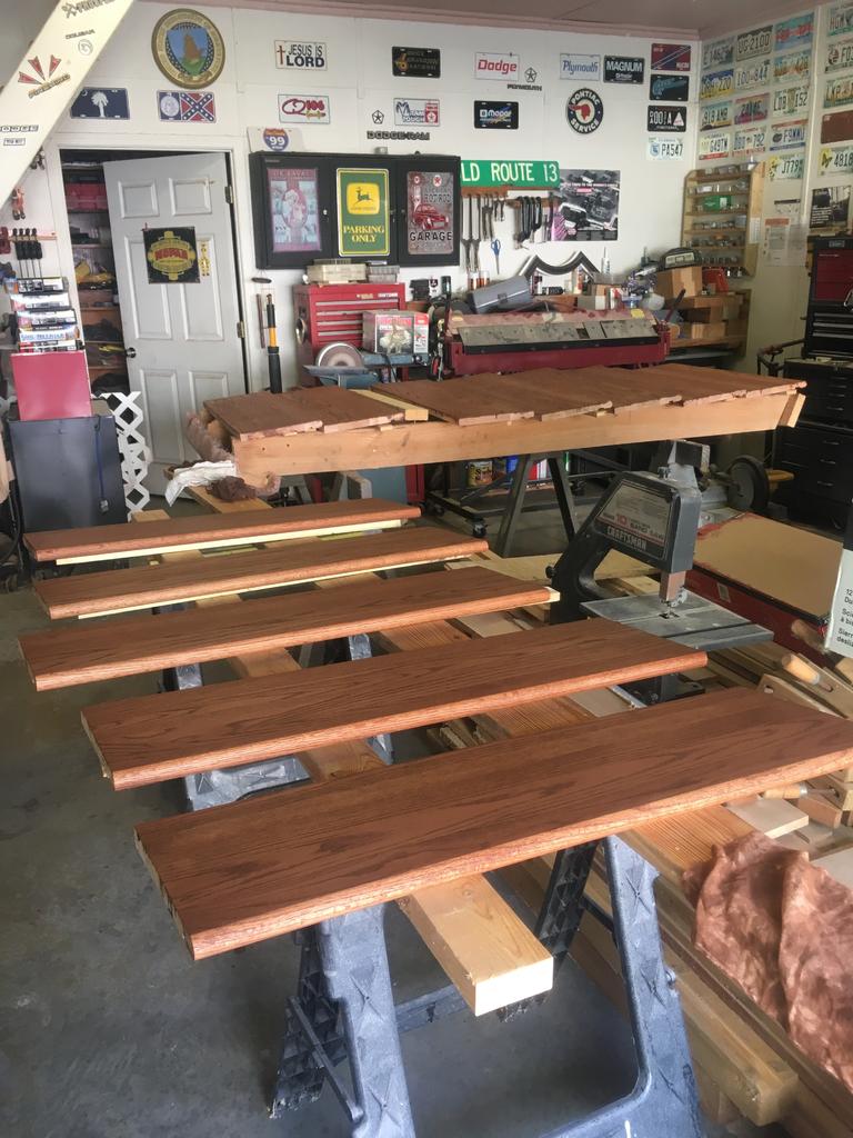

July 7, 20188 yr Author comment_153393 Thanks @JIMMIEM This project is well underway at this point. Going strictly by the current code just wasn't in the cards, given the available space to work in. The existing treads were not level right to left. They were not level, nor uniform back to front, and disregarding the bottom and top step the risers varied in height by about 1/4". The center stringer was not even fastened at the top - it was just a floater!!! I guess that might explain some of the waviness in the existing treads... I spent a good bit of time preparing for new solid treads. Fastened the center stringer to the floor joist at the top and sistered a 2x6 to it for added strength. A lot of 'rithmetic & cipherin' and I am ready to install treads. I have them all level right to left and about a 1* slope front to back and all risers are within 1/16", including first & last step. I am cutting the last treads today and will finish them before installing. Spent a fair amount of time yesterday on newell post placement and trim work. I will be posting up a few pics when I get done. Report

July 8, 20188 yr Author comment_153490 Thank you again JIMMIEM! I watched several of the videos. I shall be looking for these at Lowes/HD the next time I go to town. I have all treads cut now and stain applied. I may start with the poly today, but maybe not. A lot of yard work to do. Report

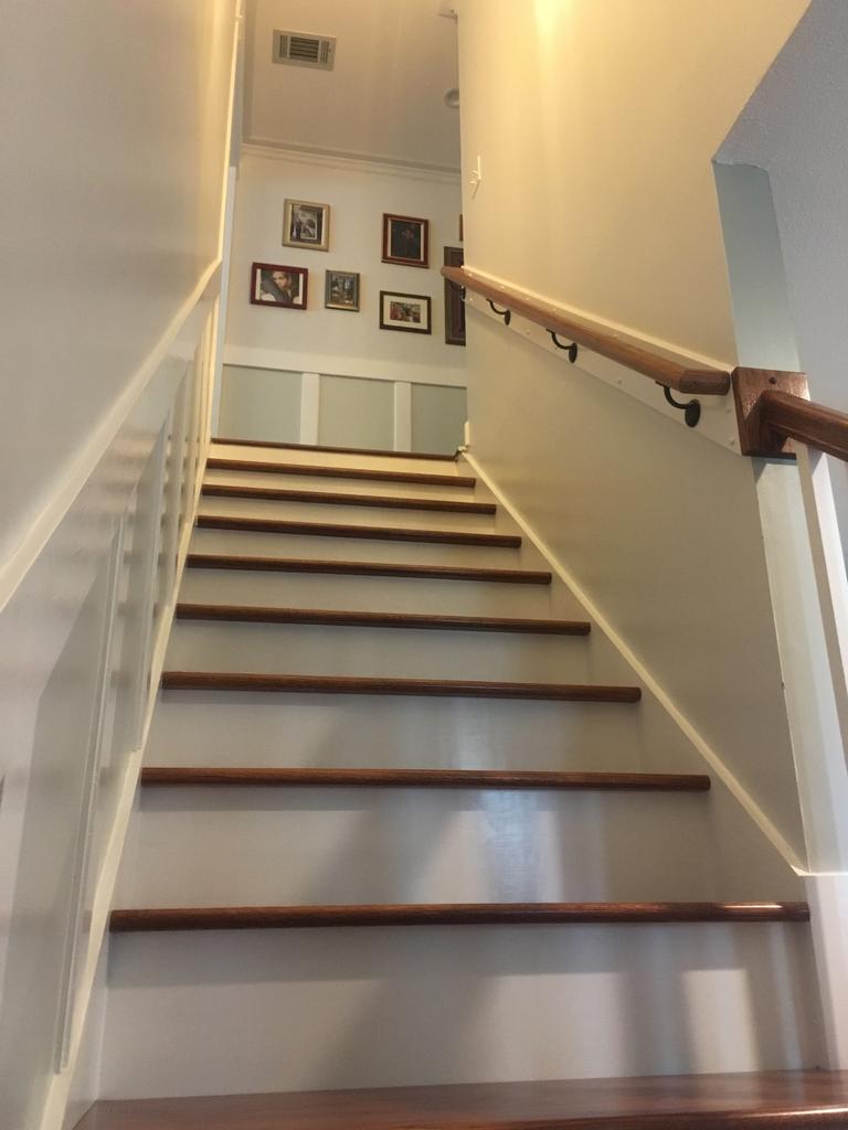

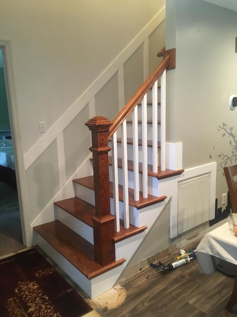

August 5, 20188 yr Author comment_155827 A little touch up paint yesterday and I call this a done deal... until I redo the first level flooring that is. Will be hanging some artwork/pictures up the left wall at some point. SWMBO says she likes it A couple before and afters: Report
August 5, 20188 yr comment_155828 10 minutes ago, Cal said: I call this a done deal. that sure came out nice... Report
