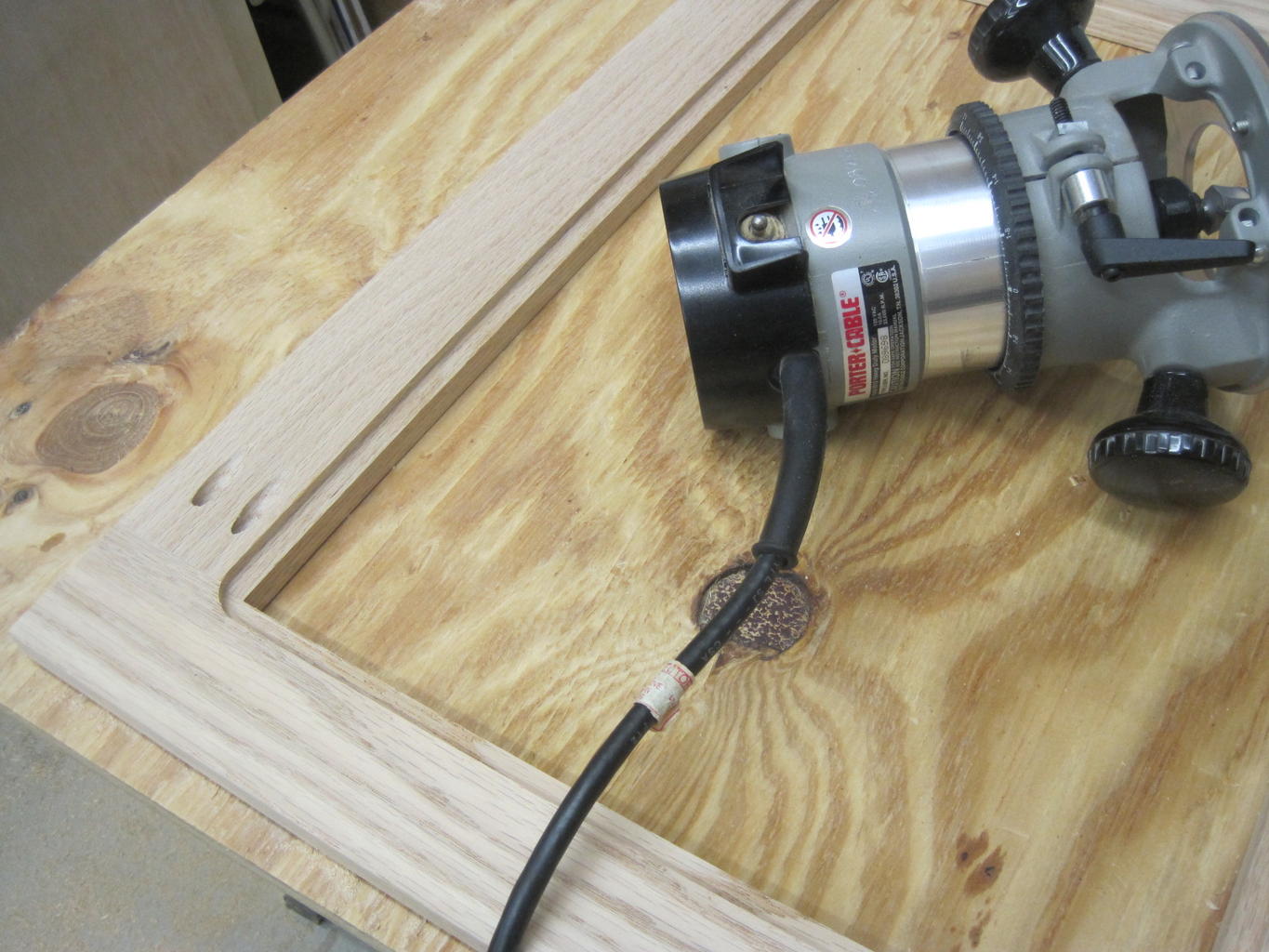

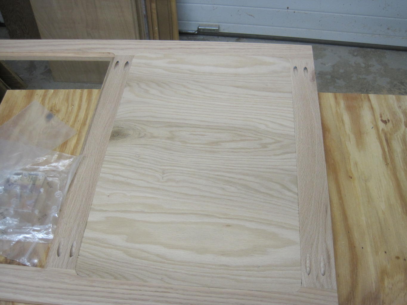

If we're talking quick and dirty, this is how I've been making doors for shop cabinets...................

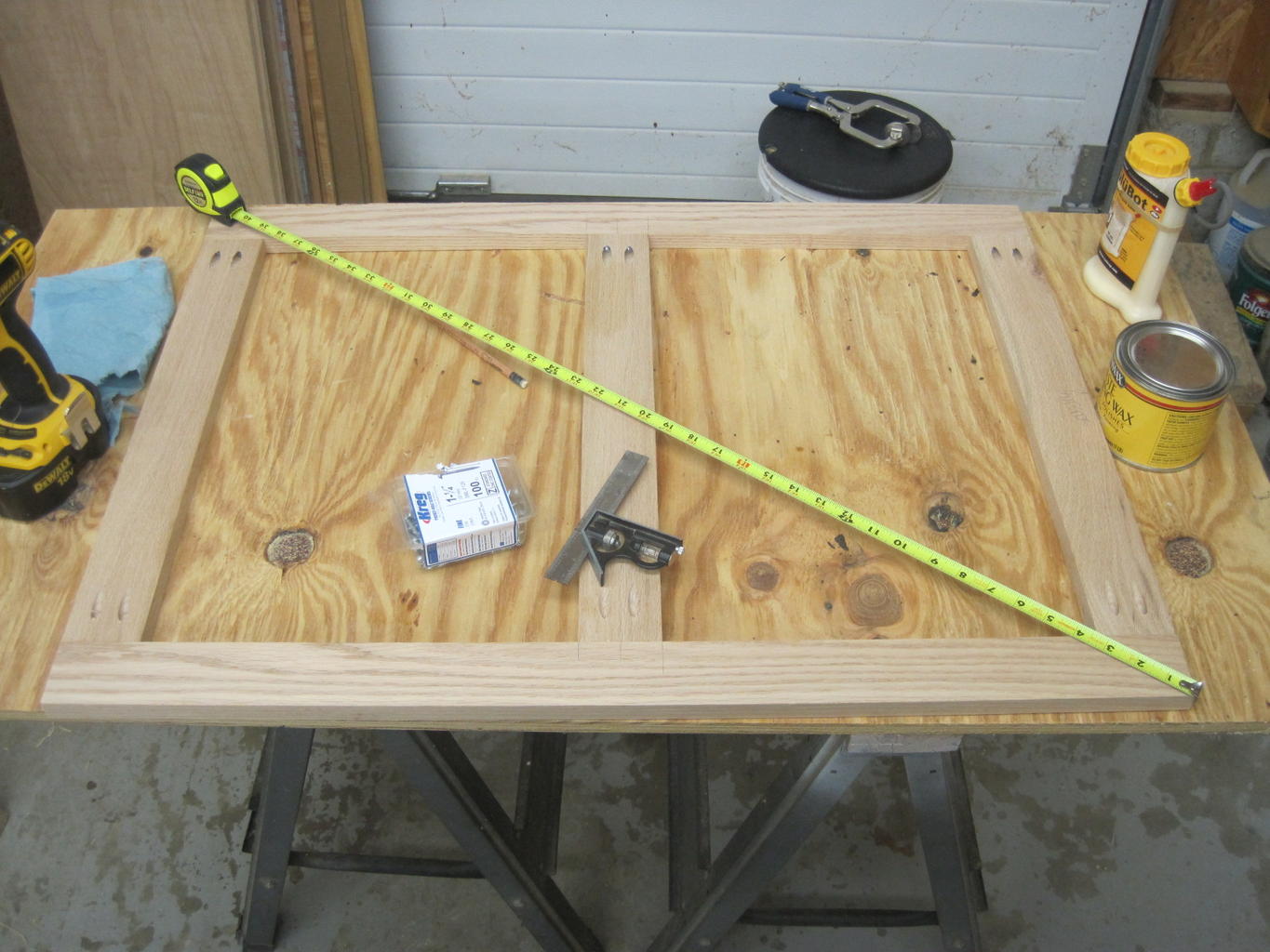

Door frame using pocket screws

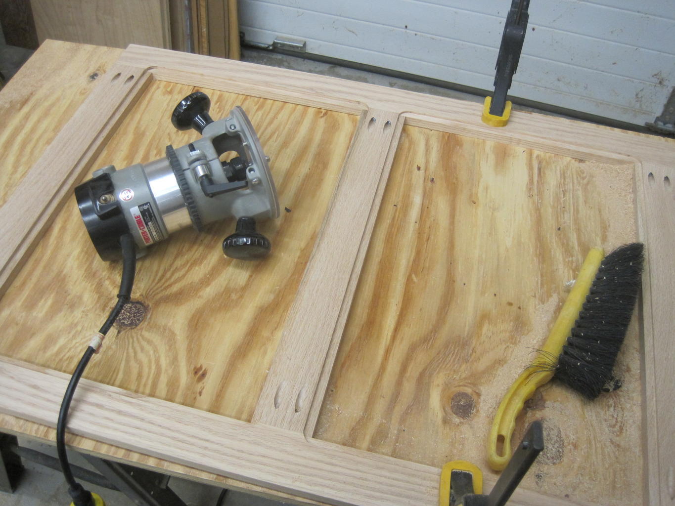

Cut a rabbet on the back, around the opening, and to the depth of the plywood panel

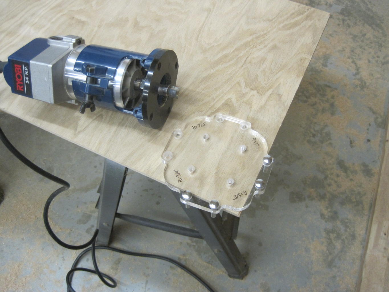

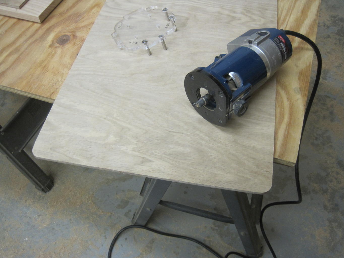

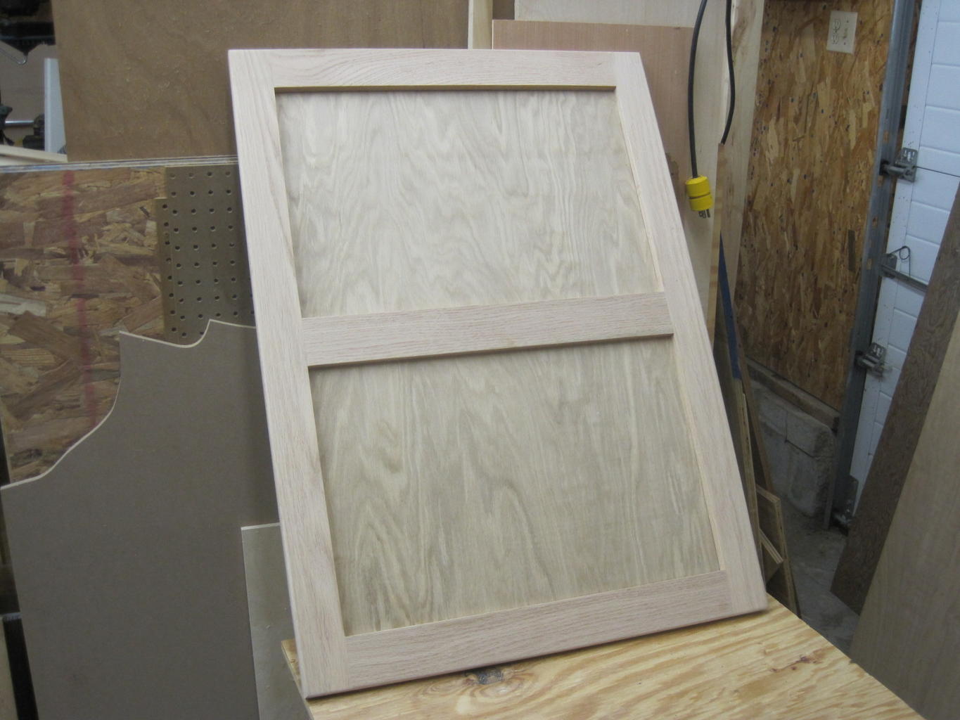

Cut the plywood panels to size and radius the corners to match the rabbet in the frame
Glue the panels in place, using short brads or pin nails

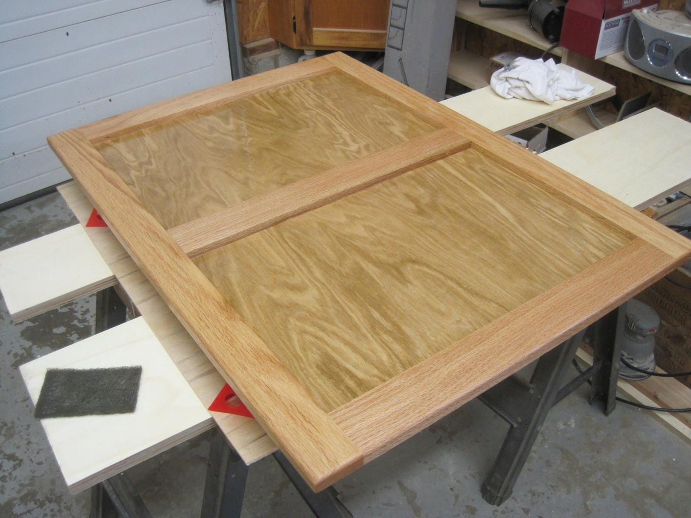

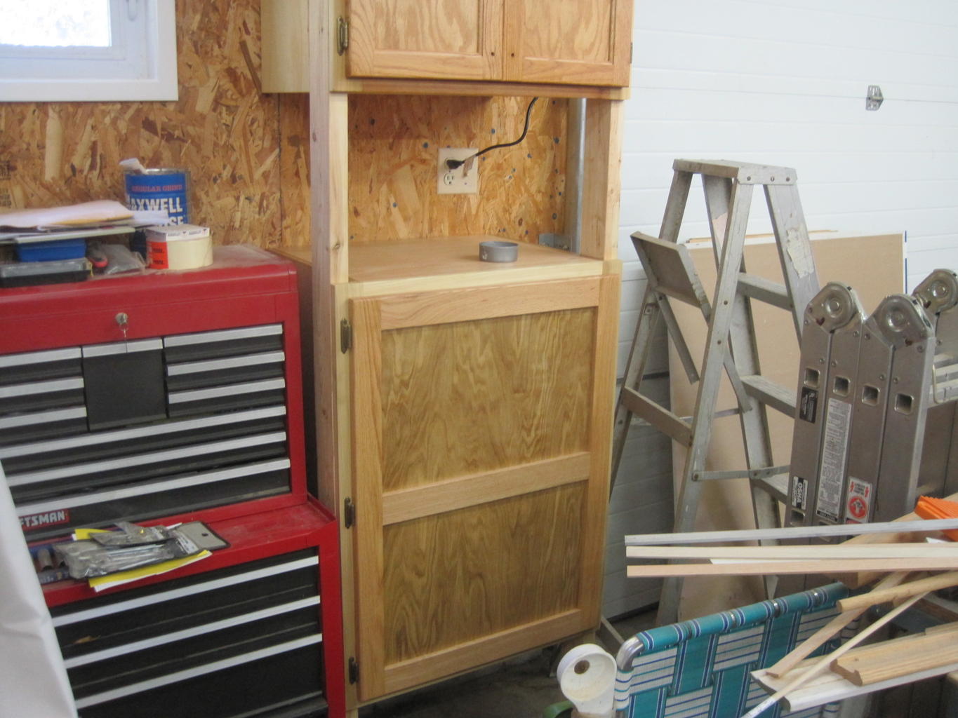

The finished product
Good looking doors, Tom. Fast and easy. Thanks for the pics.
