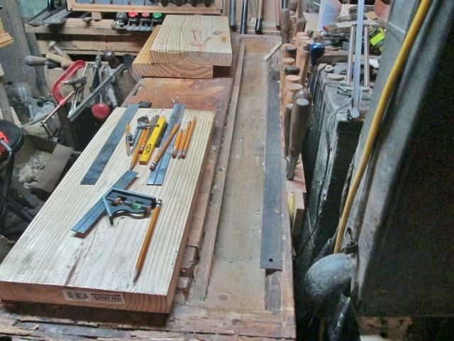

Roh-kay...here is what I have to work with..
Ummm...yeah.    Needed a lot of room..

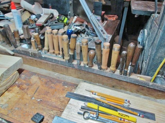

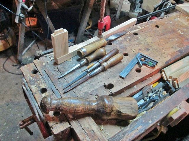

Even cleaned out the tool well:o And put the chisels away..
Someday, I need to add a second row of holders....
Laid out for a few bandsaw cuts....not up to hand saw ripping, nowadays..:(

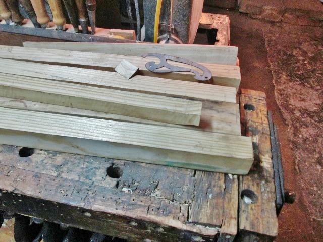

And got four blanks for legs...that thing in the middle?   Have other plans for it....
First cut.   Frenchy provided the curve at the end.  "waste" is now a pattern...three more cuts...

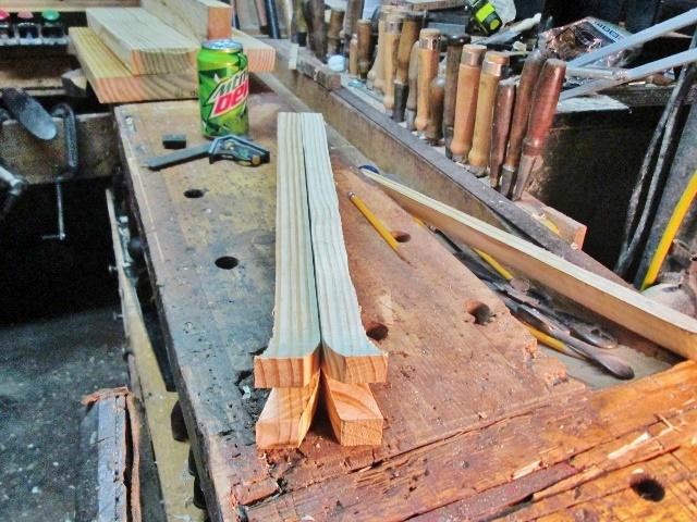

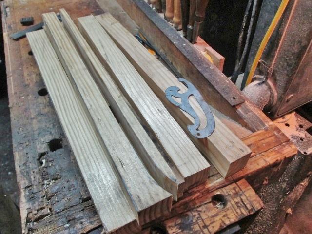

OK, so..after Lunch...got the other three legs sawn..
The hardest part was making sure #4 was curved in the right direction...
Had to recheck a couple times...even after the first cut...anyway, set these aside.

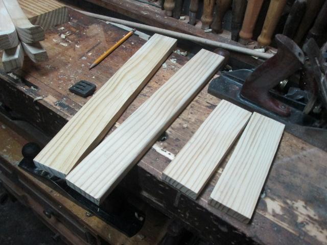

One of the other 1 x 10s seemed to have been a Knot Farm.....Marked things out to get 2" wide blanks..then resaw for 3/4"  thickness
Then sort through these....and cutting out the bad spots....most of them...using the mitresaw..

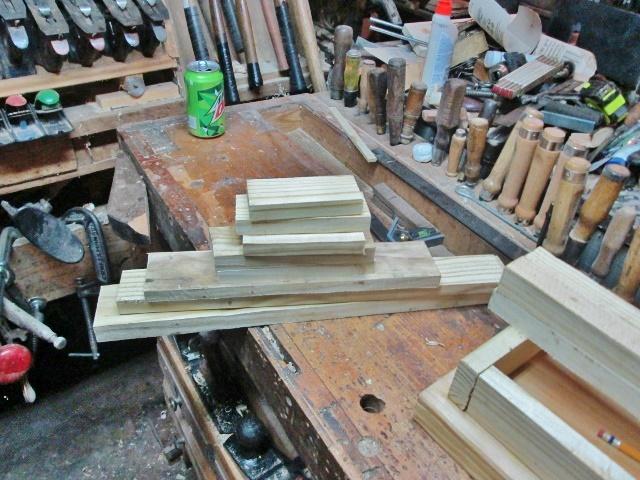

Knots and splits went to the burn can...somehow found enough good parts to make four aprons..
Allowing for tenons and such...better to be a tad long, than too short, right...
Which left this stack of "Just-in-case" parts..

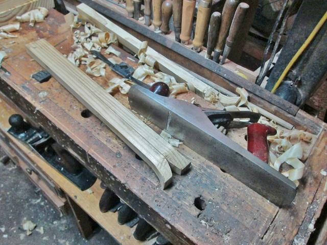

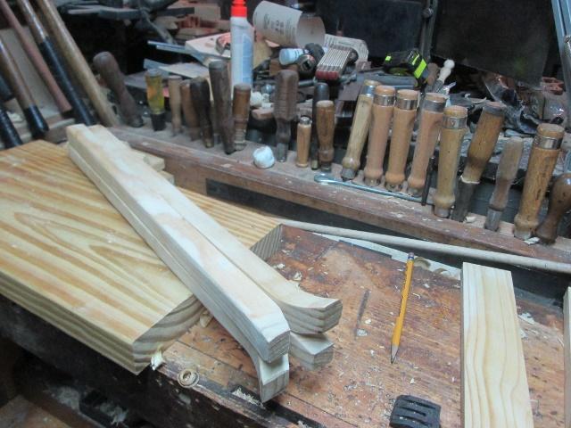

Legs needed worked on, so did the wood ones..:cowboy: but, I worked on the wooden ones, this time..
Saw marks needed to leave, wavy surfaces needed to be flat,  and the square part needed to be 1" x  1" square.....couple of these were a bit..FAT:rolleyes:
Spokeshave to round the outside corner of the leg.   Sanding Center's  beltsander to smooth the curves.   Palm sander to smooth the rest...

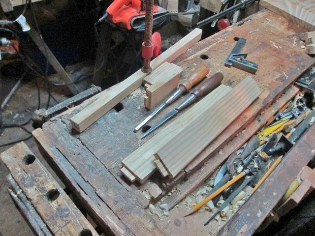

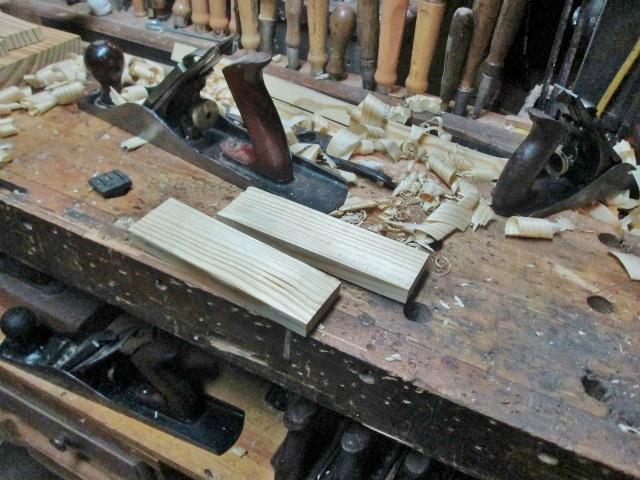

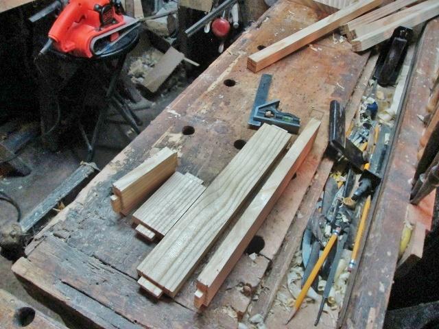

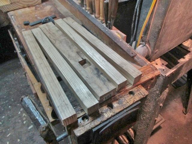

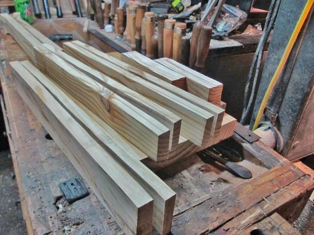

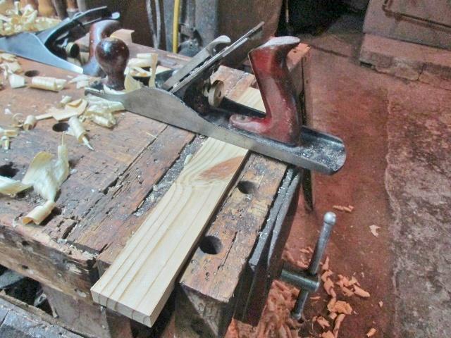

Not perfect, but close enough.  Then it was the aprons' turn under the planes..
These two were not even close to the same size...thickness or width....Planed them until the matched each other, benchdog as a stop.
Once these two were done, then the long ones were done....one of those had a surprise..:angry:

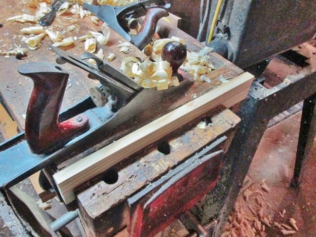

One face was clear, turn it over, and find a knot.   Jack plane never noticed it.  Had to joint the edges, until they matched the short aprons for width
Shavings were piling up, too.  Got all the aprons to match each other, for width, and thickness...
Yes, that knot is under there.   Marked the tops of the legs, to show where the tenons will go...
Set these items aside...need to work on that plank, under the legs....

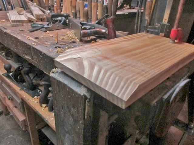

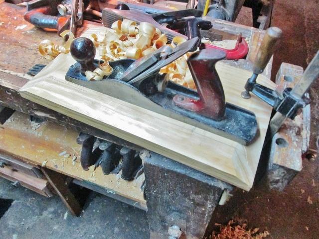

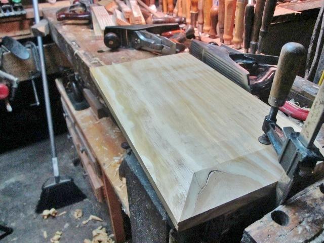

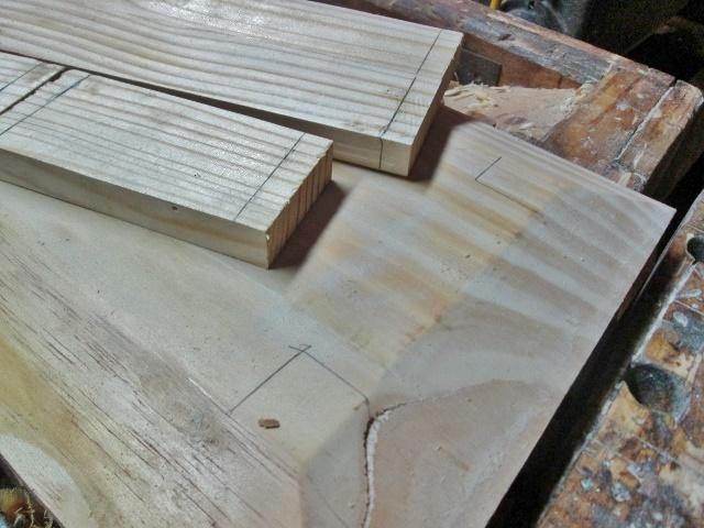

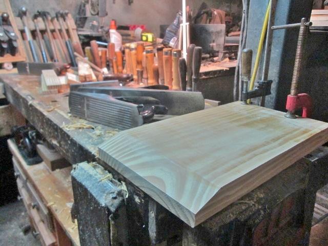

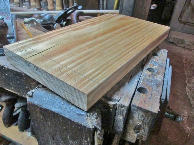

This is the "bad" side.   This will be the bottom of the stand's top.   Marked this end for a bevel..
Marked one along the end, 3/4" down ( or up?), the second line is 1-1/4" back from the edge....these are the stop lines for making the bevel..

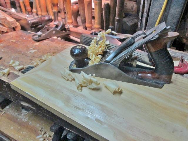

Couple of clamps, and the benchdog (hiding behind the plank) to keep things from moving.  Coarse set jack to start the cuts, then the #4 to smooth and finish the bevel

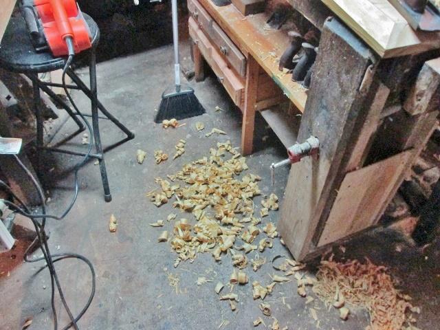

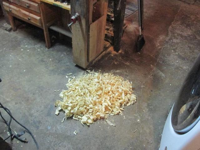

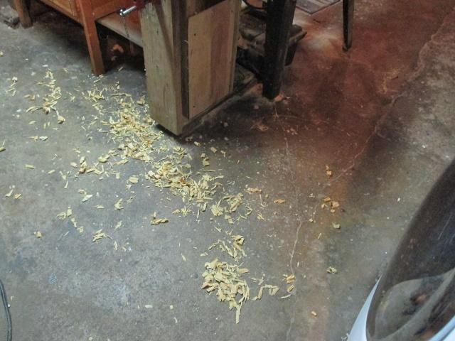

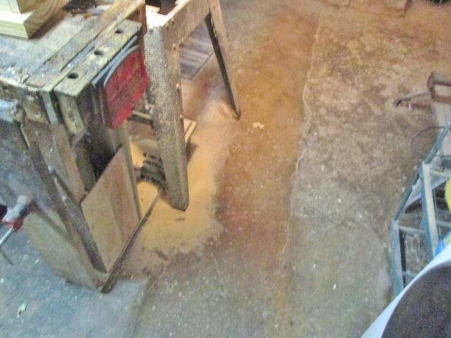

Next time, I'll turn this and do the other end....then the two sides.   Once all four edges have their bevels done, then I can size the aprons for length, as the base will sit inside the bevels..  IF the back straightens out....hate when I cough.  this one bevel make a mess on the floor...
Just one bevel's worth..imagine four.   Cleaned this up, and called it a day....back didn't like going over the 2 hour time frame...

Well..it was until the legs started to cramp up..mine, that is....got bevel #2 done...
2 down, two to go.  Planes?

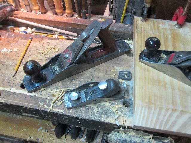

Made in England, Stanley #4c...the jack and the block plane?
The little Shelton has already hopped off the bench a few times..didn't seem to bother it...Miller s Falls jack because it has no camber to the iron..."new" one does.

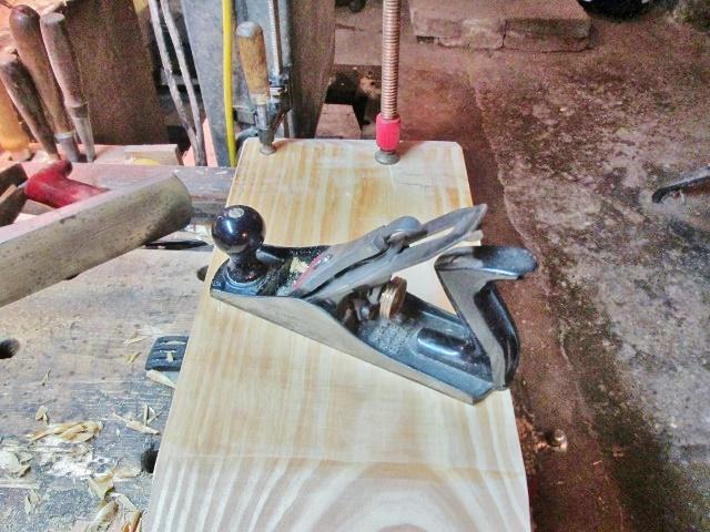

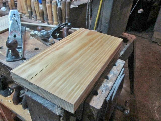

Turned the board 90 degrees,and laid out for bevel#3
Jack plane to get close to the lines. then the #4c cleaned it up...
Same routine with the last bevel, trying to get that "crisp" corner Sellers likes...then the #4 smooth plane to clean things up..

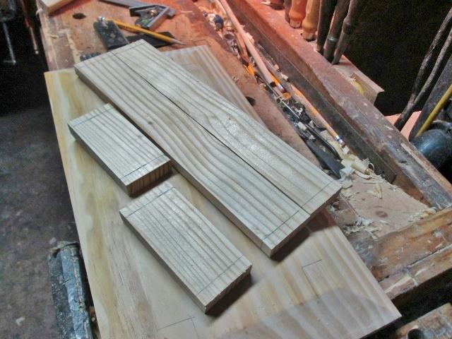

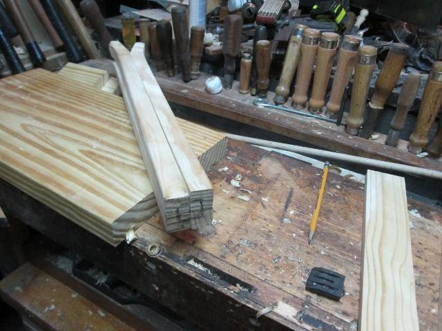

I took one leg, and traced around it, at each location the legs will go.   Then I get mark for a 3/8" tenon, and the final length of the aprons..

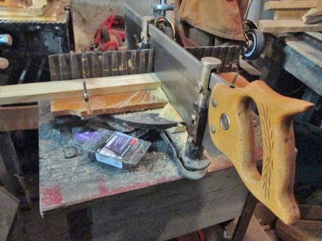

Small mitersaw to cut to length...then mark out the shoulder cuts for the tenons...and set the depth stops on the Langdon75.
Laid out the cuts..

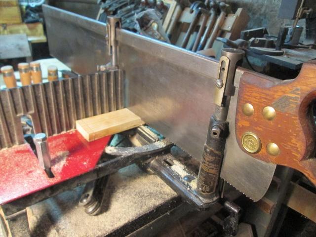

Used the mitre box to make a few cuts..
First cut, to double check how deep it was....handle side was a hair shallow, adjusted that. and made the rest of the cuts..
Depth stops are holding the saw up.   Then to the bandsaw for the rest of the cuts...until I had these..

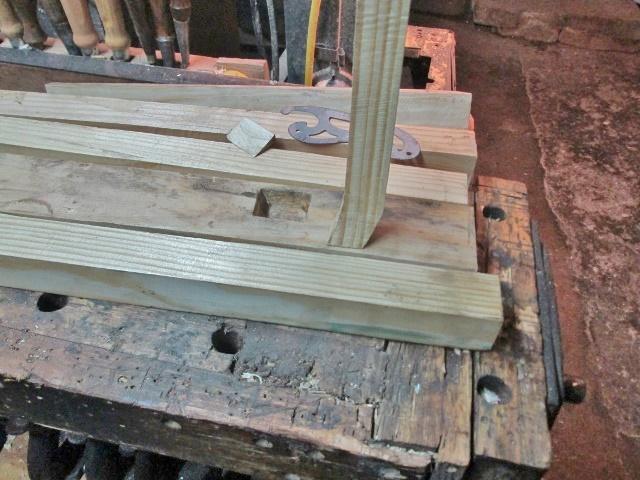

Time to set up for mortises..

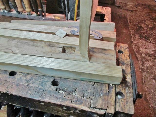

Thanks to those feet...I had to hang them off the side of the bench...marked out for the mortise, and did a bit of chopping..
Rotate, rinse, and repeat....got three done, and dry fitted..
And was setting up to do #4...
When MY legs started to cramp up....guess I was done, for the day...

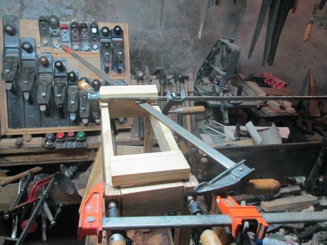

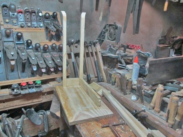

Well...I was just going to take that backsaw down to the shop, clean it up a bit, and maybe a test cut..:ph34r:..that WAS the plan.....fan was on "HIGH"..got to looking at that plant stand...maybe if I lay out a mortise......:rolleyes:

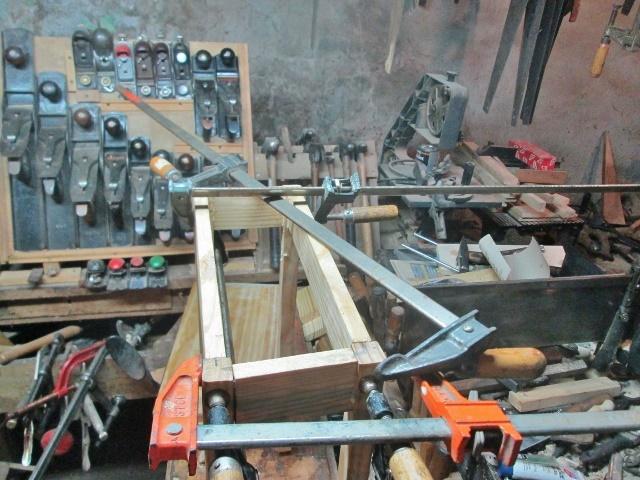

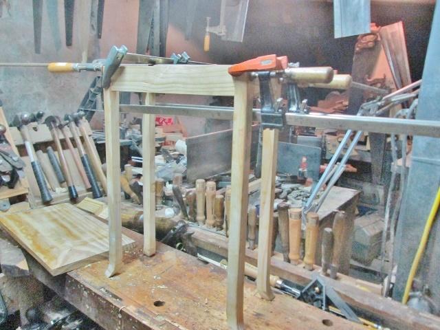

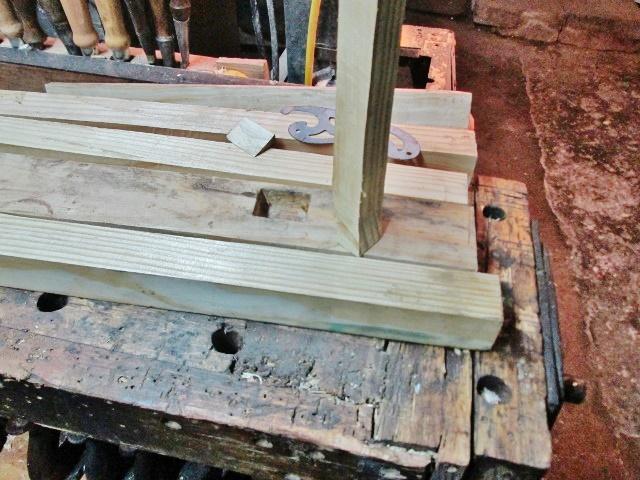

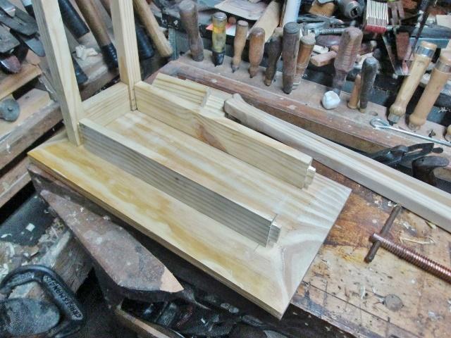

Wound up chopping all the remaining mortises...spreading some glue ( more on the parts, than on me) clamped the mess together..
Checked the diagonals for square,,,yep, had to add a fifth clamp....then laid out a couple blocks for tomorrow..
I'll cut these to length, and notch around the legs.   May add a few pilot holes for screws.....these will be to attach the top.

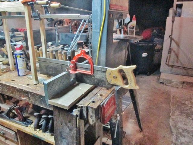

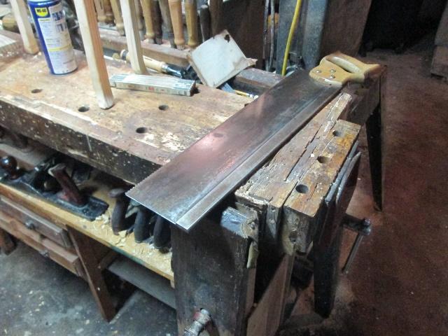

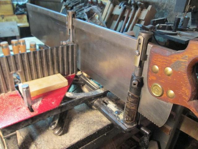

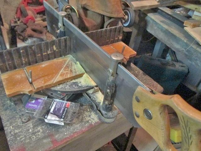

About that saw...was a 4" x 22" saw..too short for my Stanley #2246 mitre box.....I got most of the rust toned down..
I may have the mitre box that will work..
Or...just keep the saw as a "carcass saw" and see how it works.
