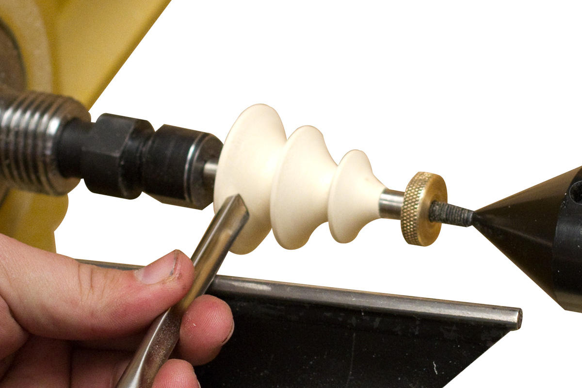

May 30, 20188 yr comment_150480 I'm not the brightest light bulb in the crowd and this turning tool is something I've never seen. Is the piece on the tail one piece or is it a continual piece from head to tail. What is it called and what does it look like on the bench? Thanks Report
May 30, 20188 yr comment_150483 It looks like a pen mandrel or other mandrel that he's using. Not sure why in this application though? Steve Report

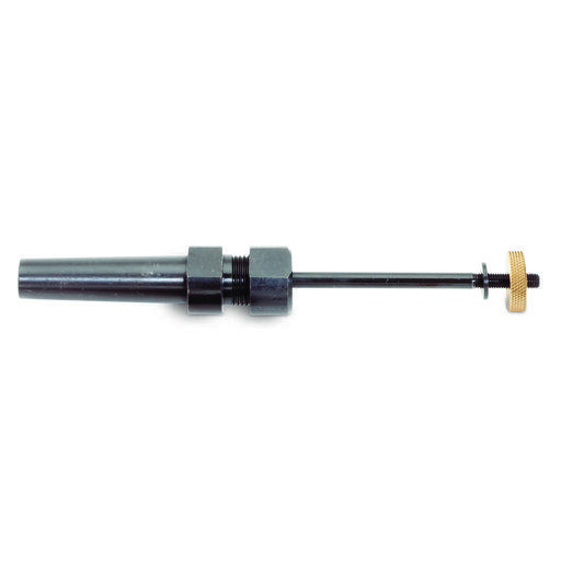

May 30, 20188 yr comment_150484 When turning pen kits a mandrel is needed and that is what id being used here. https://www.pennstateind.com/store/PKM-FLC.html There are different styles but all di the d=same job. https://www.pennstateind.com/store/pen-mandrels.html Report
May 30, 20188 yr comment_150489 Yep, pen mandrels come in many forms, some people prefer them when making pens or ornaments that will be hung on the tree. Report
May 30, 20188 yr Author comment_150507 When you turn the knurled knob does the shaft expand on the piece in the picture I provided? What is holding the piece in place? Edited May 30, 20188 yr by Ron Altier Report
May 30, 20188 yr comment_150508 Just now, Ron Altier said: When you turn the knurled knob does the shaft expand? What is holding the piece in place? No, it simply tightens the piece between the nut and the back end, much like turning between centers, except that it has a shaft running through the piece Report
May 31, 20188 yr comment_150519 Looks like a bushing under the knurled knob. I would guess it is one of those ornament kits much like a pen kit. Tube glued into wood and turned on the mandrel. When turned you put on the top and bottom for a complete ornament. Report
