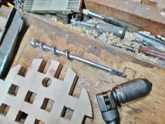

Drill down until the tip pokes through, then flip the blank over..
Finish the holes, then the chisels took over...

While down there, dodging a Bumble Bee....got the rest of the holes squared away....except for one.

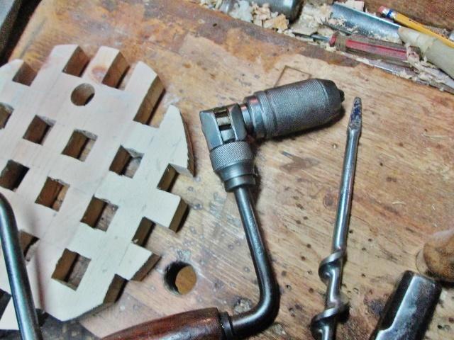

Will leave it round, so this can be hung up on a peg.   Was going to put that brace away..
But the ratchet parts were stuck.    Cleaned and WD40'd until everything works.  That bit?
Is a MINTY Craftsman #13 (13/16") that seems to cut like it was brand new....may have to keep it around...

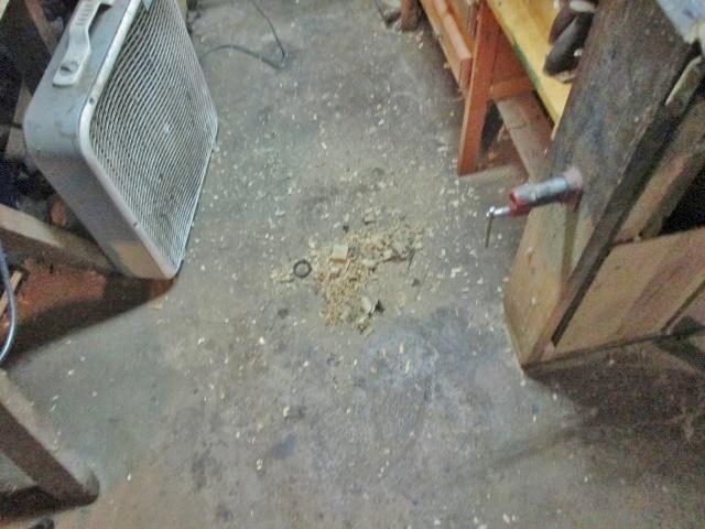

That big black dot?   That is what is left of the bee.   Need to haul the trash can back down to the shop....Have some sweepings to get rid of.

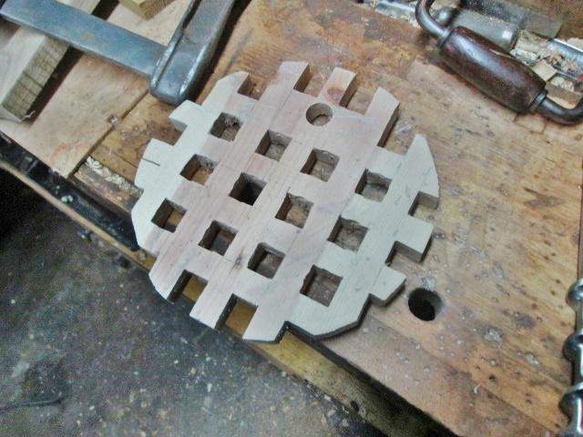

Finish on a trivet?   Have no idea.....first trivet I have ever made...any ideas?
If you are going to use it for hot pans, I'd treat it the same way as a cutting board.  No film finish will stand up.   Mineral oil, refreshed as needed.  Buy it at a local drug store or drug department (used as a laxative).  If you want, you can put in in a double boiler and shave in some paraffin.  Melt it, apply warm and let it cool.  Scuff off any wax on the surfaces.

Now about the trivet...Very cool...I like it...very creative design too! As for the finish, @kmealy's advice is the path I'd follow...

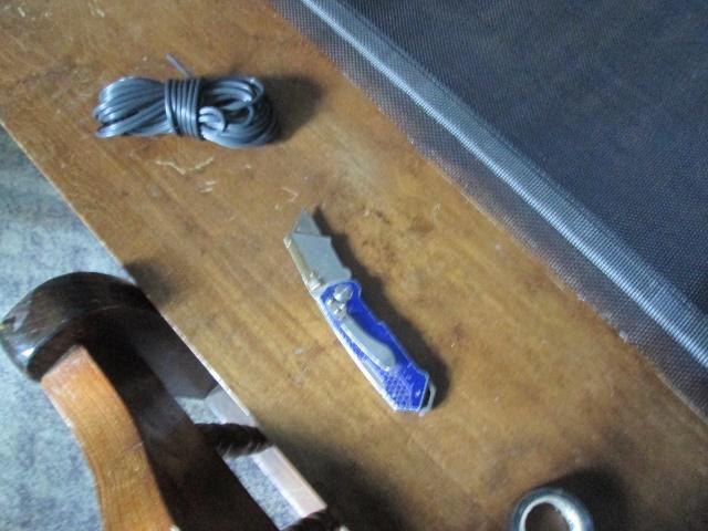

That blue thing was handy, had used it to cut the screen to size....sliced the bag open....
Seems I sliced off the tip of my finger at the same time....all H breaks loose..used about 8 of those bandaids trying to stop the leak....finally used the black tape.  It also kept the normal bandaids in place...

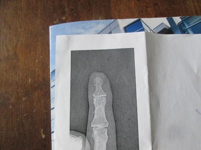

Finger  kept  getting achy.....finally walked the 5 blocks over to the ER and had them check it out....As soon as my wrappings came off ( they even said I did a great job!) the leak began again...took two tubes of that "Super Glue" they use as stitches..before the leak would stop....they also said the fingernail will go back.  X-ray showed I did MISS the tip of the bone, and a wire was found IN the finger ( ???).....Got all cleaned up, got my paperwork, and walked back home...

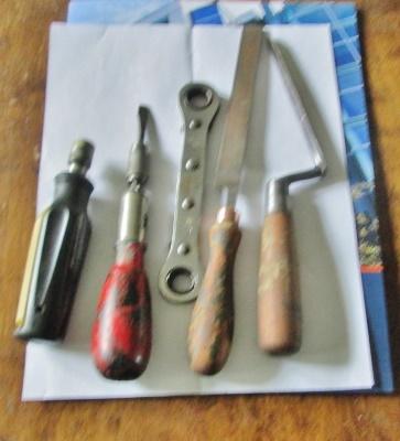

Missing a bit on the end.....as for the "Trophies" for today?
Got the two wood handled items FOR the handles....angled one is by Marshalltown, USA....the other is a file.

As for today's picking, you scored for a buck and a quarter...Is that little ratcheting screwdriver a Stanley-Handyman, Craftsman or M-F? Regardless the bit is worth what you spent...all the rest is cake & icing!
I saw one similar not to long ago for $20...must have got it 'cause it's gone...The ratchet wrench is $3-$5 if it works, no teeth missing and if a Mac, Snap-on or even a Craftsman at least double that...

Stanley handyman No. 133H.
Wrench is marked as...Taiwan..not a tooth missing.
Other screwdriver is a hex drive bit holder....
Wrench is for 1/2" and 9/16".

1/2" x 9/16" is a handy one to have...
133H is a little more rare in captivity than many of the others...
