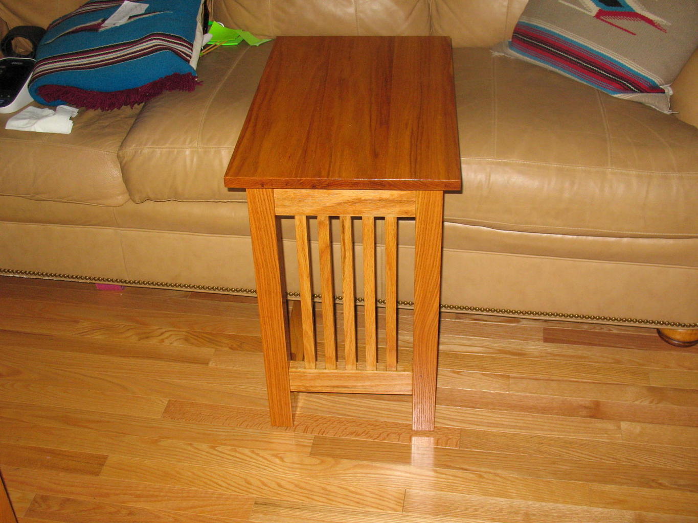

May 4, 20188 yr comment_148451 I'm building a small couch tray table out of Red Oak. The top is 3/4" thick and measures 14 3/4" X 24 3/4". I made the top by gluing up 3 boards. The top is not dead flat. If I lay a straight edge across it I can see light in a few spots. I've been sanding to try and get the high spots down. I don't have a planer or wide sander. I loaned my belt sander and it hasn't been returned. I have a random orbit sander but don't think this will do it for me. There aren't any woodworking close by. I'm going to stain and use an oil based poly on it. I've used poly quite a bit and I'm wondering if the self leveling process will help make the top flat? Report

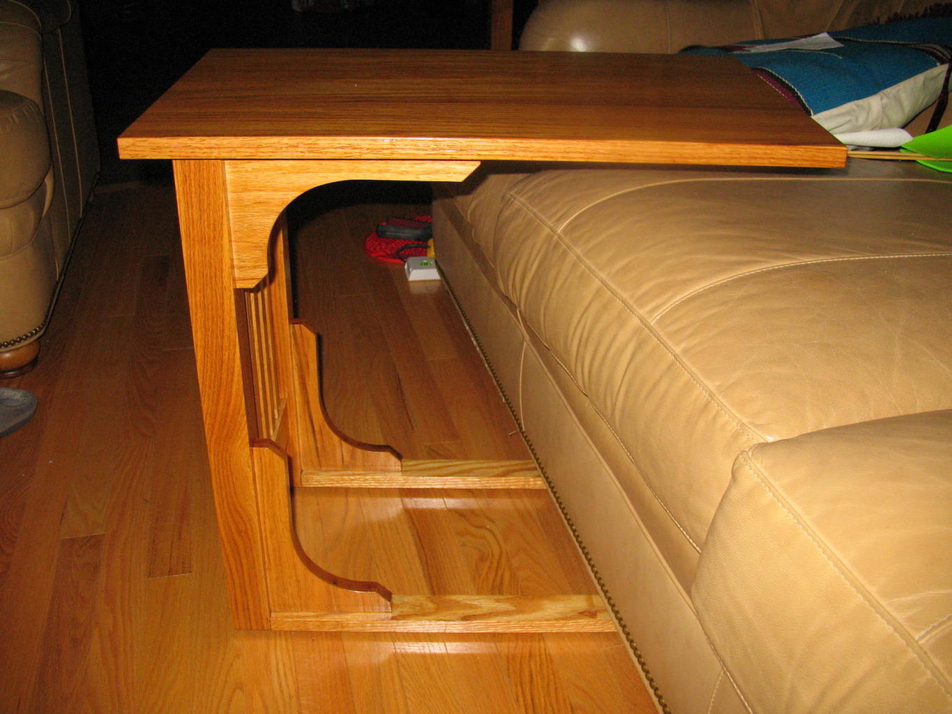

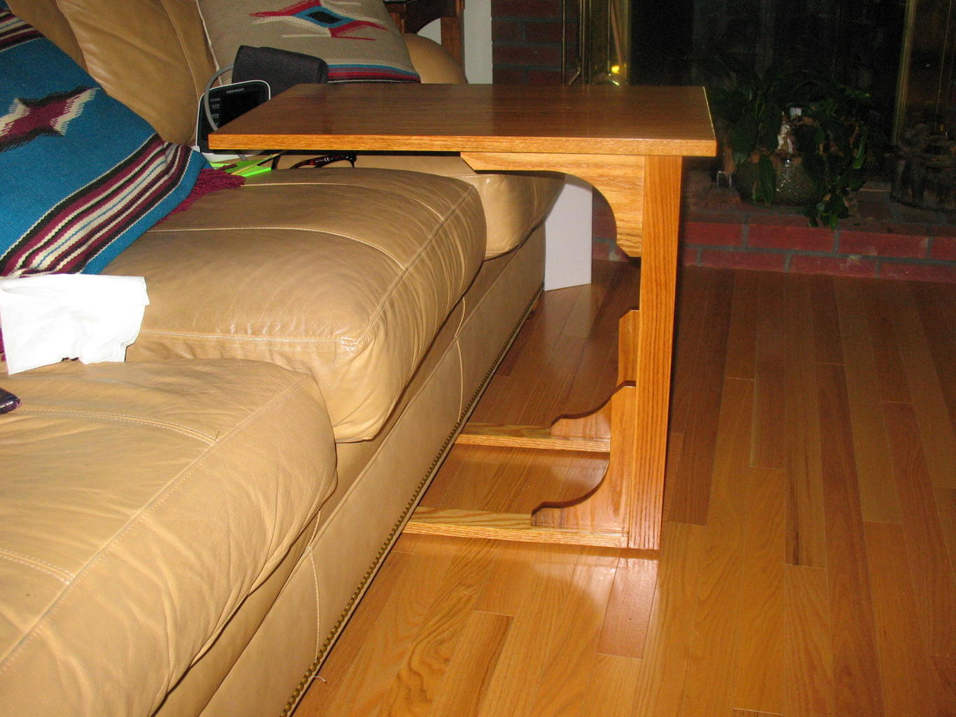

June 5, 20188 yr Author Popular Post comment_150960 Finished it. Decided to flatten by hand sanding, stain, oil based poly and not do a glass top. Report
June 5, 20188 yr comment_150964 44 minutes ago, Bdavep said: Hey that looks real good better than that... Report
June 6, 20188 yr comment_150974 Great job Jim...perfect finish for the "craftsman" era look. I like it...a lot! Thanks for sharing. Report
