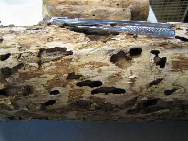

April 27, 20188 yr comment_147777 I have lived in Texas mesquite country most all my adult life and never heard of HONEY mesquite...I guess they are trying to glamorize the crapping stuff....! The word honey reminds me of something nice and kind and sweet but when ranchers and farmers spend all their life time trying to get rid of it, the word honey is probably never mentioned. I just hope they don't take some of the boarers from Texas to where you live...Around here the boarers can hear the chain saws start up and immediately go to it and as soon as the tree hits the ground they are on it. I hate to try and work with it for there is too much waste involved....and is usually priced up there or higher than walnut.... Sorry I didn't realize you were hunting out Gene so forget what I said....... I had six of these 2 foot long logs sitting outside the shop since last fall and was fixin to bring them in and put one in the lathe. Now I think I will use them to roast marsh mellows but the smell of those critters burning might keep a person from enjoying anything.... I will say what I have made over the years using mesquite the finish of my choice is to use 100% tung oil applied in three or four different applications...Boarers evidently do care for that taste!! Report
April 27, 20188 yr comment_147786 Tom, Honey mesquite is indeed a species of mesquite. It's a beautiful wood. Of course, IMO, all mesquite is beautiful. Honey carves easily with sharp tools. So, it should turn just fine. I have supplied a few local turners with pen blanks of Honey. They seemed to like it. Most of what I can obtain readily is the Velvet Mesquite. It grows a bit bigger than Honey. As to drying mesquite, I'd slice it into the thicknesses you think you'd want and let it dry under cover out doors. Keep it above the bare ground. Use concrete blocks. Then sticker with 2X2s. At least, that's how I do it. If left in the log, it likes to check or split. Honey is more prone to borers, but all mesquite has them. Especially, that found growing near water. I just think of the holes as design opportunities. Epoxy and crushed stone fills them nicely. Have fun with it. I do. Report
