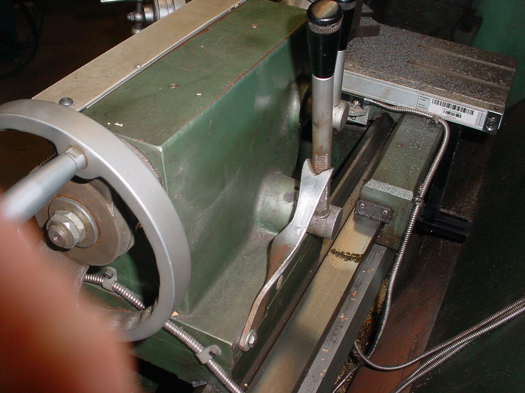

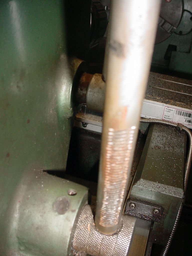

January 3, 20206 yr comment_214380 I has the problem on my metal lathe. My cam handle would back off when any pressure was on the front. My fix was to add a second handle that pushes on the first handle. I put groves on the first handle to keep my second handle from slipping. Report
