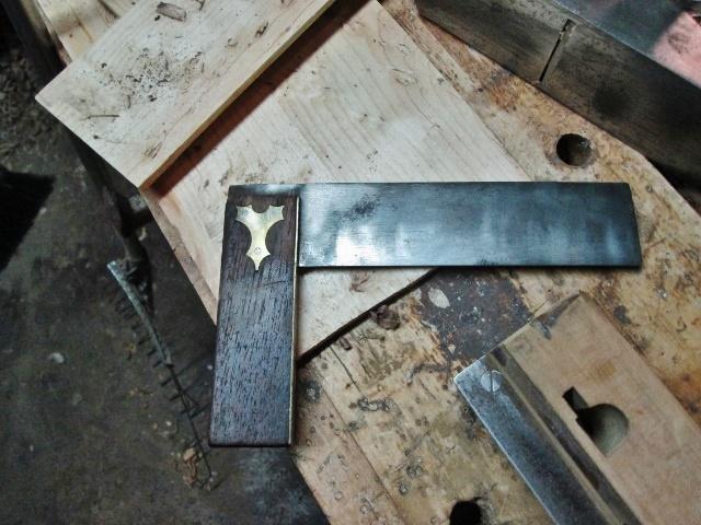

April 11, 20188 yr Author comment_146317 6 loads to the Firepit! found a framing square and another try square in the mess... Didn't have any thing to "roast" over the firepit....or anything to hold the hotdogs with....down to embers now.....tomorrow, I can haul another batch out...weather permitting. Tried a bit of rehab on that OLD plough plane.....made down in Cincinnati, OH back in the 60s......1860s that is. Tote was snapped off, might add a #5 tote for now. Needs a LONG screw to hold it. Going to take quite a bit of rehab.....may wait on it. Maybe I can start cutting finger joints for a box build? Right now? It is Gin & Tonic on ice time....stay tuned Report

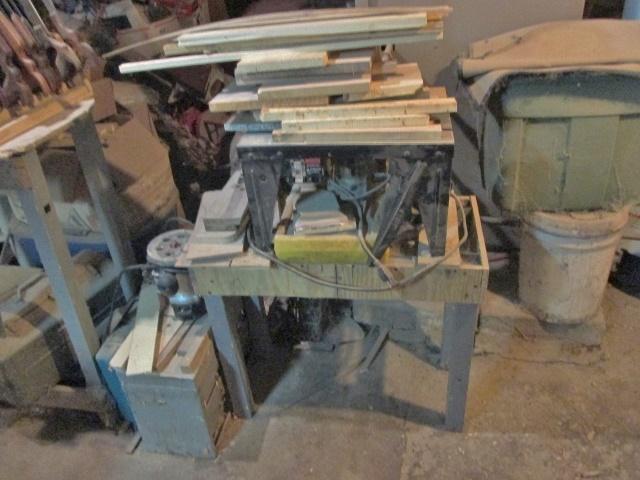

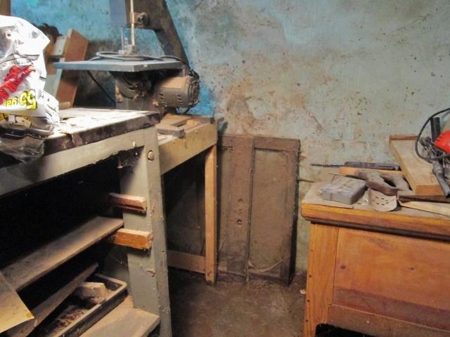

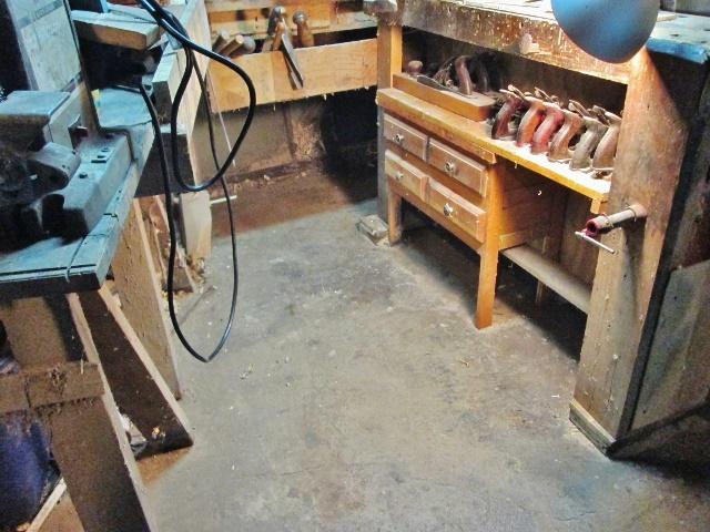

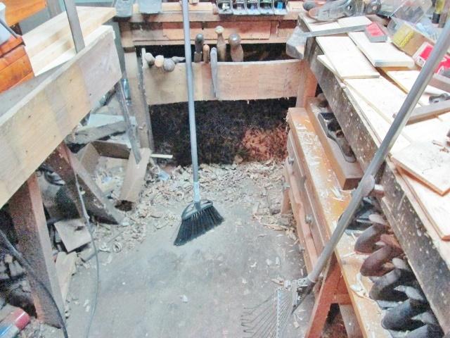

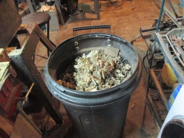

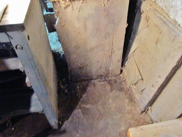

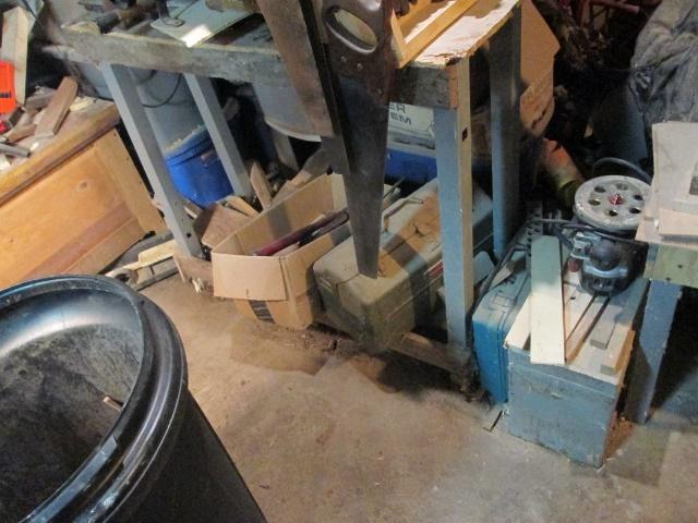

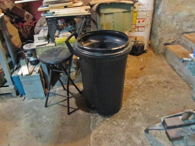

April 12, 20188 yr Author Popular Post comment_146414 Ok...back stiffened up, time to stop for the day. Corner has been cleaned out.. Old bandsaw then was stashed in there.. And, as soon as I can get this mess straightened out.. May add a shelf to the ex-lathe bench.. The thing that looks like a trash can? This is the Shop's Trashcan. I cleaned up a second try square, that was found buried in the mess.. Will post more on that plough plane, later... This is a "Before" shot...raked it out, swept it up.. Looks a tad better? Trash can? Too windy tonight, to burn...maybe tomorrow night? Can does have wheels, I can "roll" it right up the steps. I think that will do, for the clean up....maybe back to wood working later? Just imagine Joe Rockhold hosting the All night movie show....sponsored by Little Kings Cream Ale.....WHIO-TV Stay tuned....( I can hear the "clacking" of the TV's tuner.....) Report
April 12, 20188 yr comment_146417 I don't recognize the place, sure you will be able to work with that much extra space? Herb Report
April 12, 20188 yr comment_146421 Great job with the shop clean-up Steve. Now you have more room, and a few more tools that had disappeared over time. Report
April 12, 20188 yr comment_146423 Holy cow Steven...you'll need to build a new tool cabinet for all the treasures you've found on this scavenger hunt Good thing you've freed up all this extra space too with the new yard/garage sale season about to open. Who knows what treasures are waiting to be found. Report

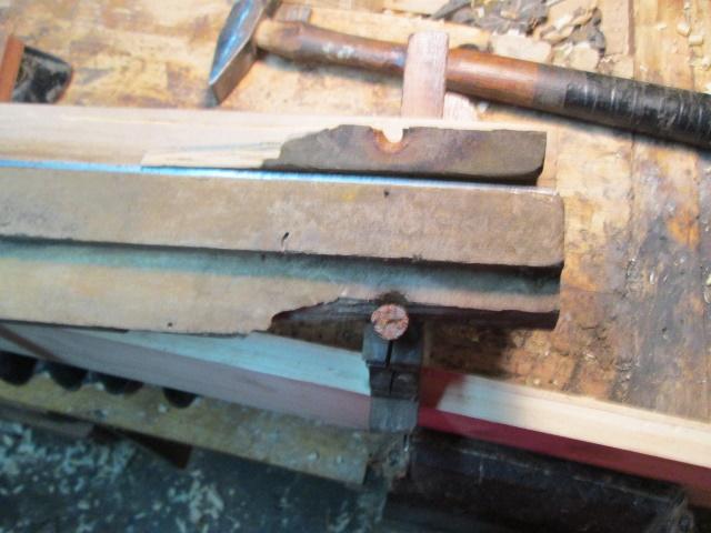

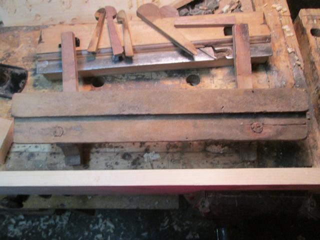

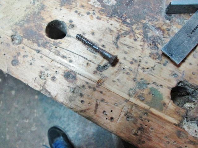

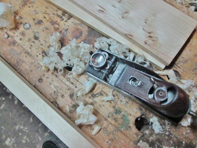

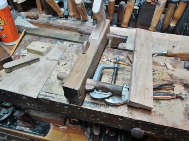

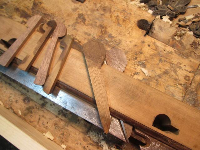

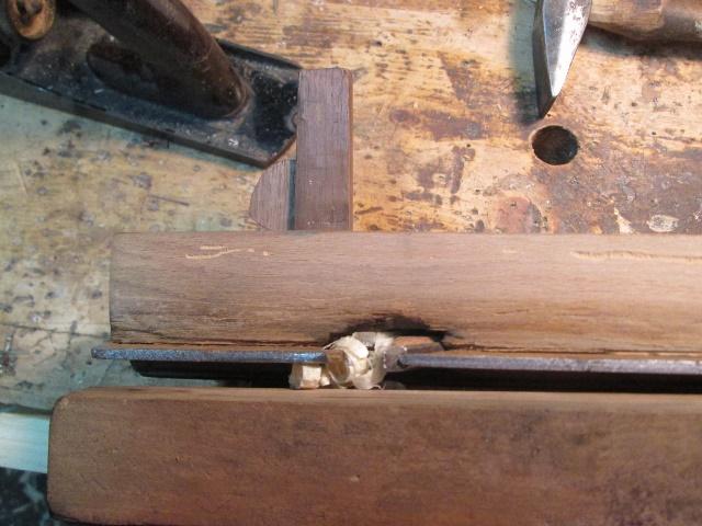

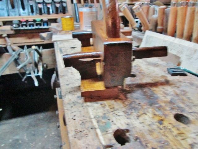

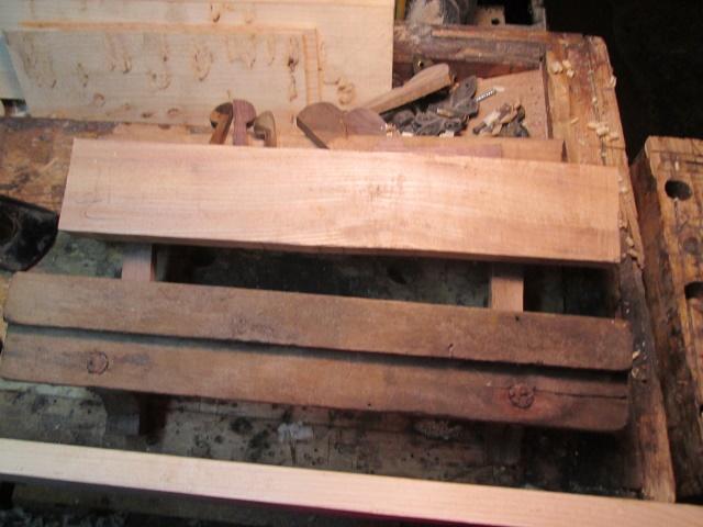

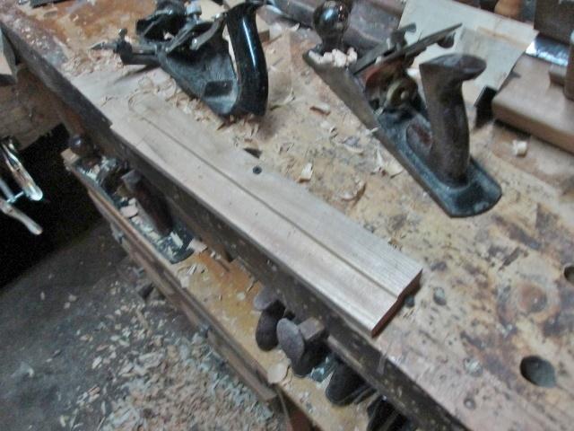

April 17, 20188 yr Author comment_146820 Computer and Internet issues....yep, it is Monday....took until Tuesday to get things fixed. In the midst of all the running around today...these two items came home. Along with a pack of sanding belts. Have plans for the belts.. the Trade-in block plane even made some shavings Need to also joint a couple edges for the Pine project. Made it easier to square at least one end of the long side pieces...haven't figured out how long they need to be..YET Couple of errands run..sneak back to the shop, BEFORE the next runs...old plough plane was getting in my way...parts were getting pushed around...decided to make their replacements.. New wedges, made from scraps of Walnut. Arms from the fence are "locked" in place via a couple wedges. I also made a new wedge for the cutter. Still need a bit of fine tuning. Fence was ....shot.. I did have a piece of Ash that might work.. Needed a bit of plane work, though. Planed the edges straight, planed the blank flat..or at least close...the split on the old fence finally gave way.. I could use the chunk to check the size of the blank's thickness....That screw is from about...1860...about time to retire it? Forgot how mean Ash is to plane...worse that Oak. The screw is there, because I got tired of chasing the blank around. Wards #78 did most of this work. The thick piece od Maple I found during the clean up? Drew a few lines on it.....bandsawed close to those lines...then went back and marked for thickness, and ripped about 3/16" off the side. Then had to plane the part to final thickness, and get it flat....the part? It is thick along the bottom edge, because it fits into a mortise in the plane's body. Know you know why I bought the sanding belts. Got home from yet more running around...had to fix the computer issues, and then the internet issues....even had to go to Wall E World again..and by a remote for the new monitor/TV. Grandson sent the monitor home..without any way to turn it on...not a single button to be found Then,while he was installing a new mouse..he lost the wireless plug-in for the keyboard...Found that....got things all up and running...then the Modem decides to take a break... Finally got going....had these pictures to process...Then do the write-ups. The old plough does make a shaving, though.. Just needs the rest to be fixed up. Visit to the Lung Doctor tuesday afternoon ( COPD) other than that? We'll see... Report

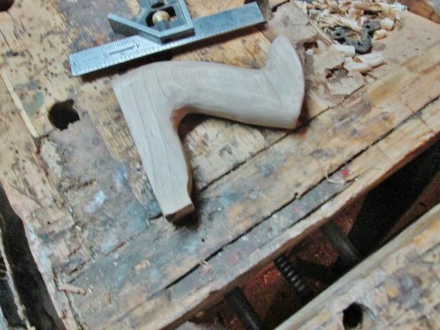

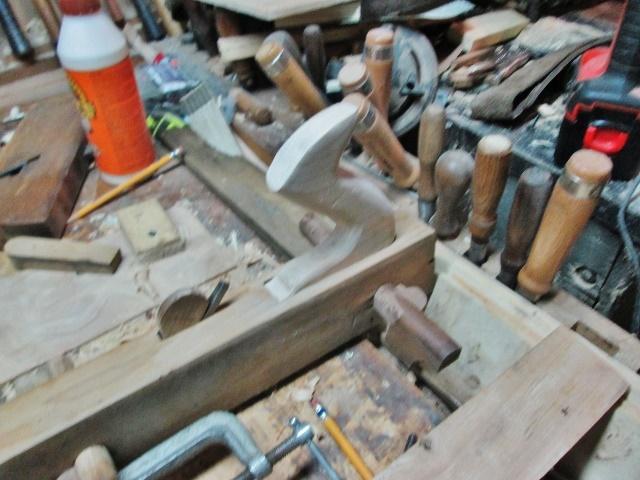

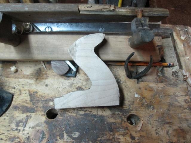

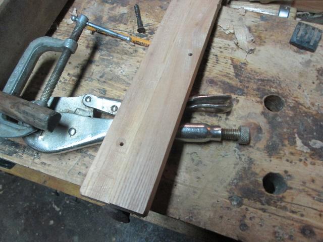

April 17, 20188 yr Author comment_146863 A little shop time, before the Lung Doctor's visit ( refilled the inhalers,....see ya in 3 months) meant I could at least shape the handle a bit.. No fancy tools...just the "Dragster" belt sander ( has a small front roller) and the palm sander...test fitted until it DID fit.. Snug, but not too tight. Used to be a dovetail joint the handle would slide into. Well, that was about all worn away. May add a screw through the toe of the handle...and a healthy coat of glue. One of the posts that connects the rods to the fence had cracked and broke off...cleaned it up, and re-glued it.. I also drilled and countersunk the new fence for the screws to attach to the rods... But the old screws will get retired.. Yep, they were made without a point way back then.....bought a pack of #10 screws to replace them. Hmmm....Maple handle, Ash fence, Walnut wedges..body of the plane is Beech....should be fun to do a finish....Have a little bit of Golden Oak left over, and the Amber shellac...Hmmm. IF you look closely beside the old screw...you might see a track left by the plough plane...as I was testing the wedge for the 1/4" cutter... may need to hone the cutter a might? Stay tuned... Report

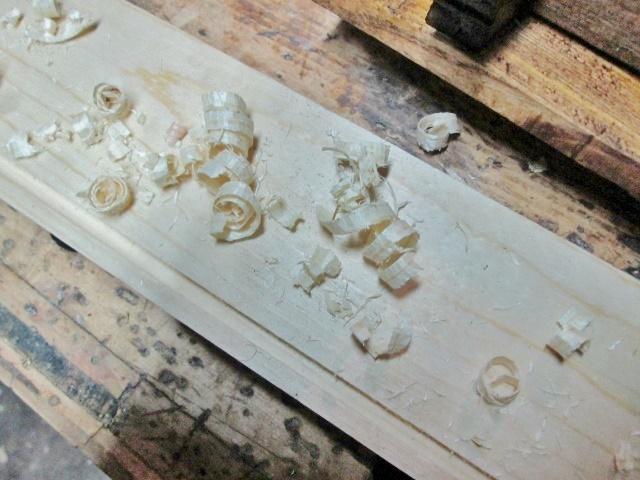

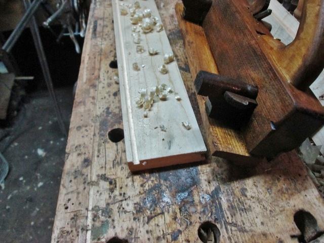

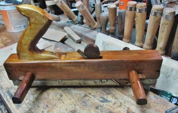

April 17, 20188 yr Author comment_146867 Not sure IF this is ready for the "Gallery" , yet...but... Went with a screw through the handle....don't trust just glue in this spot. Fence's arms are locked into place with a wedge. To loosen, you tap on the rounded end to slide it in. Tighten by driving the square end in. Tapered wedge, tapered slot. Set about a 1/4" in...there is no depth stop. Shavings curl up, and out the right hand side.. Makes some nice curlies.. Might get another coat or two....Golden Oak stain, and Amber Shellac. Wanted to get this off the bench, before the smaller parts started to walk away. Now, MAYBE..I can start on a box build.....? Report
April 17, 20188 yr comment_146869 6 minutes ago, steven newman said: Not sure IF this is ready for the "Gallery" , yet...but... But what??? OK, I'll let you get a couple more coats on before you post before & after pics in the gallery! Holy cow man, you have just resurrected something most folks would have tossed or spray painted and put on a shelf. You returned this into a working piece of art...Kudos and well done!! Report
