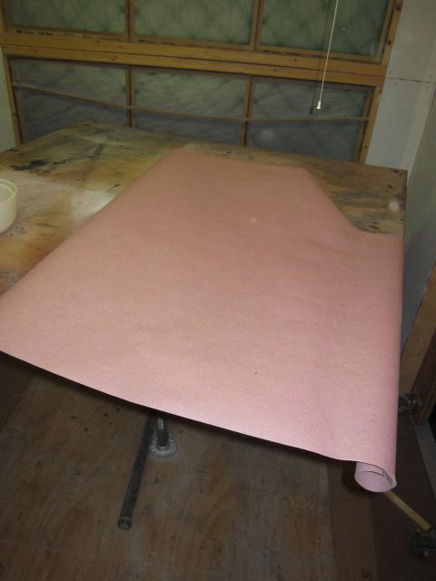

February 13, 20188 yr comment_140363 You get a large roll of paper, sometimes called "red rosin paper" or "builder's paper" to put underneath your finishing to catch drips and overspray. If you want to get really fancy, you can make a little roller to fit under the edge of your work table and/or a cutoff edge on the opposite edge (I'm not there yet). Another option, if you have a source is large cardboard boxes (think appliance boxes) that you can open up and lay on the floor to protect it from stripper, stain, solvents, and finishes (this I do have). Edited February 13, 20188 yr by kmealy Report

February 13, 20188 yr Author comment_140390 1 hour ago, Fred W. Hargis Jr said: Having a roll of rosin paper around is a must for shops, IMHO. It has all sorts of uses including the one you described. I've used it for patterns and for full-scale drawings. Good to catch glue drips on large panel glue ups. Right now, I'm putting finish on a 15 light door, each piece of glass has some taped on to keep the glaze and finish off. Put it on the floor for messy remodeling work (drywall, tiling, plumbing, etc.) What else, Fred? Report
