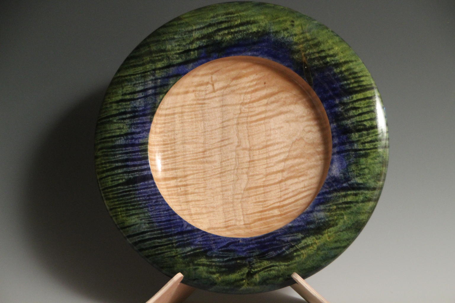

Gene I have not done it that way . In woodturning several big name turners do a alcohol base dye in layers. Start with a dark color sand it partly off an then and another color and can repeat again. The effect is that it highlights the grain and makes for spectacular effects in the shifted colors.
Jimmy Clewes Colored Rim Platter dying starts at about 48 minutes in.
That's pretty cool. I'll have to give that a try. Wonder if it'll work on the lathe?

Guess @Gerald answered my question!
Edited by lew
That's really pretty, Gerald.
