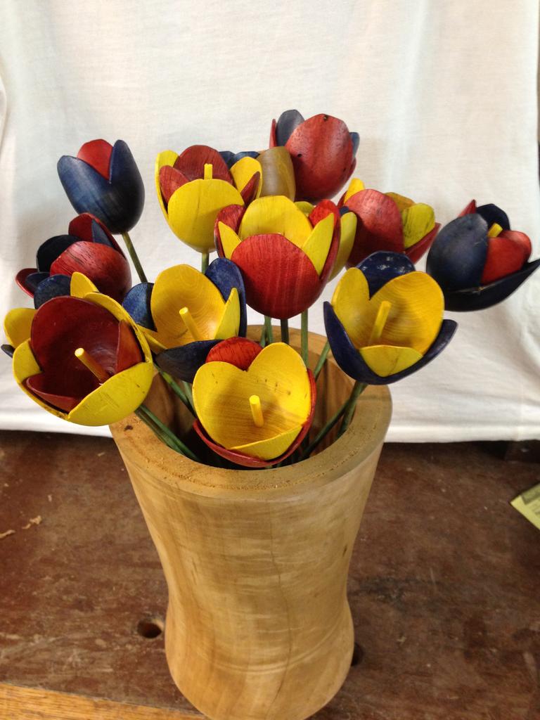

Gerald Posted February 7, 2018 Report Posted February 7, 2018 I have that one dedicated to spraying dye. Works well but like DAB said make a well so you can sit it down safely.I mounted a block with 2 sizes of hole on the side of my finishing table. Also put a hook on it to wrap the hose , with the regulator also mounted to the side of the table lew, HARO50, Grandpadave52 and 1 other 4 Quote
DRAGON1 Posted February 10, 2018 Report Posted February 10, 2018 On 2/7/2018 at 2:58 PM, Gerald said: I have that one dedicated to spraying dye. Works well but like DAB said make a well so you can sit it down safely.I mounted a block with 2 sizes of hole on the side of my finishing table. Also put a hook on it to wrap the hose , with the regulator also mounted to the side of the table what types of dye do you use? type and names? lew 1 Quote
Popular Post Gerald Posted February 10, 2018 Popular Post Report Posted February 10, 2018 (edited) I have only used Chestnut Stains in it so far and the results have been very effective. It is alcohol base so clean up is easy especially since there is no needle to clean. In addition this type is very effective for finish coats of lacquer and again easy cleanup. If I need fine control I use a Harbor Freight that has better controls. I do not do any drawing with them so the more expensive types have never appealed to me. Edited February 10, 2018 by Gerald lew, Grandpadave52, Cal and 2 others 5 Quote
Grandpadave52 Posted February 10, 2018 Report Posted February 10, 2018 @Gerald...those tulips are really cool...sometime in your spare time, a thread on "here's how I dunnit" would be humbly appreciated. Cal, HARO50 and Gerald 2 1 Quote

Gerald Posted February 19, 2018 Report Posted February 19, 2018 On 2/9/2018 at 9:07 PM, DRAGON1 said: what types of dye do you use? type and names? I missed your question. The stain (dye) on these pieces is Chestnut Stains: yellow, royal blue, red. I got some Chromacraft dyes branded Nick Agar at TAW last month in Magenta, Teal and Violet so I would not have to mix colors to get something else. Thde Chestnut stains colors cover the basic colors so I can mix for most colors. Have been using a color wheel I printed of he internet but just ordered one on Amazon and it is pretty cool. All of these are alcohol base as it is easier to use and only causes a problem if finish is shellac. Oh by the way the Chestnut stains actually have shellac in them. HARO50, Cal and Grandpadave52 3 Quote
Dadio Posted February 19, 2018 Report Posted February 19, 2018 Gerald, you mean you made those tulips?????? WOW what you guys do on those lathes. I have never used an air brush, what kind of compressor is required? will the regular shop compressor work ? Herb Gerald 1 Quote
