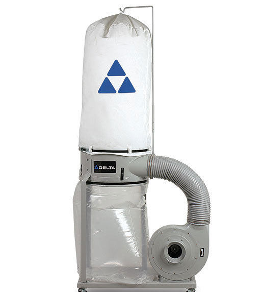

I'm no expert (and don't even play one on TV) but it is my understanding that it increases the efficiency of the cyclone effect. It sort of acts as a diverter directing- and keeping- the heavier stuff in the barrel. I have a Delta dust collector
The plastic bag only gets emptied about once a year and then it may only have a few inches of very fine dust in it.
