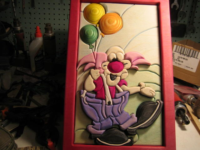

  I started with a pattern of a clown then glued it on some wood then cut it out..  But before I start I attach a piece of Baltic Birch plywood to the back of the wood so I have a place after all the pieces are cut out to rebuild the picture in. Kind of a box to glue all the pieces back together whether they are the original pieces or different woods of different color.. I use the piece of wood as a pattern to trace around of a different species, lighter or darker wood to go with the theme of the picture.. Trace around the piece of wood to be replaced and once you learn where to cut the new pieces whether it be on the line , inside the line  or out from the line the new colored wood will lay right in where the old piece use to fit...eventually you can do away with much sanding to make a good fit...

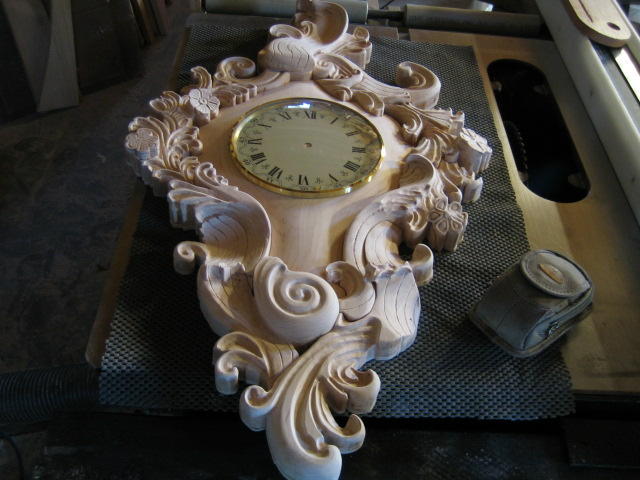

  Actually I do this carving on these clocks the same way as I do my form of intasia, which I don't do the same as other folks.IMG_9646.JPG.63bc98398194cc1b28c178c5ff3c7097.JPG
I cut the carving down into smaller pieces  and use a backer board the total size of the clock so I can glue it all back together as one piece after the carving, the staining and the clear is sprayed on then I can glue it all back together...I find I am more pleased making clocks like this than the so called intarsia pictures?  I was just getting in to carving some of the intarsia pieces when I decided the clocks wold be the way to go...

Wayne, I never use paint, never. The clown was stained with printers ink, home printers like the one I have sitting beside me... Water soluble and a person can thin it as he wishes.  These colors were fairly strong for I wanted the clown to be seen.... Anyway there for a few years maybe 15 or 20 years ago there appeared on the market a quick and easy refill kits for the home printers. Buying it from the makers of the printers was very high priced and for sure the ink is still way to high but    anyway, about all those cheap kits did was clog up the printers and what was left the people added to garage sales to recoup some of their expenses.. This was about when wife and I would take a list with us and make lots of garage sales on Fri and Sat....Water color sets for kids is another  good garage sale item after the kids leave home and in goes the water color kits. A 4 oz. bottle of printers ink will put a stain on the white house for it last and last...
