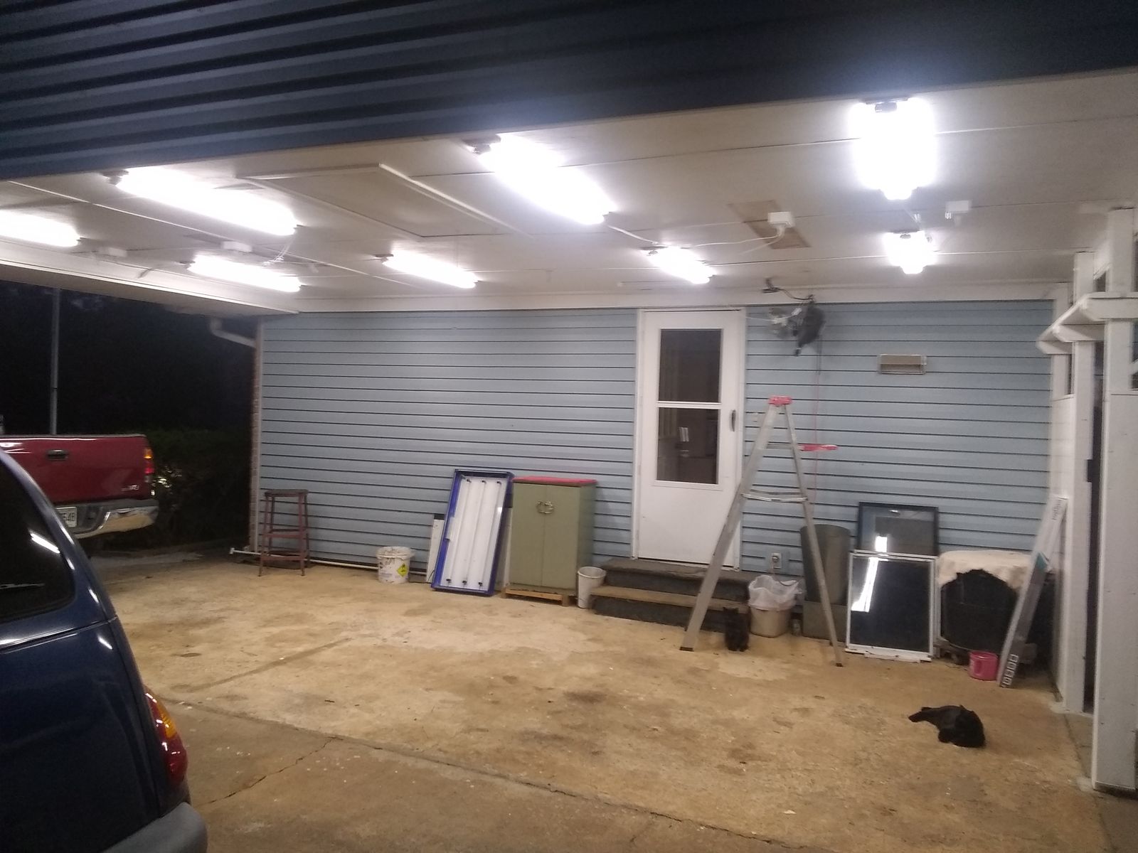

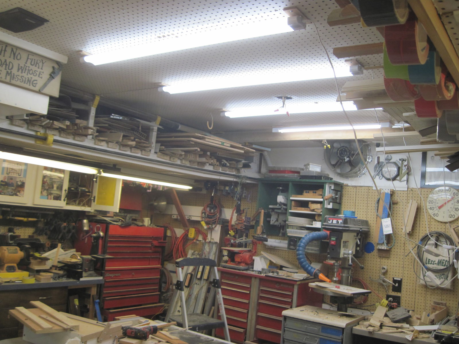

To see how I might like them I converted two 4 foot light fixtures.  Got rid of the ballast and went with single ended bulbs.  They were okay but tended to shed a lot of shadows above 6 feet.  I have a lot of cabinet and shelves so this was a small issue, but one I didn't have with the Florescent bulbs.  Wiring wise I already used end plugs for each fixture that went to an outlet in the ceiling.  So little conversion  work as @Artie pointed out.  Others might have direct wired them in and then had to decide how to work with that.  When I saw the cheaper fixtures all LED come out I again did a few and was much more impressed.  As before all the outlets in the ceiling are in place I only had to cut the cord to length and put my own ends on.  Easy enough.
So from my experience in the shop the cheaper fixtures are better for light.  Now how long they last remains to be seen.  The original florescent drop in fixtures are still in use in my utility building and doing well.
 These are some of the shop lights.
This is 8 of the 4 ft LED fixtures under my carport.
In the bottom picture I see the snoopervisor examining your work.
