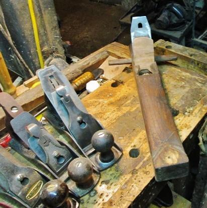

Some have already seen this plane til....those block planes across the top?
Are the main users.  Half are low angle ones.
Some of the "special" planes.   The old block plane is great for knocking off excess dried glue..
There is one thing about these wood bodied planes...they weigh a bit less than the iron versions.  That  red jack?   That is my "scrub" plane.
The Big Guys.  The Millers Falls #14 because it is used as a big smooth plane.   A #8, another #7, and a #81 try plane.   You need your Wheaties, before a full day of moving these around.....
Somewhere in the shop, there is a third spokeshave.....I tend to treat them as planes.    The #45....7 planes in one.
IF anyone wants to see what is on that shelf.....I might bring them out into the daylight.    Depending on the project, there are 6 or 7 planes that always seem to get used.....
Depending on the size of the project....some will get swapped  out for another size.   The #7 may turn into a #6, or a #5-1/2.    The #4 may get changed out to a #3 size.    That #5  may get replaced by the 5-1/4  as a jack.   The #5 has a bit of camber to the edge of the iron, the 5-1/4 does not.    After a long day of pushing planes around...smaller ones tend to come out....old arms tend to get tired.

Block plane is a Handyman.   From the top?  Anant A4,   Dunlap #3 ...Craftsman#3 (Millers Falls #8 made for Sears)  And the Mohawk-Shelburne#4.( later renamed as a Millers Falls #900)   and one more....but it is a little too big for this spot...
A "China Jack"  2" double ironed Jack plane.
Takes a whole nother style of grip, to get it to  work.   Traditional Chinese Jack plane made in.....my shop.:o
I think that is it.....depending on the next rust hunt...:rolleyes:
