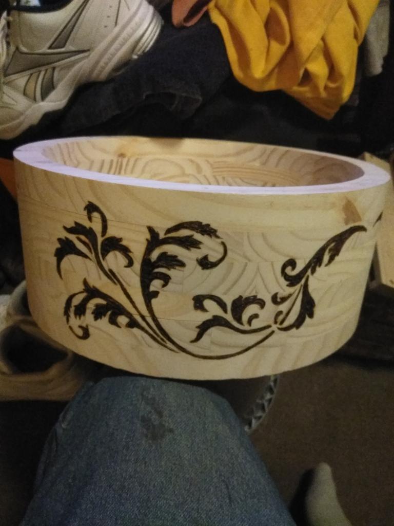

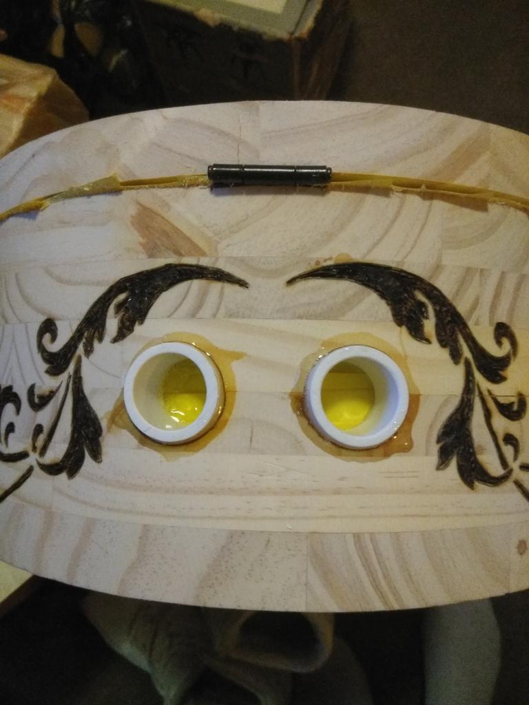

December 11, 20178 yr Popular Post comment_133895 Who says you need a shop to make a bowl? These are the first pictures of a yarn bowl i'm doing for my daughter. More to come!!!!!! Report

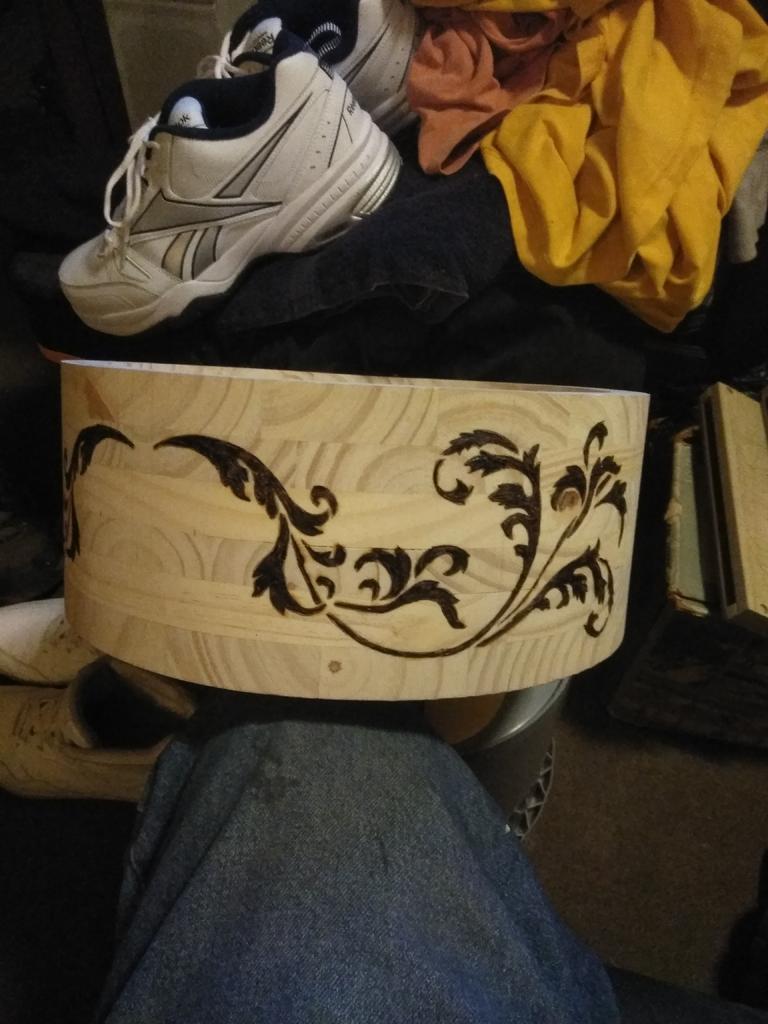

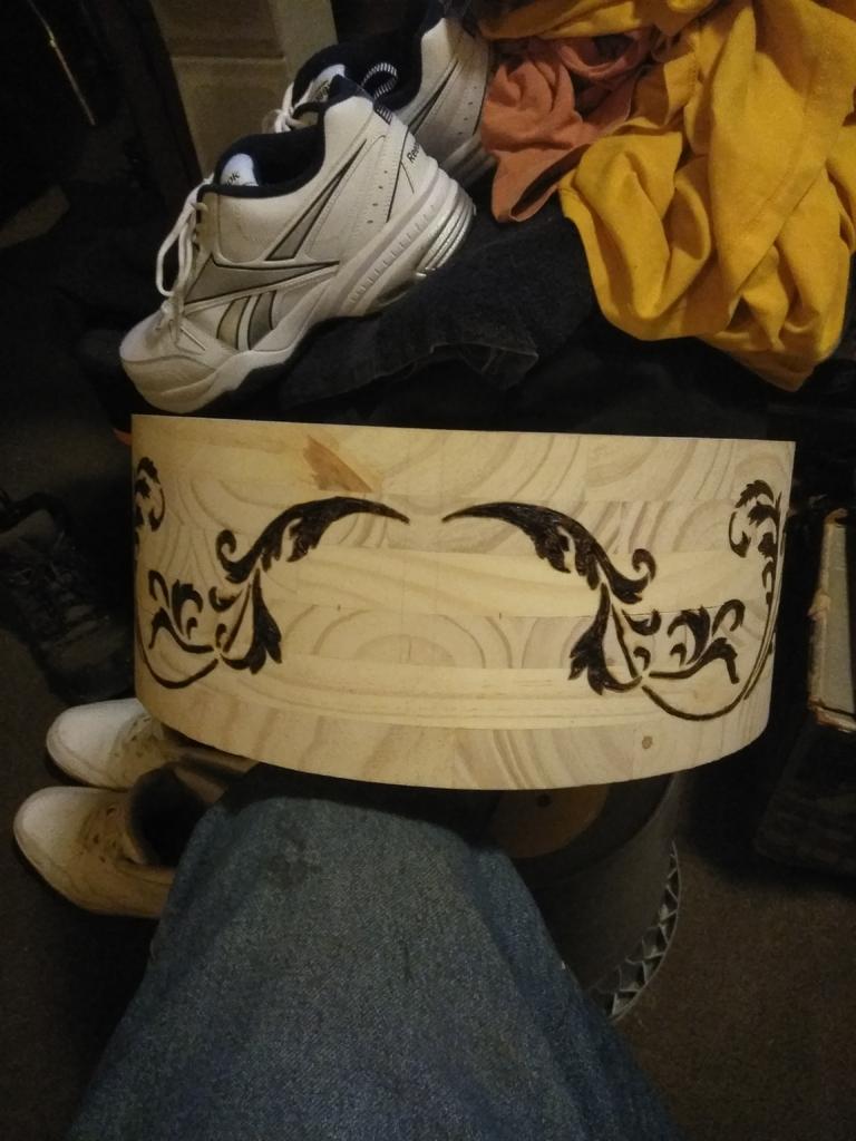

December 15, 20178 yr Author Popular Post comment_134111 Wood burner pattern on outside of bowl. Report
December 15, 20178 yr comment_134114 That is one fantastic burn. Wish I could do half that good Report
December 15, 20178 yr comment_134137 I like that real well... Everyone has a head full of ideas but only a few knows how to bring them to life. If it were mine I would finish it with a can of clear. There are lots of brands and types of clear, but first I would try it on some pieces of wood to get the feel of how much to spray and how close to hold the can while spraying....And I would sand the sharp top edges down before spraying. Gives it a good feel. And if it were mine I would rub it down with 0000 steel wool and Johnson's paste wax. But it ain't mine. But if it were mine and I had my name on it I would sure want to do that. Edited December 15, 20178 yr by Smallpatch Report

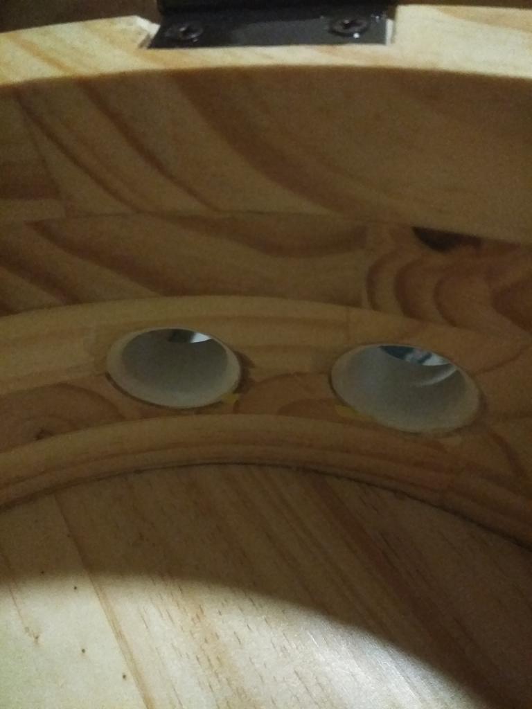

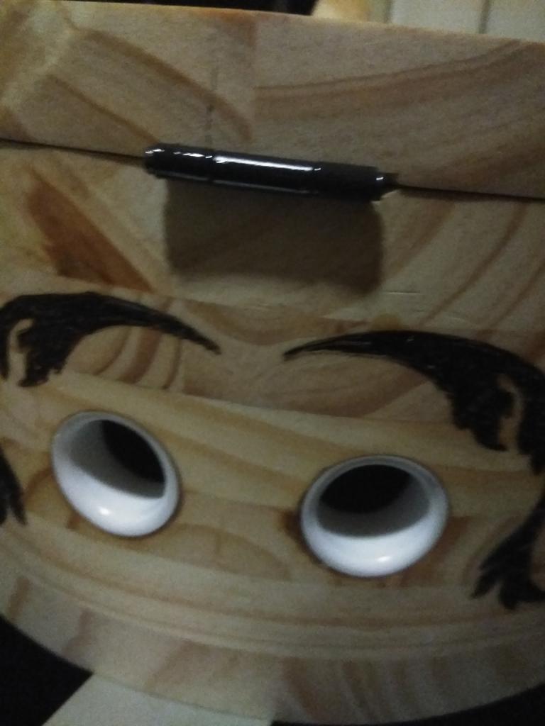

December 15, 20178 yr Author comment_134151 Good ideas small patch. I have to make the insides super smooth so it won't catch the yarn. Especially the two holes I have to drill through the sides for the yarn!!! Report
December 15, 20178 yr comment_134152 Mike I use lacquer but you can get shellac, enamel , or other clear stuff to shoot. I like lacquer cause I can recoat faster then after a few coats with like 400 grit sand paper between coats then I like to use 0000 steel wool and Johnson's after the last coat. You might add some to the inside of the hole also. I understand yarn will catch on lots of small things.. Report
December 16, 20178 yr Author comment_134242 On 12/14/2017 at 11:41 PM, Gerald said: That is one fantastic burn. Wish I could do half that good Gerald, what kind of wood burning tool are you using? Report
December 16, 20178 yr comment_134251 I have a Burnmaster Hawk. I have used it for some embellishment on turnings and for signing my work. Report
December 17, 20178 yr Author comment_134265 5 hours ago, Gerald said: I have a Burnmaster Hawk. I have used it for some embellishment on turnings and for signing my work. I've got the burnmaster eagle, 2 pens. I use a round point and a knife edge tip. It takes awhile to get the technique down, along with ALOT of expermenting ( high/low heat) tips and drawing speed. Report

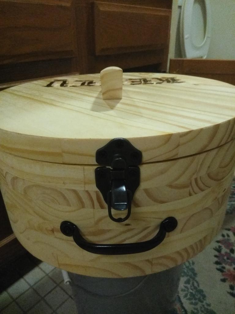

December 21, 20178 yr Author Popular Post comment_134623 Side handle, clasp to keep it closed while carrying... A couple more coats of clear with 220 in between and it'll be ready for Christmas!!! Report
December 21, 20178 yr comment_134677 Mike, you forgot the swivel wheels. Those ladies close by will be knocking your door down for orders. Report
