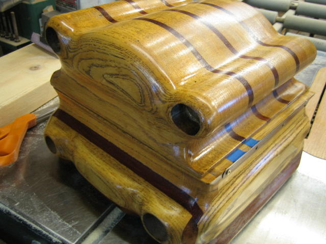

December 3, 20178 yr comment_133093 I couldn't find any hinges then misplaced the lid when I started putting the 100 % Tung oil on. And it has sat there looking heart broken and dejected ever since. I still can't figure out what or why I had started building it! I finally asked the one who knows everything and she said she had requested a tape dispenser like the one I built for me... Edited December 3, 20178 yr by Smallpatch Report

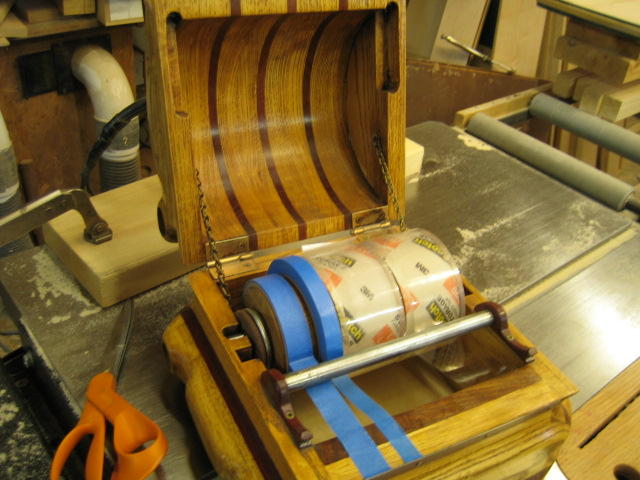

December 3, 20178 yr comment_133108 1 hour ago, clhyer said: So, does that keep your tape clean and handy? Cal YOU SHORE YOU AINT GONNA HEAT & HATCH QUAIL EGGS IN THERE????????????? Report
December 3, 20178 yr comment_133115 Looks like it would hold a passel of tape. You can get passel quantities on Amazon. Report

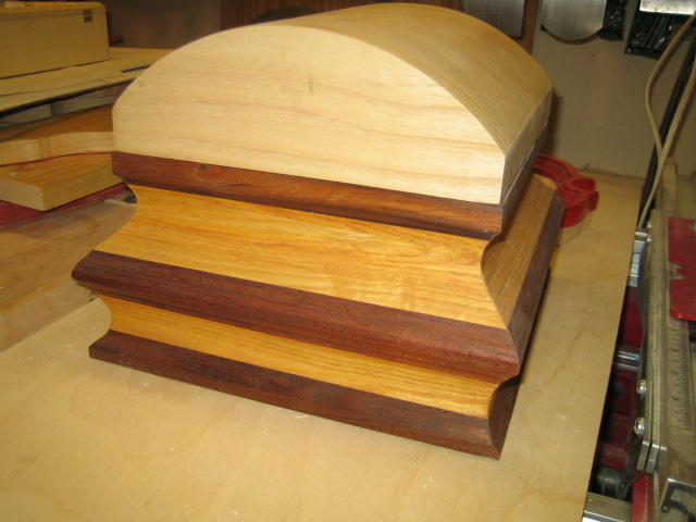

December 3, 20178 yr comment_133124 Hey Jess, what type of wood are you using, how did you make those fancy coves and how did you make the arch in the top, I love it! Report

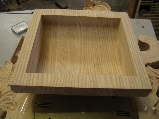

December 3, 20178 yr Author comment_133183 To start with, the wood is ash and walnut. To those of you that uses 100 % Tung oil knows this is one of the very best products on the market and you also know it will turn light wood a good looking what ever color it happens to be. I could not find the top when I was putting the Tung oil on the reason there is a color difference. The box is 10 x 10 x 8" tall. I built a square box using ash then attached square walnut 1 x 1" strips where ever. I used bottom cutting bits like what the Legacy Mill uses. They are big and expensive and Magnate builds them. I think I strapped the box under an overhead router I converted from an old Wards overhead saw to get the looks I was after. Or I used the Legacy Mill, been too long ago to remember. Best way I have found to make the two different woods look professionally built and attached. And the miters always looks good..... That is a sharpened hacksaw blade on the front. I think it is amazing that the tapes have the same inside diameter since they are different companies that made them. Yes , the sides of the tape is always clean after I built this thing. The holes are there to make people scratch their heads. Report
December 3, 20178 yr Author comment_133192 Something I forgot but as you have already surmised I didn't put the ends on the top until I cut a few pieces with the band saw then glued them together and sanded them, then glued the ends on to complete the top then sanded it all flat.... Report
