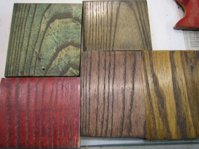

November 1, 20179 yr comment_129895 Michael in the future if you are trying for a certain look when building something you might think of buying ash , white ash is so good to work with saw blades or router bits or other tools but where I like it is when it is time to put a finish on the wood.....it is so easy to do what ever one wants to do with it. All these samples are of ash. Then I have some with white grain, green and a few other wild combinations. Or like in the long pieces, make your own grain and matching wood close to the grain and leave the rest a completely different color.. So the first thing to do is try what you are wanting to achieve on some practice boards and with the right wood. Or when things you make are going to the kids, I decided to make the wood different for everybody. Report
