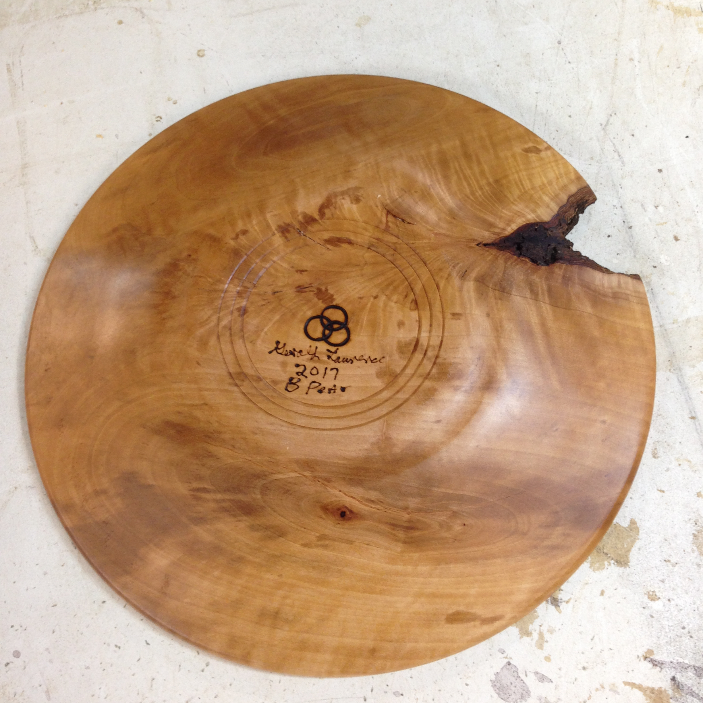

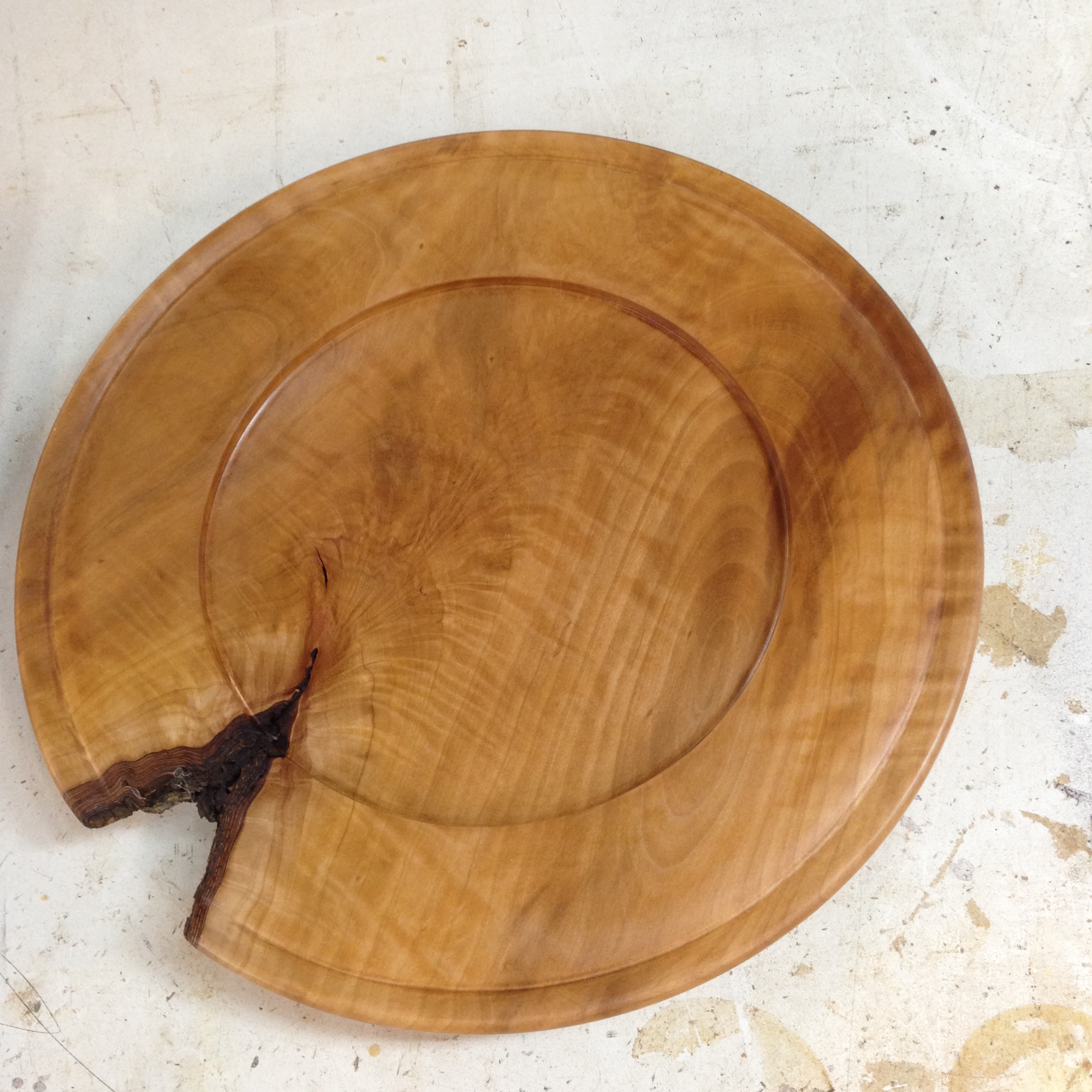

Here is the finish. Used Watco then Beall buffIMG_1332.thumb.JPG.5cc4ba3284ca971be06b1e9e38b5ae30.JPGIMG_1333.thumb.JPG.d3f696b1898c5964f8c5a537811540ce.JPG
That is a beautiful piece and the finish really shows the grain. Nicely done!
Steve
Whoee Gerald.  That's really nice.  Your finish brought out the feathers and the other grain without any interference.
Beautiful!
Cal
To me....   that piece explains why I turn.  Love it.
Awesome.
