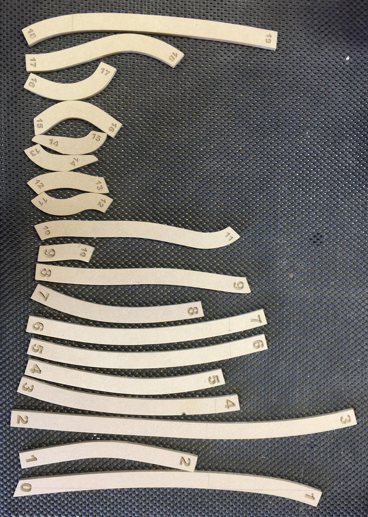

October 17, 20179 yr Author comment_128334 I used my Aspire CNC software for design and to make the marking templates for the head shape. Report

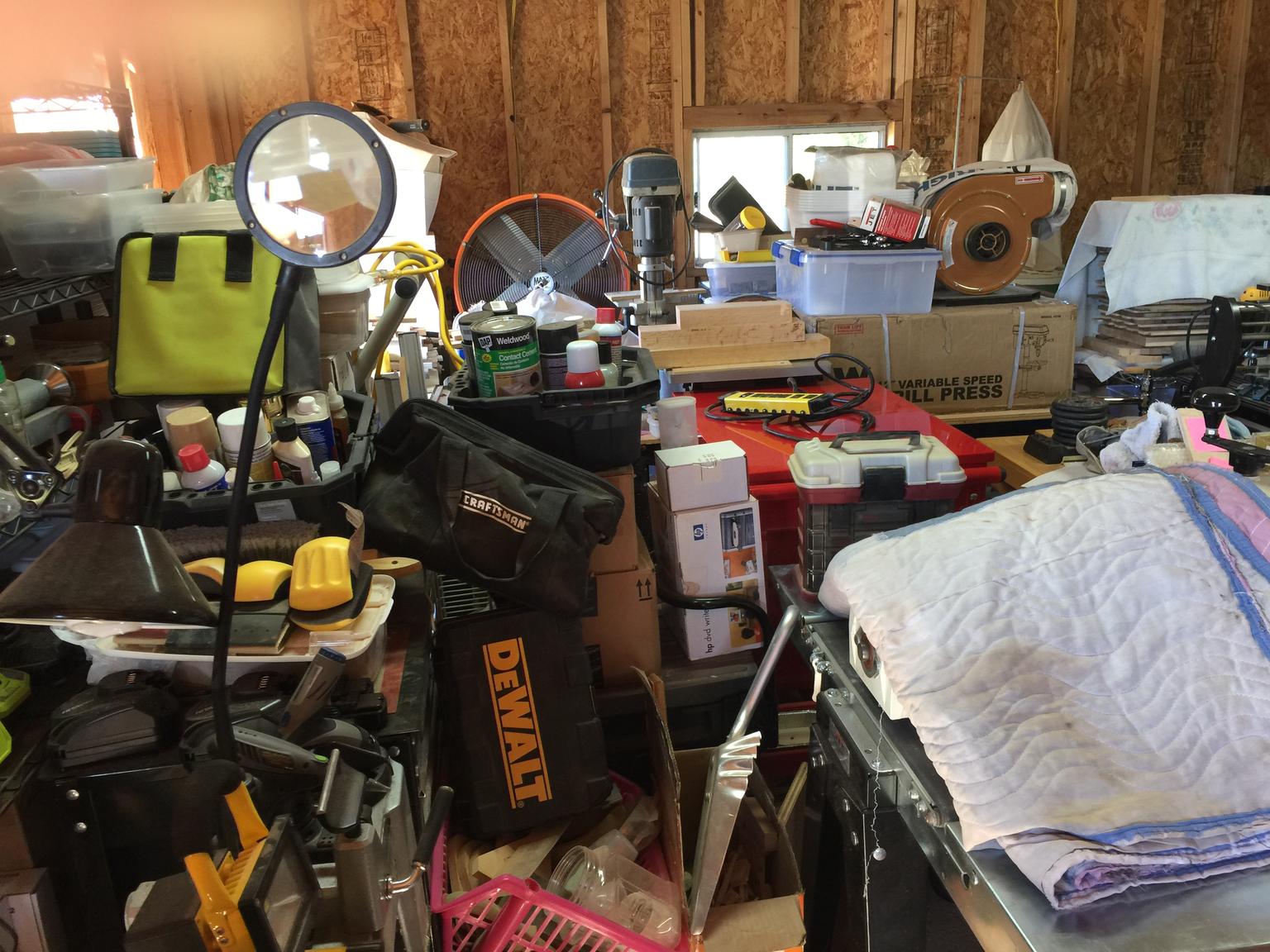

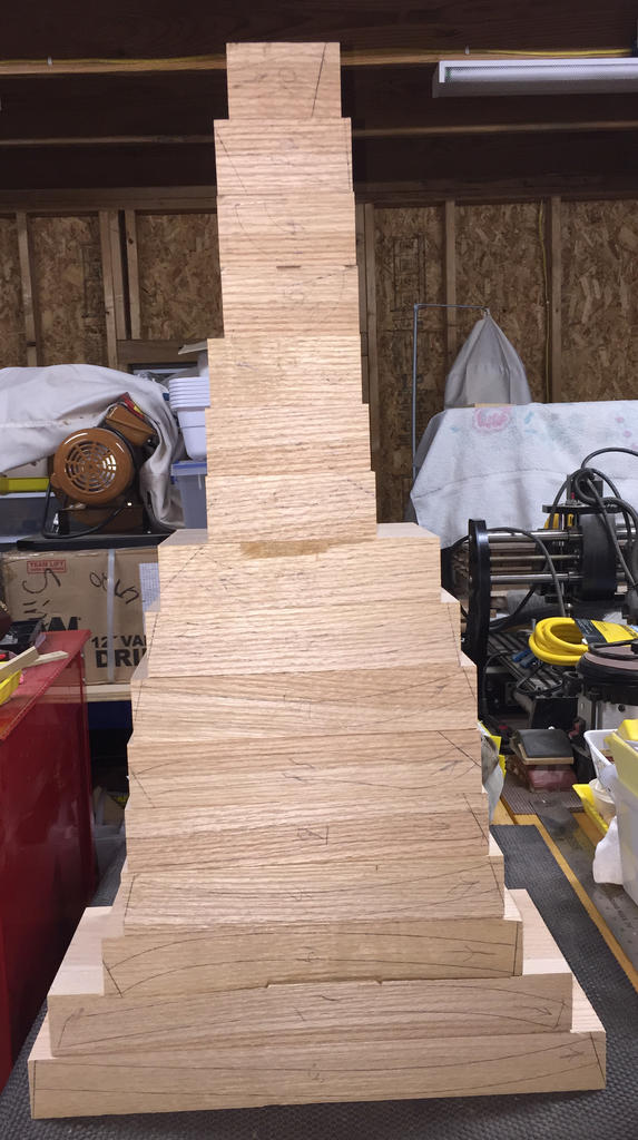

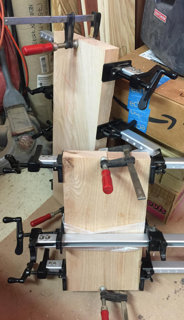

October 18, 20179 yr Author comment_128528 I looked at using two 3/8" layers of bendable plywood but the minimum radius is listed as 12" so I would have to do a lot of modifications the the plywood and then I would have to come back and veneer the outside and inside and hardwood cap the face to cover the joint. I opted to use solid wood. I'll have to cut the head parts in pieces and also because my band saw is limited to a 6" cut i'll have to cut 2 of each part and glue them together. I started with a 8/4 x 12" x 11' red oak board. This was enough to get 16 of the 19 head part blanks from with out glue ups at this point. Had to stop and align the tables on a new Dewalt DW735 planer so that's one less thing on my to do list. Then I got 2 glue ups done for the remaining 3 shapes and a jig glued up to use on the band saw. At this point I had to stop and move a few things around the shop so I could get to the band saw (did I say I don't have room to move around in my shop). I was in the process of getting it setup again (had not been used in about a year) and got a call from one of my other customers that had problems with his CNC (bit buried in the material and the controller program locked up on him) had to drop everything and go to his shop. Got him back up and running and didn't get back home until about 8:00 PM. Report
