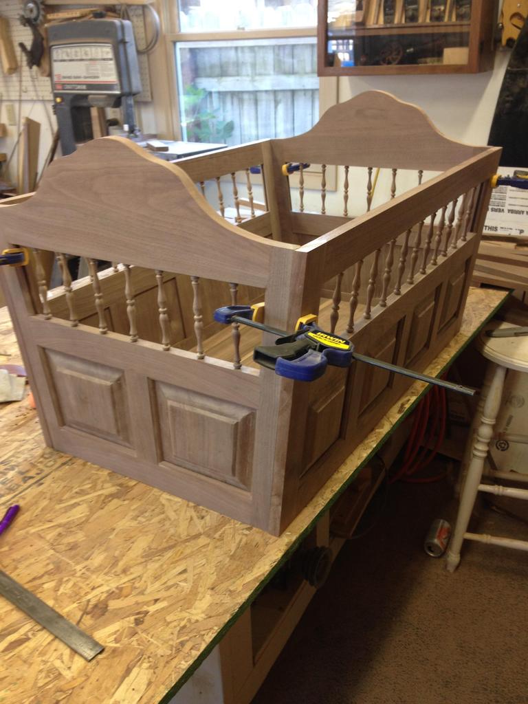

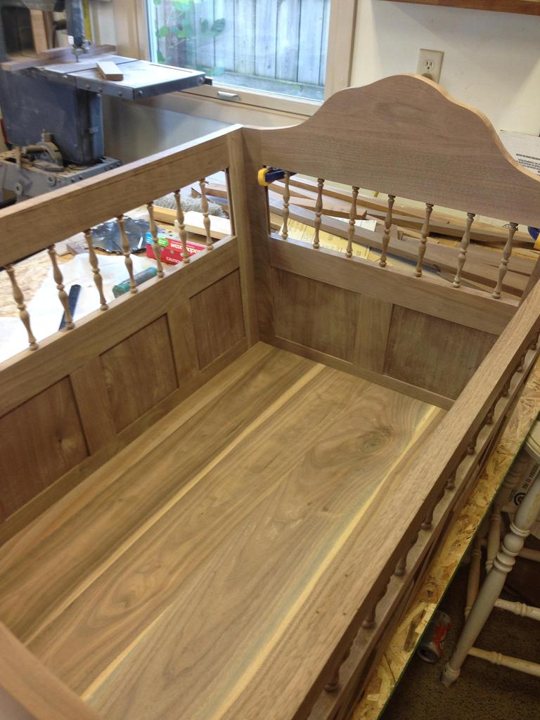

September 30, 20179 yr Popular Post comment_126499 Well, I am one week into a cradle build for a customer. He bought a cradle about 25 years ago and wanted it replicated. Thanks to the guys that noticed in the photos that the spindles in the original cradle were too far apart and didn't meet federal standards. After I took this photo, I added trim strips in the stile grooves. Hopefully, tomorrow I can finish sand this thing and get it glued together. As a point of discussion, the bottom is 1/2" walnut and I cut a dado in the end panels. Under the bottom I'll add a cleat all around the underneath side of the bottom. My OCD side kicked in and I added dowels to each rail on the sides for strength. Report
September 30, 20179 yr Author comment_126503 5 minutes ago, lew said: That IS nice! Did you turn the spindles yourself?? No. I bought them from a company in Canada. I bought them cheaper than I could turn them and they came sanded. Winner, winner chicken dinner! Report
September 30, 20179 yr comment_126505 Beautiful Ron. The panels and spindle selection speak craftsmanship and elegance. Report
September 30, 20179 yr comment_126517 that is beautiful Ron, won't be long til there are little teeth marks in those rails. Herb Report
September 30, 20179 yr comment_126518 Oh my!!!!!!! My goodness Ron that is absolutely beautiful! Craftsmanship and life long quality is just coming out of that work like no body's business. I am taken back actually, it's beautiful Ron! Report
September 30, 20179 yr comment_126534 That looks superb Ron. What type of finish will you use? Final pics after the finish is applied are mandatory! Cal Report
September 30, 20179 yr Author comment_126541 1 hour ago, Fred W. Hargis Jr said: Well done! Will that have rockers on the bottom? No Fred, it will be a suspend cradle from a frame. Report
