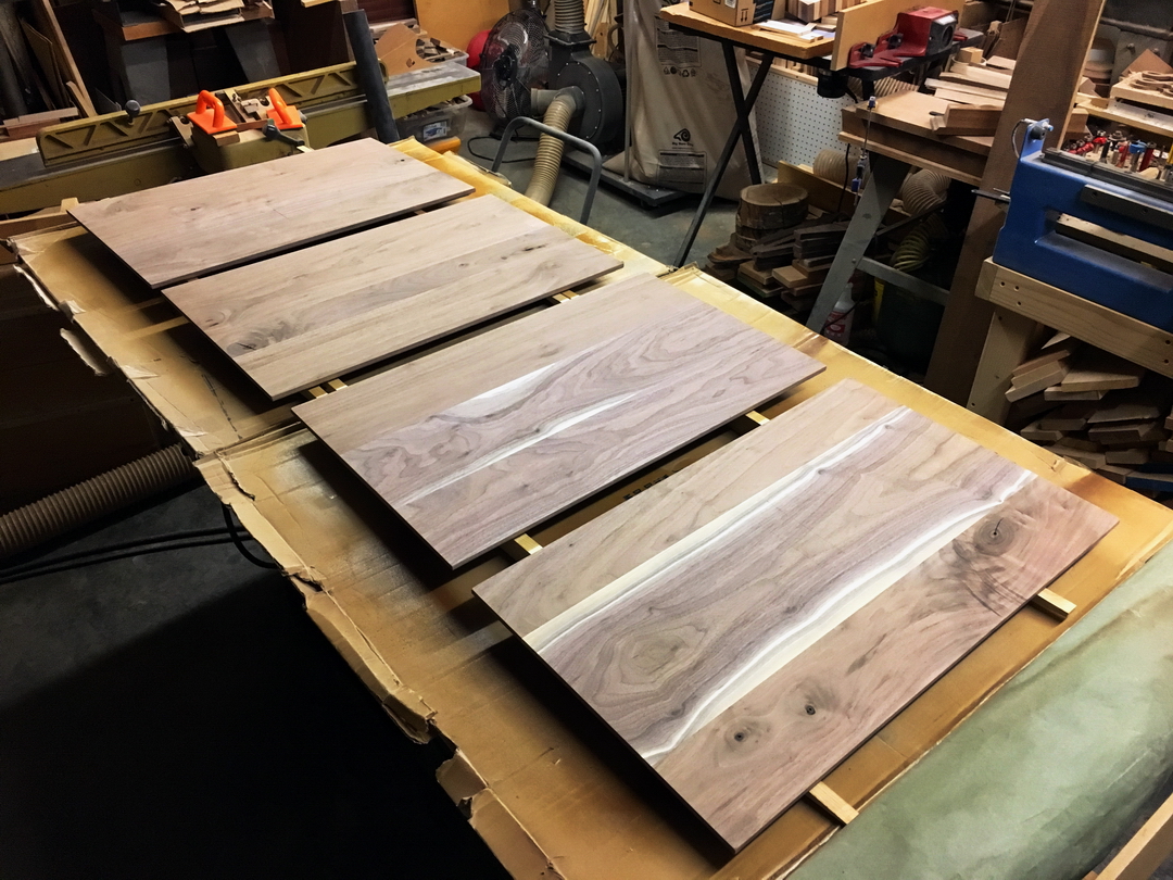

September 14, 20179 yr Popular Post comment_124631 I actually need to make 20 of these but will do 5 each week until I get them finished. I simply don't have room to store enough lumber, to clamp them all, and to finish them to do all at the same time. The finished size will be 28" x 17" so they're basically like an end table top. They'll get a Roman Ogee edge treatment and finished in clear gloss Nitrocellulose lacquer. There will be channels screwed to the front side so engraved name plates can be interchanged. The good part of that is if there's a slight blemish with a knot hole or crack it won't show so I won't have to spend much time fixing those. The bad thing is that this beautiful Walnut will be mostly covered with plastic name plates. Anyway, this isn't any special technique or job, just gluing up boards and then trimming to size and spraying finish on. But, all 5 are glued up, I'm waiting on my wife to get home, I have supper warming, and there's not a lot I can do right now in the shop so I figured I'd post some photos. Cut to length and width, still in the rough - Surfaced (I really wish I had an 18" or 20" helical head planer! - this takes a while with a lunchbox planer) - Gluing - All 5 glued and drying - Enjoy! David Edited December 5, 20178 yr by Ron Dudelston tags added Report

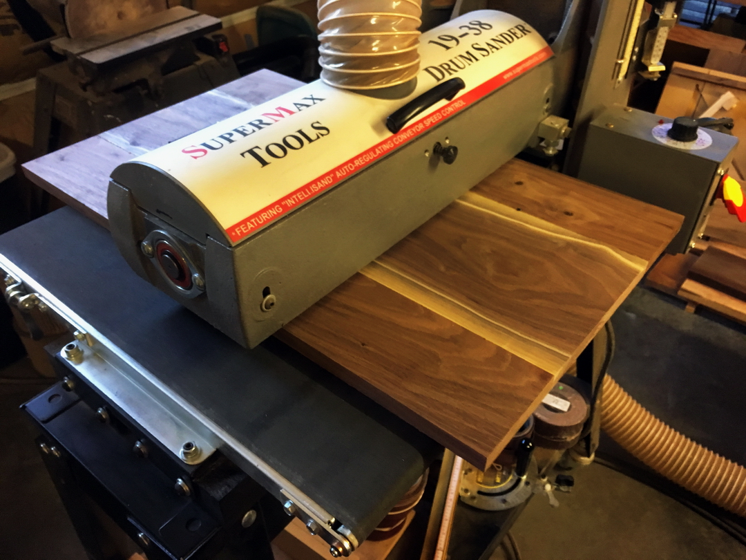

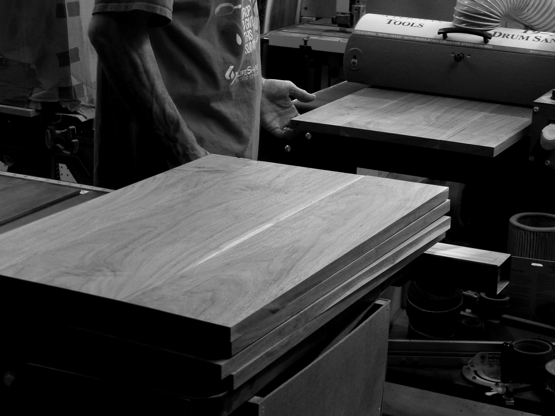

September 15, 20179 yr Author comment_124751 The guitar tops and backs I'm working with are about 16" across so when it was time to buy a drum sander we got the SuperMax 19-38. That way a back or top that was slightly wider than 16" would have no issues in sanding. Now I'm really glad we did that because the boards are 18" right now (I'll trim them to 17" soon). It definitely uses most of the drum to sand these. Here's one board going through - And the obligatory 'artsy' shot - David Report

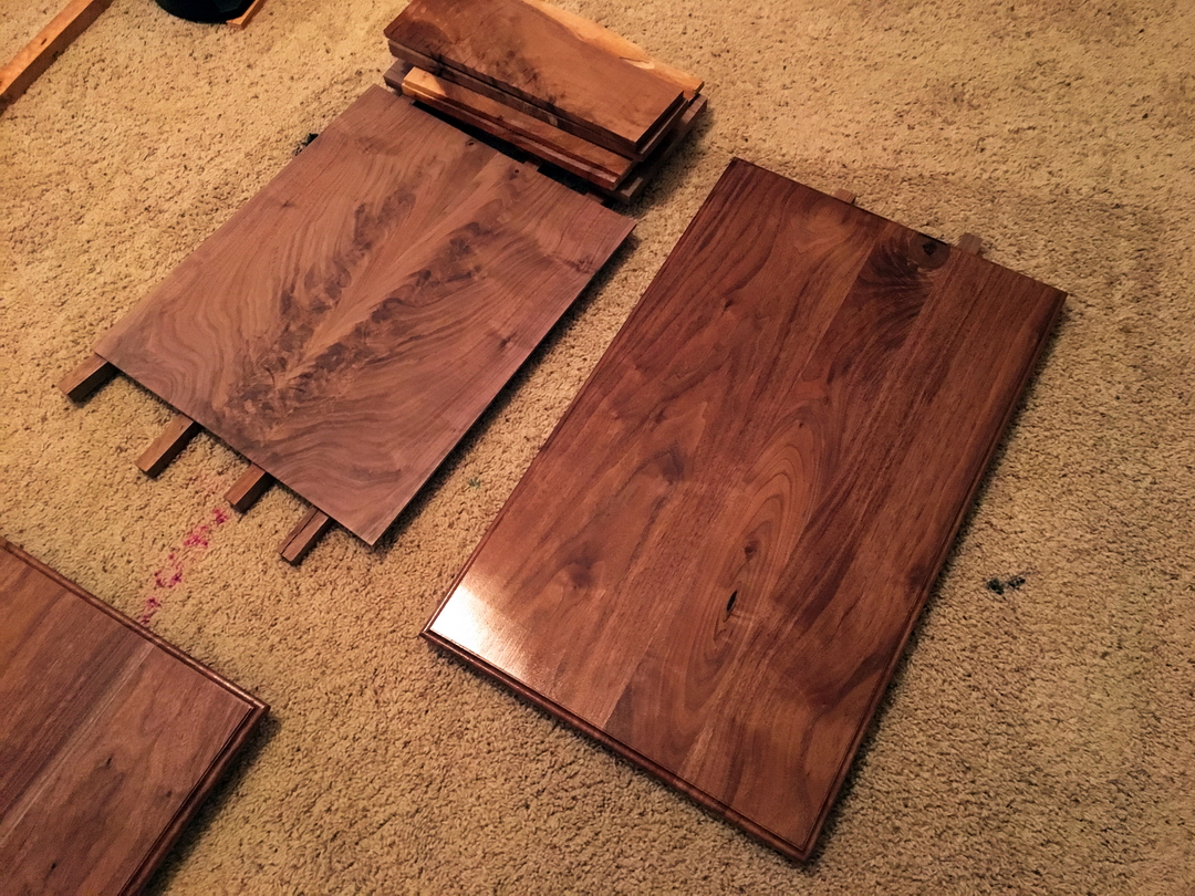

September 19, 20179 yr Author comment_125213 One coat of sealer, one coat of gloss. I think they look nice. Might do this again sometime and make some end tables - all these need are aprons and legs! The figure isn't that pronounced in real life, I think it's the lighting and camera that accentuate the look. It's there, just not quite so dominant. I'll deliver these tomorrow and then start on the next four or five. Enjoy! David Report
September 19, 20179 yr comment_125218 40 minutes ago, difalkner said: I think they look nice. Nice No...Gorgeous YES! Those certainly would have made beautiful table tops, panels in doors and the list could go on & on! Thanks David! Report
September 19, 20179 yr Author comment_125222 I wasn't satisfied with the photo so I took a couple more and these are closer to what they look like in person. The first one is under natural and fluorescent lighting and the second is incandescent. They are somewhere in between the two but not quite as red as the incandescent shows. David Report
September 19, 20179 yr comment_125224 They still look VERY VERY good to me! Goodness, what are your plans for that book match panel in the second picture? You are going to show us aren't you? Report
September 19, 20179 yr Author comment_125226 Thanks, Dave! Yes, posted that a couple of days ago - Found a nugget David Report
