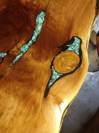

September 13, 20179 yr comment_124428 They epoxy and Turquoise is my go to for the sort of stuff I make. Sometimes, Just colored epoxy. Timbermate is a good brand of putty, too. It can be mixed to alter the color. I'm still experimenting with coloring Bondo. I'll get there....maybe. But, just as a filler and stabilizer, it's great. Used it in a resto project on a Baby Grand that had been severely abused by students. An auto body guy had invaluable info. Ended up using his recommendations for the brands and application methods for the black lacquer, too. Turned out great. Edited September 13, 20179 yr by Gene Howe Report
