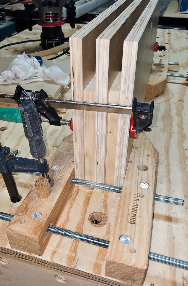

Popular Post MT Stringer Posted August 18, 2017 Popular Post Report Posted August 18, 2017 While building some cabinets for a kitchen remodel, I had to apply edge banding to several shelves. OK, it was 14 of them! I had seen a Woodsmith video where they demonstrated how to trim the edge with a router, so I tried it. That was easy and went fairly quick also. Basically, you do two or more shelves at a time. Put them on edge with a spacer in between. Then run a router with a flush trim bit along the edges. Zoom, zoom! I think the pictures tell the story better than I can describe it. The wooden hand clamps worked very well to stabilize the whole thing. Well, I might have used a couple more clamps to keep everything stable. Grandpadave52, Fred W. Hargis Jr, HARO50 and 5 others 7 1 Quote

MT Stringer Posted August 18, 2017 Author Report Posted August 18, 2017 I forgot to mention the reasoning behind this method is to provide support for the router as it is moved along the edge. That helps prevent tipping on the narrow (3/4 inch) edge. Works as advertised, I might add. Grandpadave52 1 Quote
Chips N Dust Posted August 18, 2017 Report Posted August 18, 2017 Thanks for the tip! I'll bet if you could get a big enough clamp for the base, you could do about 5 or 6 at one time. Quote
MT Stringer Posted August 18, 2017 Author Report Posted August 18, 2017 57 minutes ago, Chips N Dust said: Thanks for the tip! I'll bet if you could get a big enough clamp for the base, you could do about 5 or 6 at one time. May have to try it with a couple of Besseys Chips N Dust 1 Quote
Grandpadave52 Posted August 19, 2017 Report Posted August 19, 2017 Hey Thanks Mike...Great idea...BTW like your idea of holes drilled into your wood clamps to engage in a bench dog & hole. Clever...Two great tips. MT Stringer and HARO50 2 Quote
