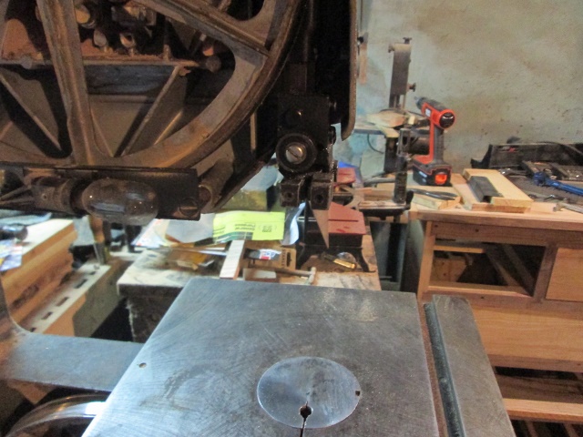

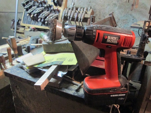

August 13, 20179 yr comment_120393 The old Craftsman let me down tonight.. Motor stalled out....even under NO LOAD!..... Motor is a double-ended one, has a plastic cover over the un-used shaft.....always filled up with dirt...got rid of that. Thrust bearings were worked over....since I was tearing the saw down, anyway Yep, nasty looking. There IS a trash bag back there...will be full tomorrow...Drive wheel lost the tire a while back... Might as well install these, as well. IF I hand spin the drive wheel to start the saw up......it will run at normal speed....if I don't, it barely turns, and hums.....air compressor Sunday to blow out the motor...hoping it is just dirty contacts... Grabbed an old file, once I had the drive wheel spinning..and cleaned the crud off the surface.....a bit of vibration in the system....Did a little "balancing" with the file, taking out most of the wobbles.. even on this little pulley.. Acts like there is too much tension going on...yet the belt does flop around a bit.... This thing was frozen in place....hammerdrill and PBlaster to even move the bolt....bearing was stuck....wasn't in the mood for "Stuck" Visegrips to hold the center ring...wire wheel and normal wheel on the grinder to get it spinning again..freely. repeat with the upper one.. Gave up for the night. Need to boil some water Sunday, and get the tires to STRETCH enough to go on the lower wheel...wonder IF I should change out the upper tire... Looks like Sunday has been planned out.... Was trying to rip two drawer sides to width......didn't happen. Report

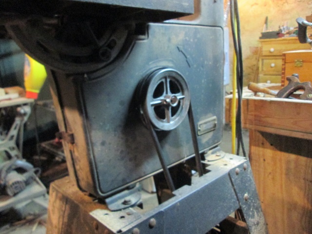

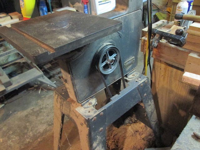

August 14, 20179 yr Author comment_120520 Update: tire is on. New blade, too. I now have a "starter" for the saw.. Junky old wire cup. drill is set in reverse. I place the cup over a pulley.. And spin this up to speed....then turn the motor on....saw runs fine. then. Acts like there is a bind going on that shaft.....hard to turn. No wobble, either. Have no idea IF there is a way to lube any bearings in there... Report

August 14, 20179 yr Author comment_120611 As soon as I find out what size Starting Capacitor the motor needs...I will see about replacing it. Need to find enough time, and a few extra hands, to do the replacement.. Report

August 14, 20179 yr Author comment_120635 There is the "box" for the capacitor......doen't look burnt up, no paint has peeled from heat. Maybe after I get these drawers made..I can dig around and replace it.... Report

August 19, 20179 yr Author Popular Post comment_121370 Update: Seems the bandsaw got tired of being "Jump-started" each time it took less spins to got it moving...yesterday..I flipped the switch on, without doing the helper...saw started right up! Has been working fine ever since....must have done something right? Will see how long this lasts.....fixed, for now. Report
