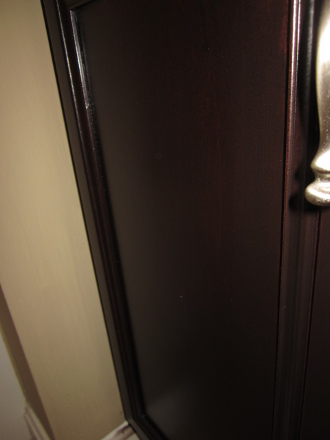

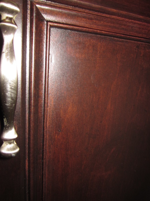

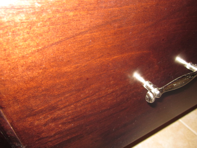

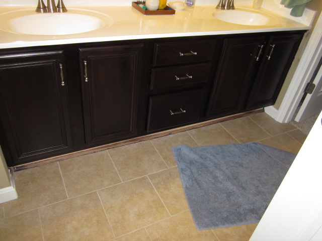

August 26, 20179 yr Author comment_122335 Got it back together today. Still need to do the kick plate and shoe molding, but I'm just going to paint it black. You can see in one of the photos, although in ambient light it looks very black, there is a red undertone that you can see more clearly when you flood with a flash. Report
