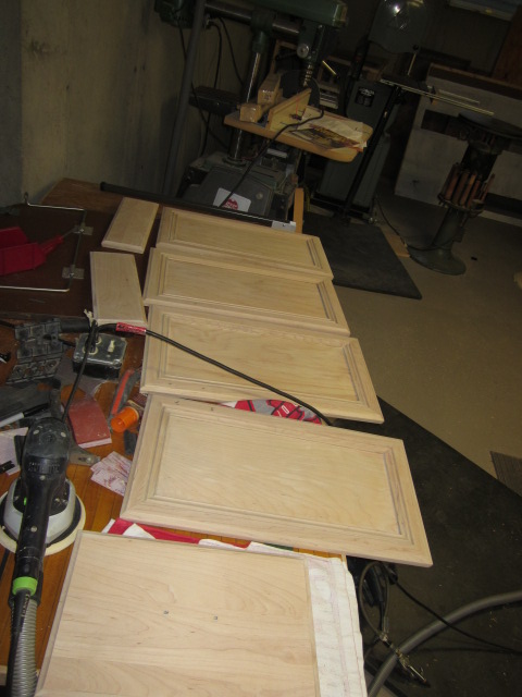

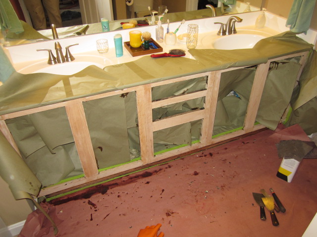

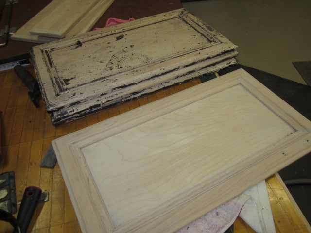

August 11, 20179 yr Popular Post comment_120214 Given your wood costs, equipment, time, and if something with doors or drawers, hardware, the finish is often the least expensive component of a project. In the house we bought last year, DPO (dreaded prior owners) painted the MBR bath cabinets. About the first time we used it, the black paint chipped off behind the drawer pull. Roughly 18 months later, the finish is still soft and sticky. Probably bought the cheapest paint they could find. So time to do something about it. Plan was to strip and refinish. Trial showed black paint came off OK, but white factory finish underneath a bit more stubborn. I normally use NMP strippers, but went out and bought some industrial duty methylene chloride and got started today. Well, the black came off, sort of, but left a lot of sticky rubbery residue. So the cheap paint did not even strip well, one of the worst I've ever had. Getting to the face frame, I went back with NMP since it needed to be done inside. Let it sit for a couple of hours and it came off reasonably well, even the white underneath. While the NMP was working, I cleaned up one of the doors. Lots of work. I think I'll give them all another run with NMP. I'll keep you posted on progress during the project. I initially thought I'd just make new doors and drawer fronts. Still an option. Report
August 11, 20179 yr comment_120217 In the pics, it looks like it cleaned up pretty good. Lotta work, as you said. Report

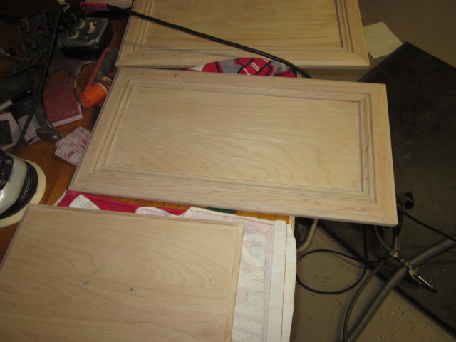

August 12, 20179 yr comment_120324 The doors look pickled or is that a strip still in progress. Report
August 13, 20179 yr Author comment_120506 On 8/12/2017 at 10:57 AM, Gerald said: The doors look pickled or is that a strip still in progress. The undercoat was a white opaque finish. It came off pretty well on the face frame, so I'm going to strip the doors again tomorrow. It was not that obvious until I took the flash photos. Would have shown up in the staining. Report

August 13, 20179 yr comment_120515 I would have to be "pickled " to attempt that. The fumes from that stripper are not funny,only make you funny. Your doing a good job,Kieth, the wood under neath is good looking shame it had to be painted. Herb Report
August 15, 20179 yr Author comment_120848 Well, did the second round of stripper, rinsed with scotch-brite & acetone, and sanded with 120, then 150. Edges got a light hit with a block plane. Almost ready for the finish when I get the face frame sanded and a half-wall top re-made. Still not sure I would not have been ahead just to make new doors. Report
August 15, 20179 yr comment_120870 Naw, those look like they will be nice looking doors...with the right finish, that is... Besides, the worst is now over with... Report
August 15, 20179 yr comment_120872 9 minutes ago, schnewj said: Naw, those look like they will be nice looking doors...with the right finish, that is... Besides, the worst is now over with... What he said. Great Job, Keith! Report
